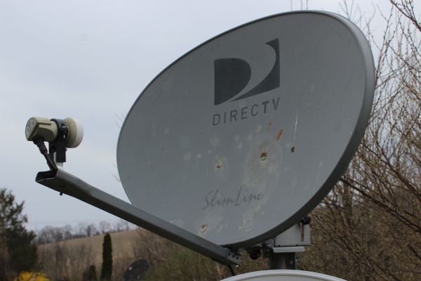

I have a slimline dish as well I want to try with 97W I was going to get LINEAR DUAL LNB FSS SATELLITE LNBF FOR VIEWSAT PANSAT | eBay since its designed for the slimline dish but maybe I'll just get the Maverick instead
When I modded my old Slimline to use as an Orby dish I used a universal lnbf mount.
The lnbf you mentioned may work fine as well. I have one myself here at the house but have never tried it. :rolleyes
Needs painted! ;)
