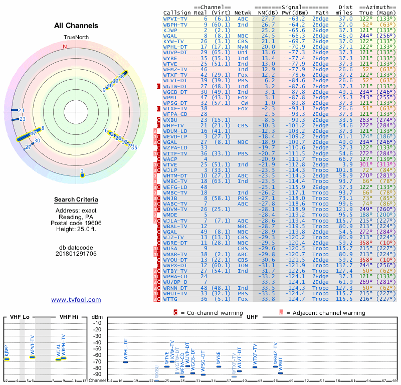

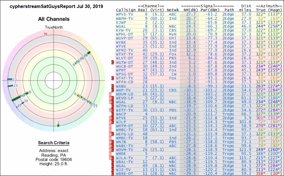

I'm attaching the radar output from tvfool. I'm really looking to get a more stable picture and one that may hold up in the weather so if the satellite signal is lost from snow or rain, we can still use OTA. I'd prefer to attic mount the antenna, and I know its just regular house wrap and plywood up in the triangular shaped attic space, as opposed to the foam pads they put on the house prior to our replacement of aluminum siding with vinyl siding a few years ago. I would also consider splitting this two ways, one into an SDR just for fun and to see what kind of signals I can find out there.

3,8,10,17,29,35,39,60,65,69 all come in (with 3 being the hardest, post repack). I should check tvfool if they updated the power and frequencies. The shifts just happened yesterday so I'm not sure how fast they update the database.
TVFool stopped being updated more than a year ago. Use the new RabbitEars search map.

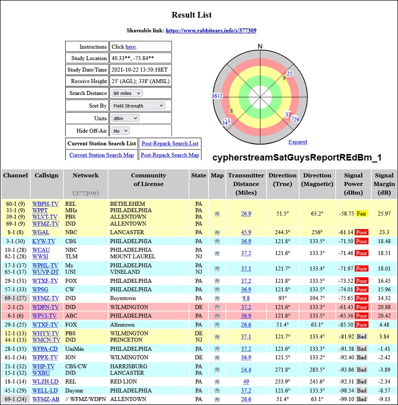

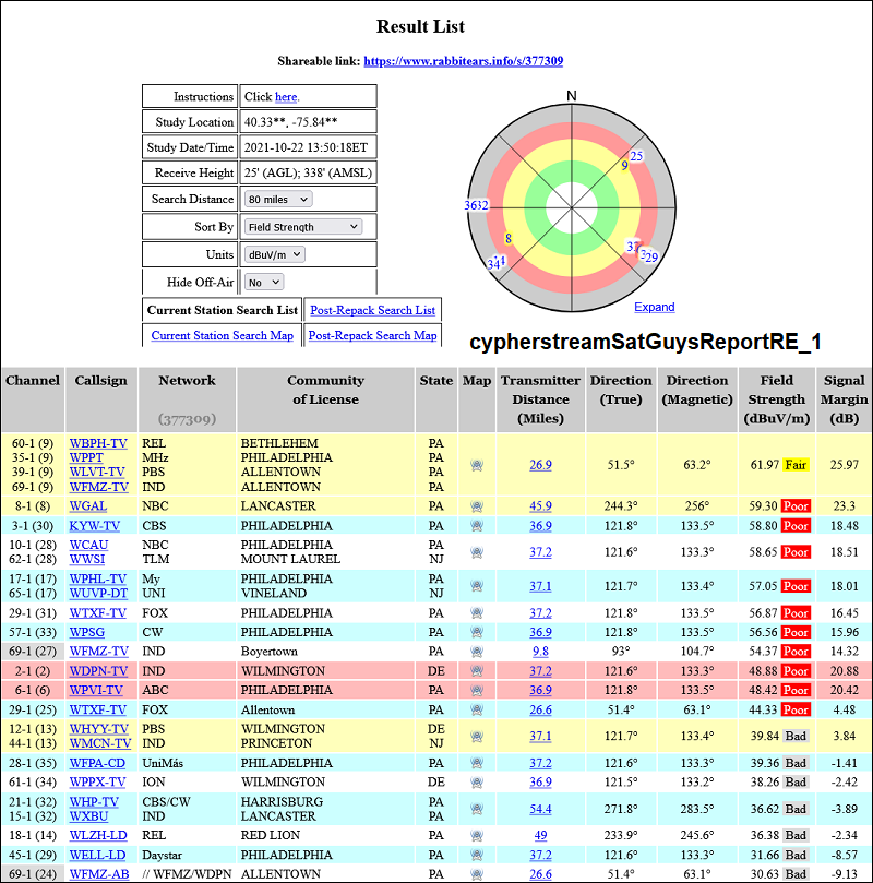

Your report image:
This is a rabbitears.info report based on your TVFool report:
RabbitEars.Info
The report comes up with signal strength stated in dBuV/m
but you can change the units to dBm to make it more like a TVFool report:
RabbitEars.Info
The Signal Margin on a rabbitears report is similar to the Noise Margin on a TVFool report.
You can add antenna gain to either one. You can also add antenna gain to the dBm on either report.
The VHF-Hi and VHF-Lo signal strengths on a rabbitears report have a negative correction factor added to allow for the higher noise levels on those bands. This causes therm to rank lower in a report.

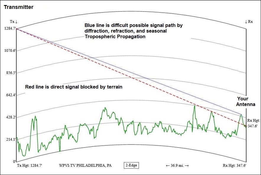

There is a hill in the signal path for WPVI and other channels in the same direction:
