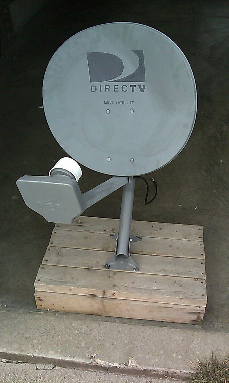

I have a smaller 3lnb dish (101/110/119) and put a slimline3 LNB on it. It gets 101 in the high 80's, and 99/103 in the mid-70s with minimal tuning. Have it down to about 5 minutes to setup after some practice.
I know many other people here have used this type of setup for tailgating or camping.
On a side note I kept forgetting the BBC, since my athome config is SWM and my road config is not.
I got mad and decided to put the BBC permenantly in the LNB arm. Needless to say it was slightly too big.
I spend a half hour lightly tapping it (and at times more than lightly) with a hammer and some pliers, eventaully got it in and happily it still worked.
