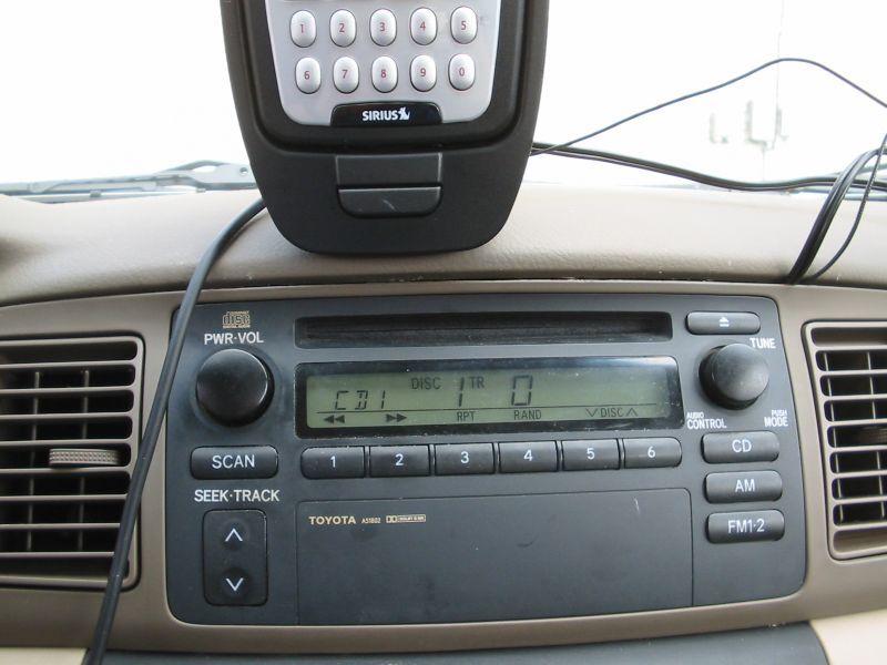

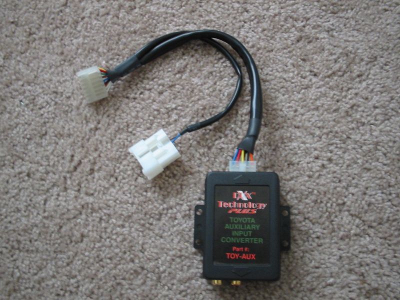

Well, I just ordered the aux input adapter for my car. I still have the factory radio in my 2003 Corolla. The one I ordered is from P.I.E.
Has anyone else used this product for their vehicle? I'm getting it so I can directly connect my Sirius PnP to my car radio. I'm getting tired of the FM Modulation and I want it to sound better too. :)
I have the PIE GM-AUX 9 in my Avalanche and it works great. I use it to send the output of my XMCommander directly to the aux jack of my factory HU. It sound 10 times better than the commanders built in FM Modulator.

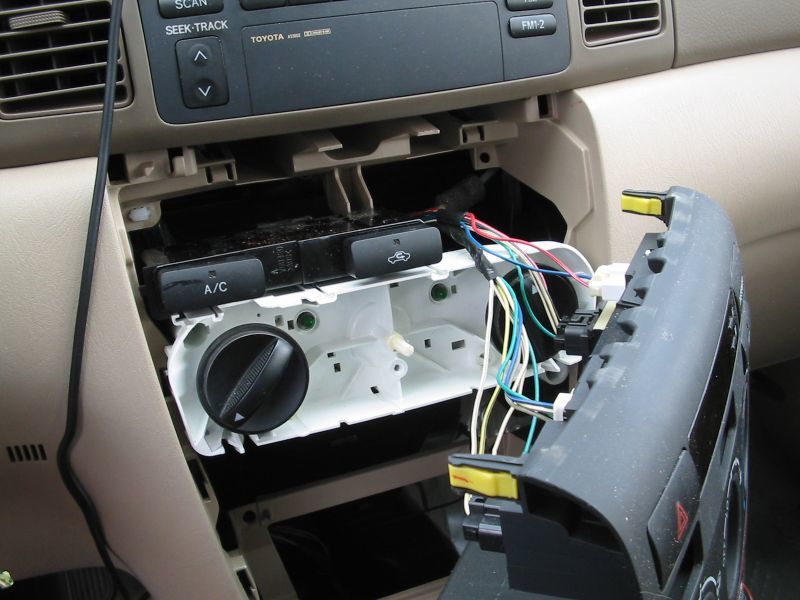

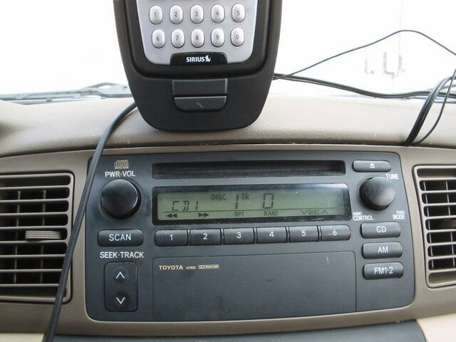

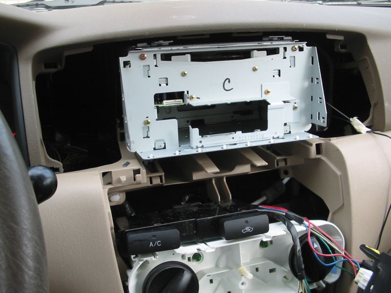

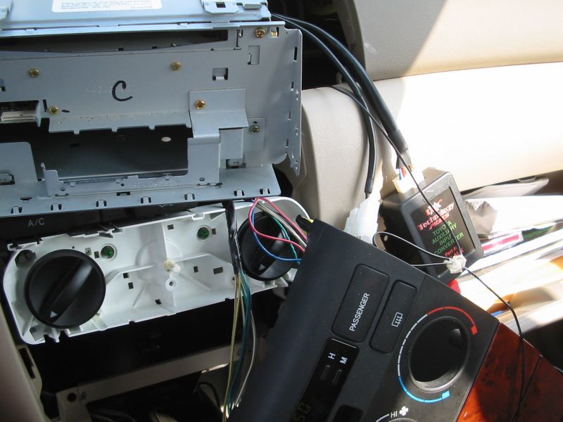

I got it installed today. I will have pics soon. I had to take the center part of my dash completely apart to do this. Sounds NICE!!
OKay, I have the pics of my aux adapter install. Took me about an hour total to do this.

Well, the aux input adapter turns your CD changer port on the back of the factory radio into an aux input. You then hook an RCA to headphone cable from the aux input to the audio out port on the back of the car kit. Then you turn off FM modulation in the menu.
