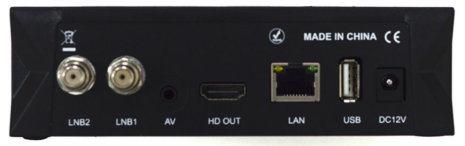

Axas HIS Twin, DVB-S2 Twin tuner Enigna 2 receiver, Wifi on board. Linux, Led Display.
DVB-S/S2 MPEG2 / MPEG 4 - H264 / H265 HEVC Compliant
Support full HD 720p , 1080i , 1080p
DiseqC 1.0/1.1/1.2/1.3(USALS) Supported
Aspect Ration 16:9 or 4:3
CVBS/RGB/HD output Supported
2x USB High Speed port
USB 2.0 for PVR , Timeshift, SW update, Multimedia Playback
OS Linux, Hisilicon 3716/IV410 , 512MB DDR Memory , 256MB Flash Memory
2x DVB S2 input
1x RJ45
1x HDMI
1x Wifi on board
2x USB 2.0
1x AV
1x DC 12V/2A

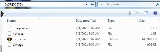

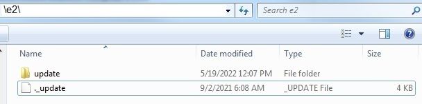

The USB drive should be formatted fat32.
The files should be uncompressed and copied to the flash drive and have a folder structure like : e2\update\
To access the image restore feature on the box, hold down the GREEN key when you power it on, or hold down the POWER button when you power it on.
I would like to mention that if you don't have a detectable USB drive, you will NEVER see the 'Updt' : Update text on the Axas front screen. So, if you can't get the Update on the frong panel, try another USB flash drive. If your seeing the 'Updt' on the screen but it doesn't appear to work, or reboots quickly, then your files are not correctly placed in the right folder structure.
Once you back-up your own image, you could then restore directly to that, should you brick the unit in the future. I made a image backup and it made a .zip file that has the same files that were found in the update folder of the raw image.
