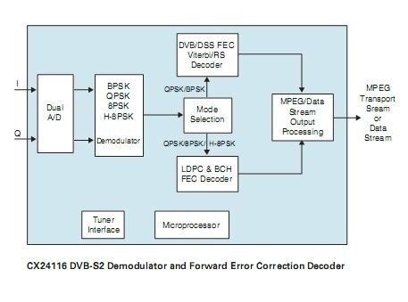

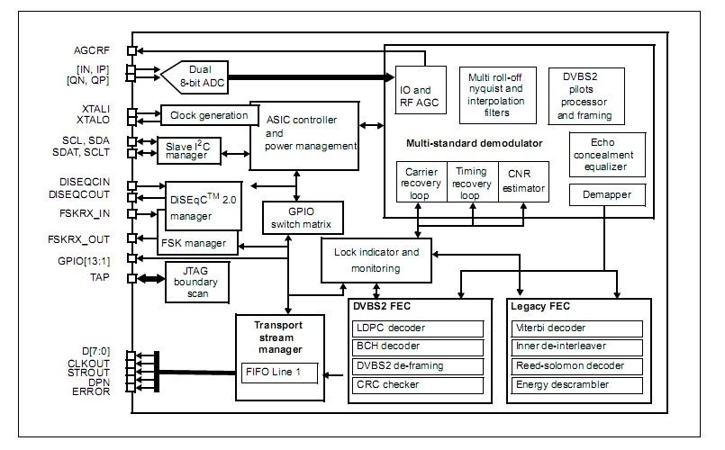

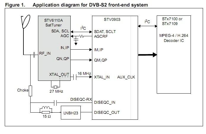

What I'm saying is that newer STB Frontends have blindscan circuitry integrated and controlled by their own microprocessor instead of being controlled by the STB's remotely located and busy main processor. Blindscan routing uses efficient adaptive search technique, and the circuitry is designed to execute it fast. To work, the blindscan instructions must be called from the tuner's driver, and supported in the STB's firmware, so you can see these options on screen. Compare it to a 3d party "coders" SW solution only to realize, its far from perfect. :)
The attached pics show that a Sat STB device frontend is comprised of Tuner, Demodulator and TS Stream Decoder. Newer demods like STMicro STV0903 have blindscan loop integrated, and older like Connexant CX24116 don't. Firmware coders still have to know and be motivated to tell the STB how to use these integrated capabilities. Sometimes they add frequently requested features to STB's User Interface to show the end user "work in progress" for marketing reasons, despite they know it can't be satisfactory done by current hardware, and no extra code is included to support these moniker features. It allows to sell a lot more under developed units playing on consumer's future expectations. ;) Which turns to be a good thing for some startups like OpenSat, allowing to earn enough money to hire some coders and gradually improve firmware. They are still dependent on the actual STB manufacturer for required hardware upgrades.

Of course the AZ HD Premium and HD Elite both have CX24116 demods.
