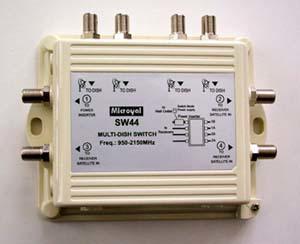

Hopefully haven't caused to much confusion..To the op ...You should have an external switch somewhere between the receiver and lnb.
Below is a picture of an Sw44
