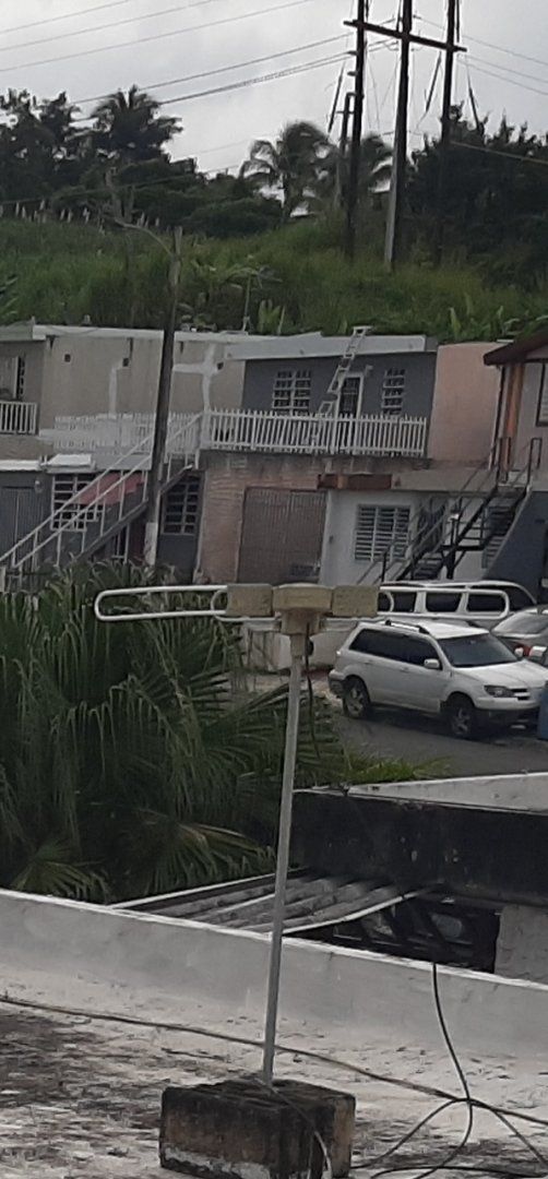

I live in the same place.
And I get around 30 OTA Channels
ABC From Wora
And NBC from telemundo
I live 28th street its only on the roof I have it like 6 feet.
I have it pointed to Aguas Buenas
My OTA at my roof

Ill let them know. Would you be willing to install one for them for a price? They are on their 70's and don't know much about technology. You are like a minute from their house.
Do they have a ladder in their house?
So i can verify if they have a clear view on their roof?
I will let you know what day I can look.
