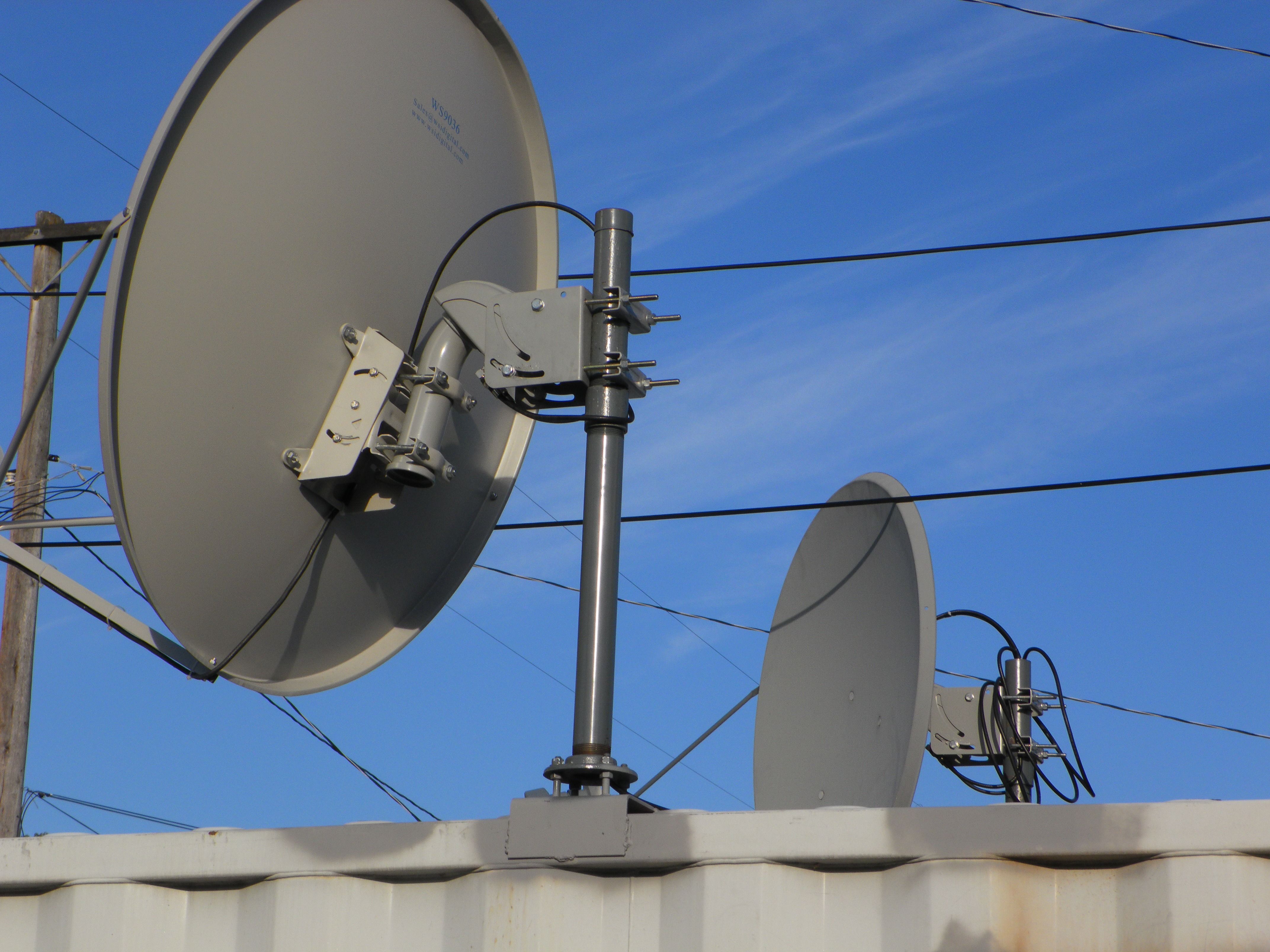

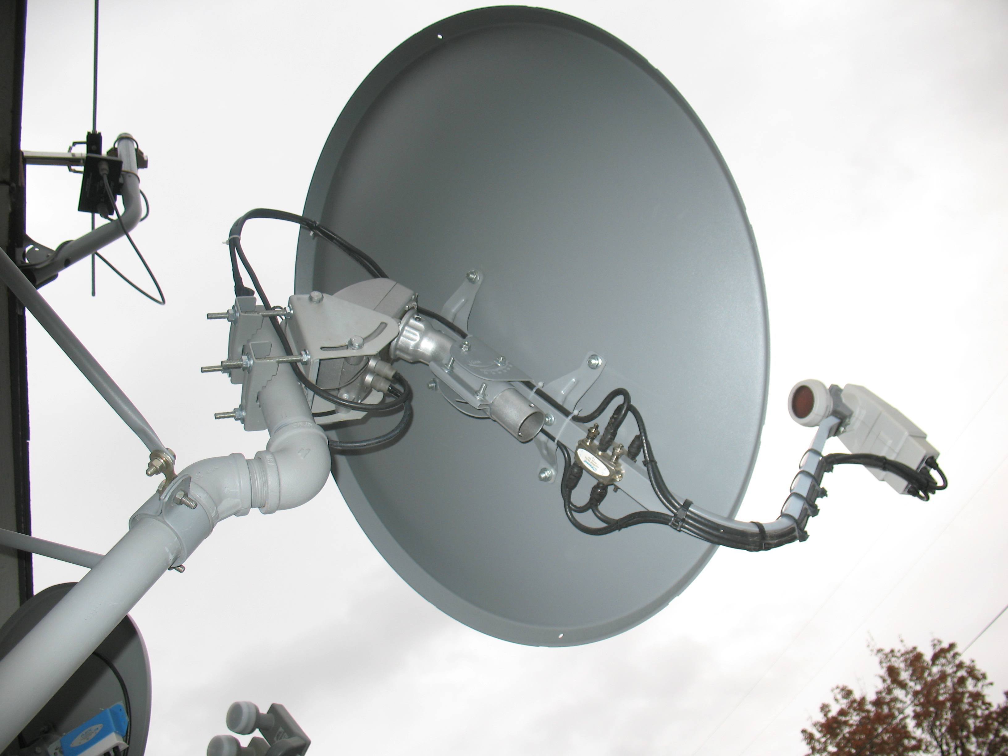

I used a Dish wall mount for my first motor (SG2100). That mount was for a SuperDish wich is larger than say a Dish500. I found the perfect material for making my own mount and that's 1-1/2" pipe. With all the different fittings and flanges you can design a perfect pole for each situation

I tried the same thing on a prior 18" dish roof mount but the mast height was too short to give clearance for my 36". The simple change was to keep the foot so I didn't have to do work on the roof (no need for more holes) and just changed out the vertical mast tube for the longer one that came with my 36" fortec dish. A vertical tube is a vertical tube. The foot part fastened to the roof seems to be pretty universal so it was a 5 minute swap for the the two bolts, bolts I had to loosen and tighten anyway to fine tune for vertical once the heavier weight was on the mast. My sg2100 slid right on to the DN diameter sized mast and clamped down with no issues.
