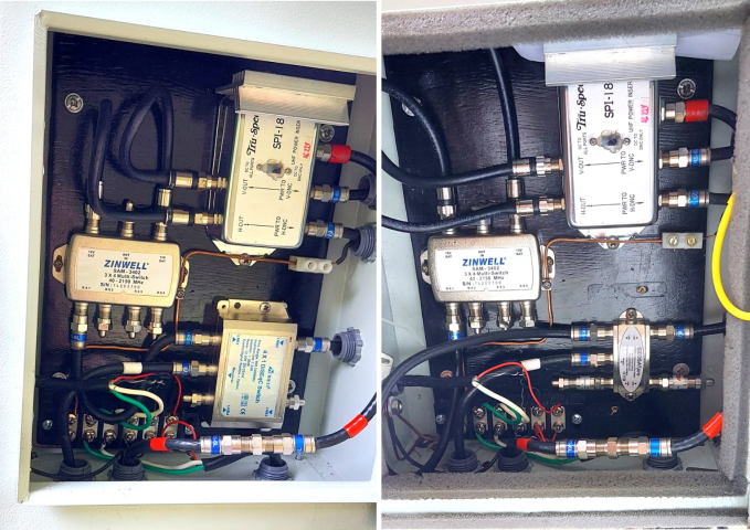

Hi guys. You might have already seen my cabinet in the past. The Chieta 4X1 in the left panel only lasted a half year or so. But everyone said it was the one to get. And I did. The left pane was when everything was being finalized.
The right pane is how it is today after you made me go out in the cold to snap the pic.
Anyway. Ignore the terminators on the Chieta 4X1.
At first, coming from a Geosatpro 8X1 that got fried and cooked a lot of stuff here. Took me a bit to find out the Chieta was a diseqc 1.0. And after getting everything playing nice inside. It was slow. I mean slow.
Switching between my ku lnbf to the ortho setup. Sometimes several seconds lapsed.
Suggestion was to add terminators to the unused floating ports. I got jumped all over by folks because of the possibility of activating the unused ports and causing a 13/18 Volt short. But the switch was "a touch" faster. Fine.
A call to Satellite Dish tech support. Good dudes BTW really. Suggested after making a call to a commercial customer. To try using DC blocks before the terminators. And it stayed that way. Worked good.
Until one day something went South. I couldn't get any channels on C or ku. The Chieta 4X1 died.
In the right pane there is the Geosatpro 4X1 that I got from Ricks. I actually bought two. One for a backup.
It was a little slow. Same diseqc 1.0 protocol. When I added the DC blocks and terminators it got snappy-fast.
So there you have it.
The only thing drawing current off of my osmio4k are the 4X1, multiswitch, and Geosatpro ku lnbf.
The Norsat's are powered through the bias-tee (Tru-Spec) over coax and that gets juice from a 18 Volt laptop power supply. The mio runs warm. Not hot-ish like before.
I've opened up the Chieta to see if there was a fix. Because that's what I like to do. The Geosatpro 8X1 got opened up too. Not pretty. It was cooked. But the internal components are similar. So. Who is better? Don't know. It's all chinesuim with no-name manufacturer internal components that actually are probably stockpiled.
Just don't know. Ground it, bond it, pray. When a storm brews. Unhook it all. Lightning is a red head. And red hairs don't care.

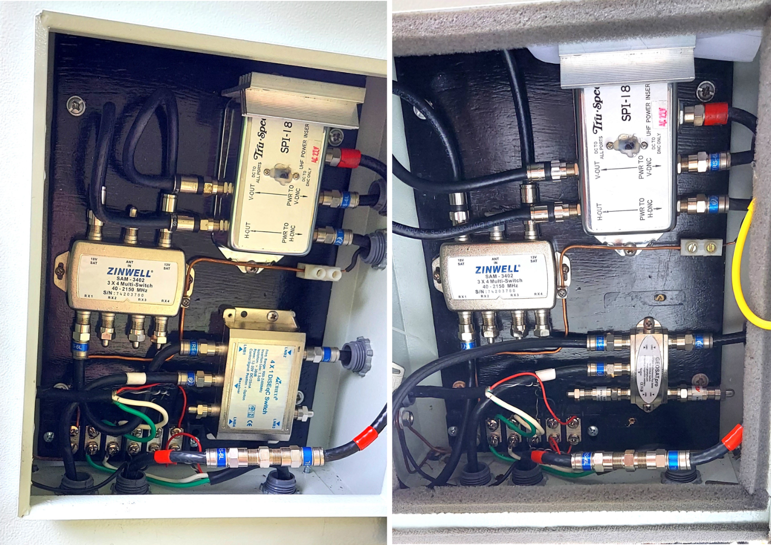

Suggestion was to add terminators to the unused floating ports. I got jumped all over by folks because of the possibility of activation the unused ports and causing a 13/18 Volt short. But the switch was "a touch" faster. Fine.
Until one day something went South. I couldn't get any cnannels on C or ku. The Chieta 4X1 died.
I've opened up the Chieta to see if there was a fix. Because that's what I like to do. The Geosatpro 8X1 got opened up to. Not pretty. It was cooked. But the internal components are similar. So. Who is better? Don't know. It's all chinesuim with no-name manufacturer internal components that actually are probably stockpiled.
Don't know. Ground it, bond it, pray. When a storm brews. Unhook it all. Lightning is a red head. And redhairs don't care.
Are those switch containers indoors or outdoors?
