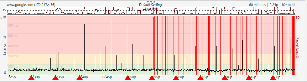

Here is pingplotter - started out fine for about 30 minutes, then the packet loss started and hasn't slowed down. With this packet loss, there is where everything slows down so noticeably, and sometimes it doesn't let me surf.

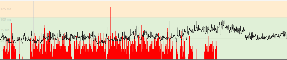

Scott Greczkowski - thank you for showing me this program! I have let it run for 48 hours, and you can see what it was over the weekend, then shortly after midnight this morning, all the packet loss stopped. Only 1 single line all day today with packet loss. Pings are every 2.5 seconds. I have no idea what happened - I am guessing that is 100% a T-Mobile thing as nothing has changed on my network setup at all.
