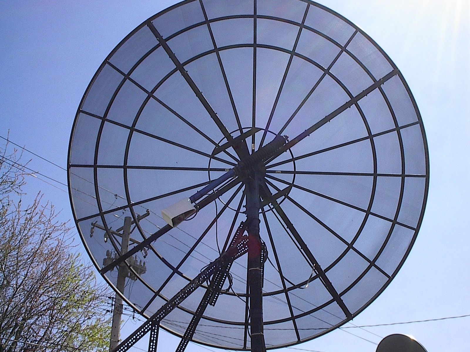

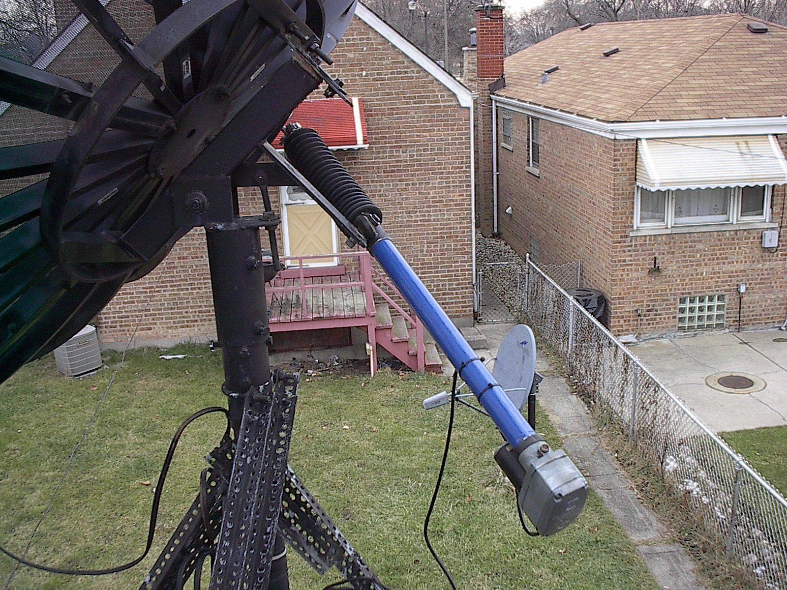

Here are a couple pictures of my rebuilt Saginaw now going on 20+ years. :D :up
It moves my 12 foot like butter.
