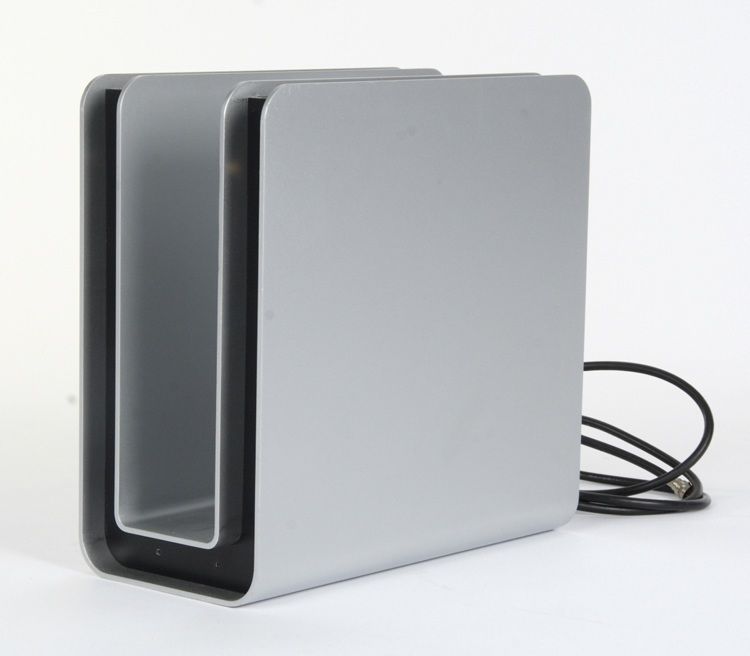

Antennas Direct will have on the market in July a new indoor antenna, the Micron, pictured below. It's small, powerful and cool looking. If you can wait, try it. They offer a no-fault 90 day gaurantee. If it doesn't do the job for you, return it for a full refund or try a DB-2 (indoor/outdoor) antenna.
Whoah! Me likey...
The Philips Silver Sensor and the TERK HDTVa/i are eyesores. This one has potential if it's good at reception.
