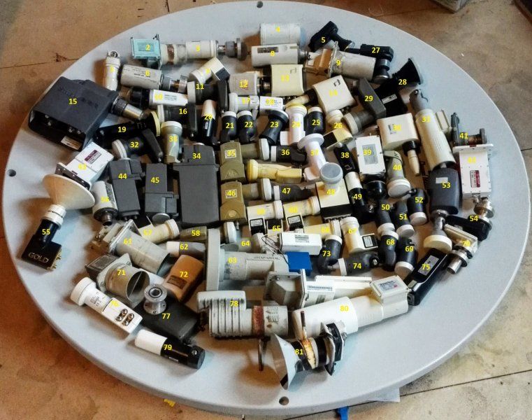

I gathered some of my LNBs/ LNBFs other day. So, dbshelton, if you have difficulties finding LNB, I can pick one (on my choice) and send you free of charge (you pay only shipment).
