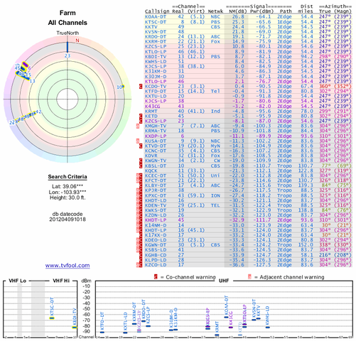

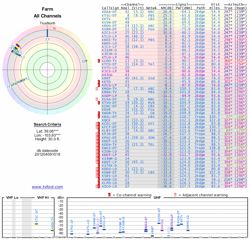

I'm using a Winegard YA1713 for VHF channels 7 - 13 and a Winegard HD9032 for UHF. This combination provides the highest antenna gains that I could find. The size and cost are a significantly lower than equivalent combo antennas and the performance is better. There are no lower VHF channels in my area, so 2 - 6 capability was not required.
Here is a picture
Use an AntennaCraft Y10-7-13 for VHF and an Antennas Direct 91XG for UHF. Combined them using an AntennaCraft 10G222 (dual input) pre-amp with a Channel Master CM9521A or Eagle Aspen ROTR100 rotor. Run a separate control wire if you use the Eagle Aspen. Use a high quality solid copper RG-6 (Belden 7915A) cable with high quality compression fittings. You will be a very happy person. Solid Signal usually has the best prices.
For Colorado Springs everything is on UHF except KTSC which is VHF-Hi. There is another PBS translator on UHF so you could go with just a UHF antenna like the 91XG in a fixed position. As far as Denver goes anything other than the PBS station would probably take extreme measures to have anything consistent.
I did notice that at about 50 feet most of the Colorado Springs stations become LOS so try to get your antenna as high as you can.
