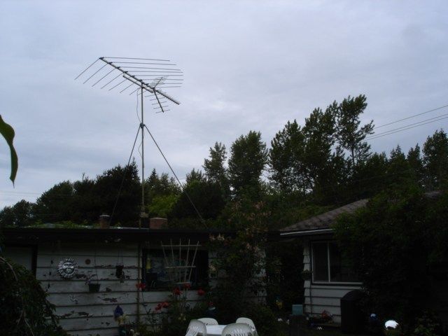

Trying to pull in Vancouver BC signals approximately 60-70 miles away. Presently have a roof mounted Radio Shack antenna VU-120 XR VHF/UHF/FM with matching transformer (?) with apx. 40-50' cable 18AWG run to the set. Receiving a signal of 65-72 on one channel broadcasting at 4.3 kilowatts. Another channel operating at .319 kilowatts because of a conflict with a Seattle station -- I have a signal of 35 (no picture/sound) with blips to 54 about once a minute for a second. Another forum member a half-mile from me (on top of a hill) is receiving that station perfectly with rabbit ears :(
Other than moving to the top of the hill, would a different cable RG-6 or RG-111U or a mast-mounted pre-amp boost the signal I'm receiving.
Any assistance would be appreciated.
Much thanks.
