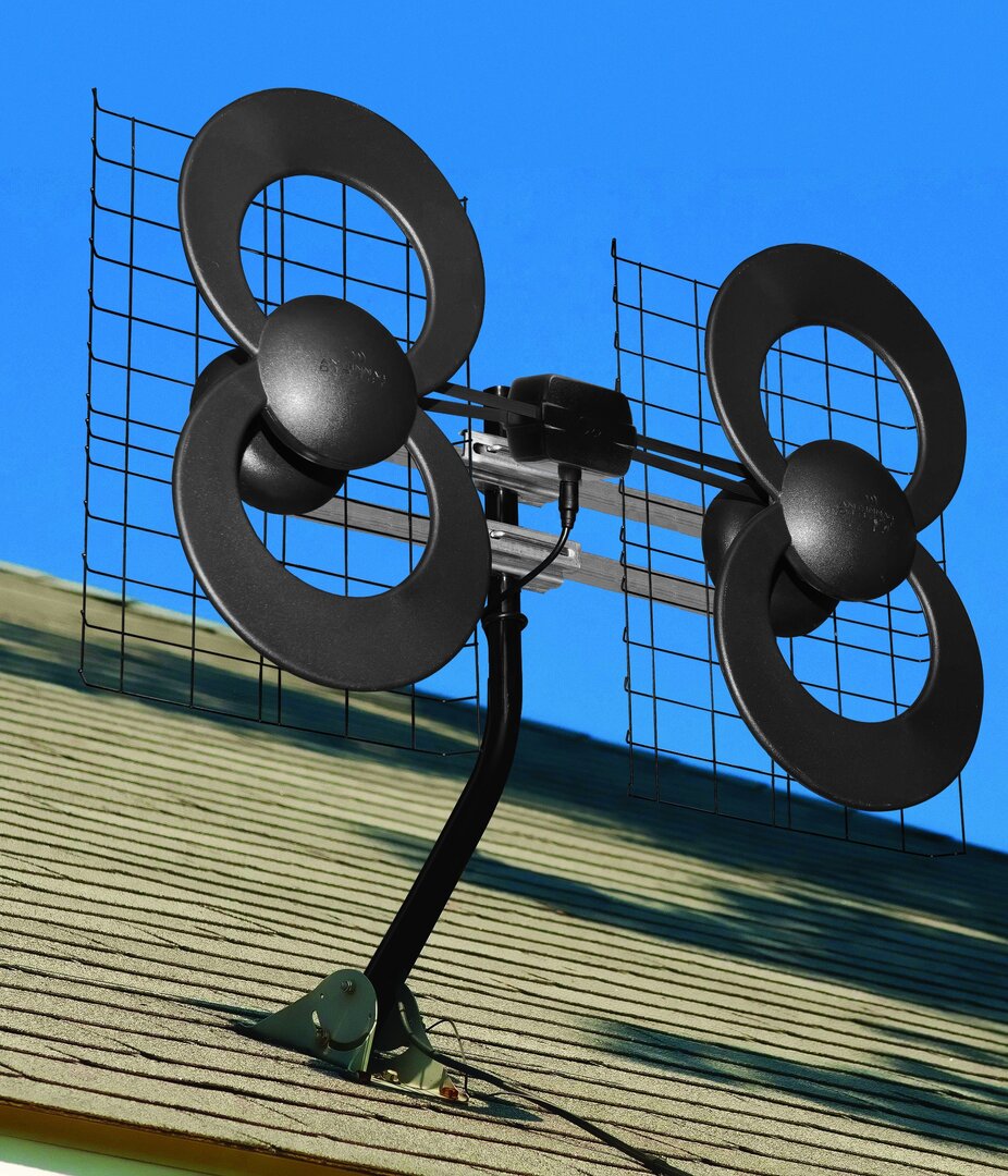

This will be the antenna I will be using,Conneautville is in a low spot in Crawford county. Cable was installed early on cause reception was always bad here from Erie
I was given one of these from a guy selling and moving out of his house. It's ok, but it's not the best by any means. I wouldn't pay to buy one for the price they go for.
