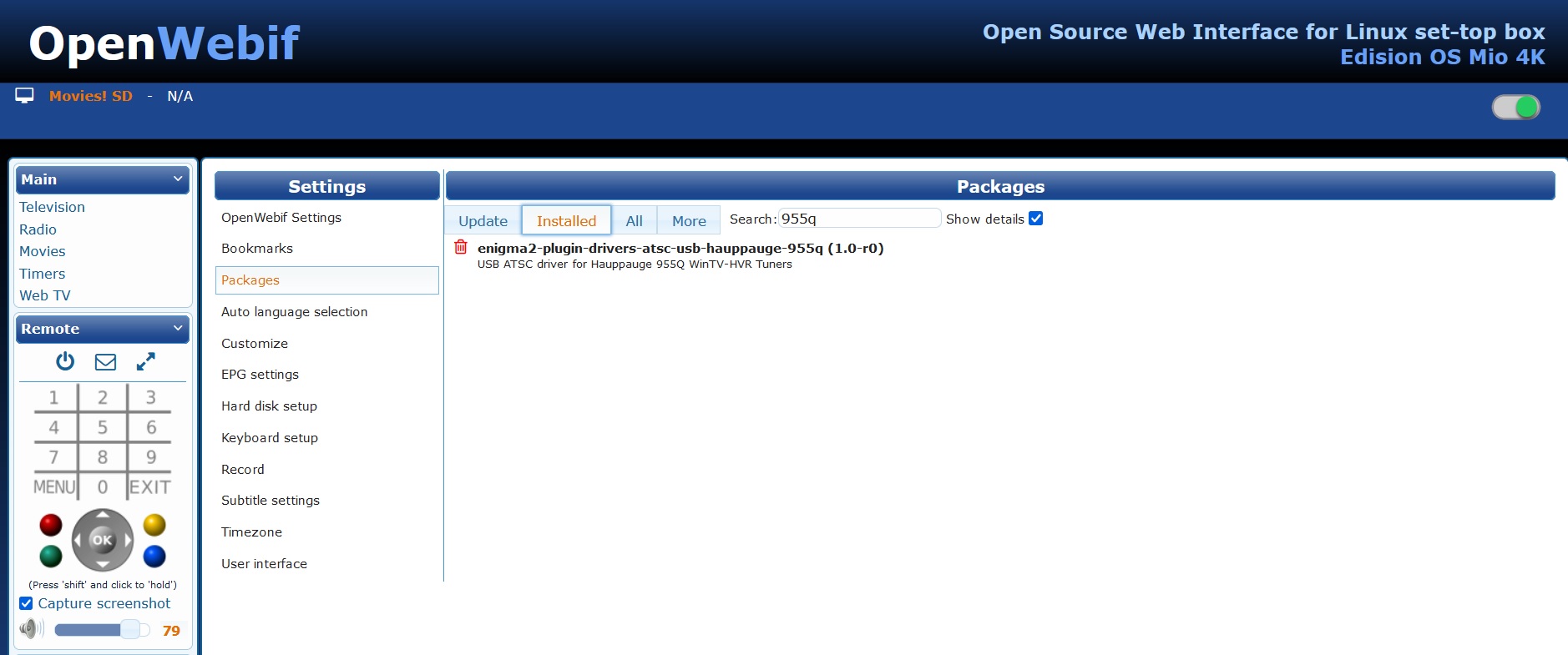

Well, I and others ARE using the 955q, and it works perfectly. There's a driver built into the image specifically for it. So, your generic Linux quote is WRONG.

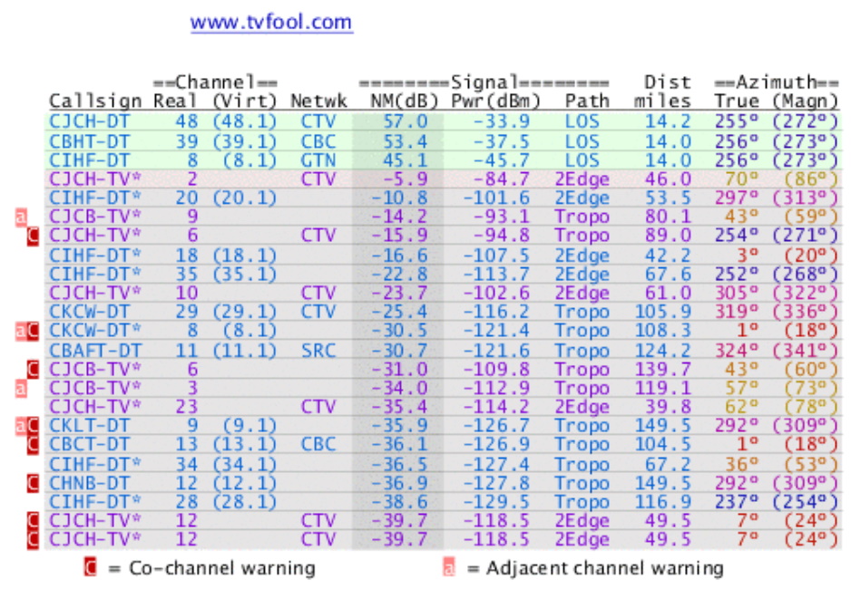

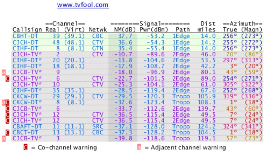

My 3 local HD OTA are 31.3 dB (CBC), 31.4 dB (CTV) and 30.7 dB (Global) at this moment from my CM-7777 preamp and Clearstream 2 antenna 10 feet high. At the very best, if I can receive any other stations with a very sensitive receiver, they would just be repeaters of stations I'm already receiving. We are too far from the U.S. border to receive any U.S. stations.
It doesn't much matter if my antenna is 10 feet or 100 feet high:
10 Feet High Antenna:
100 Feet High Antenna:
