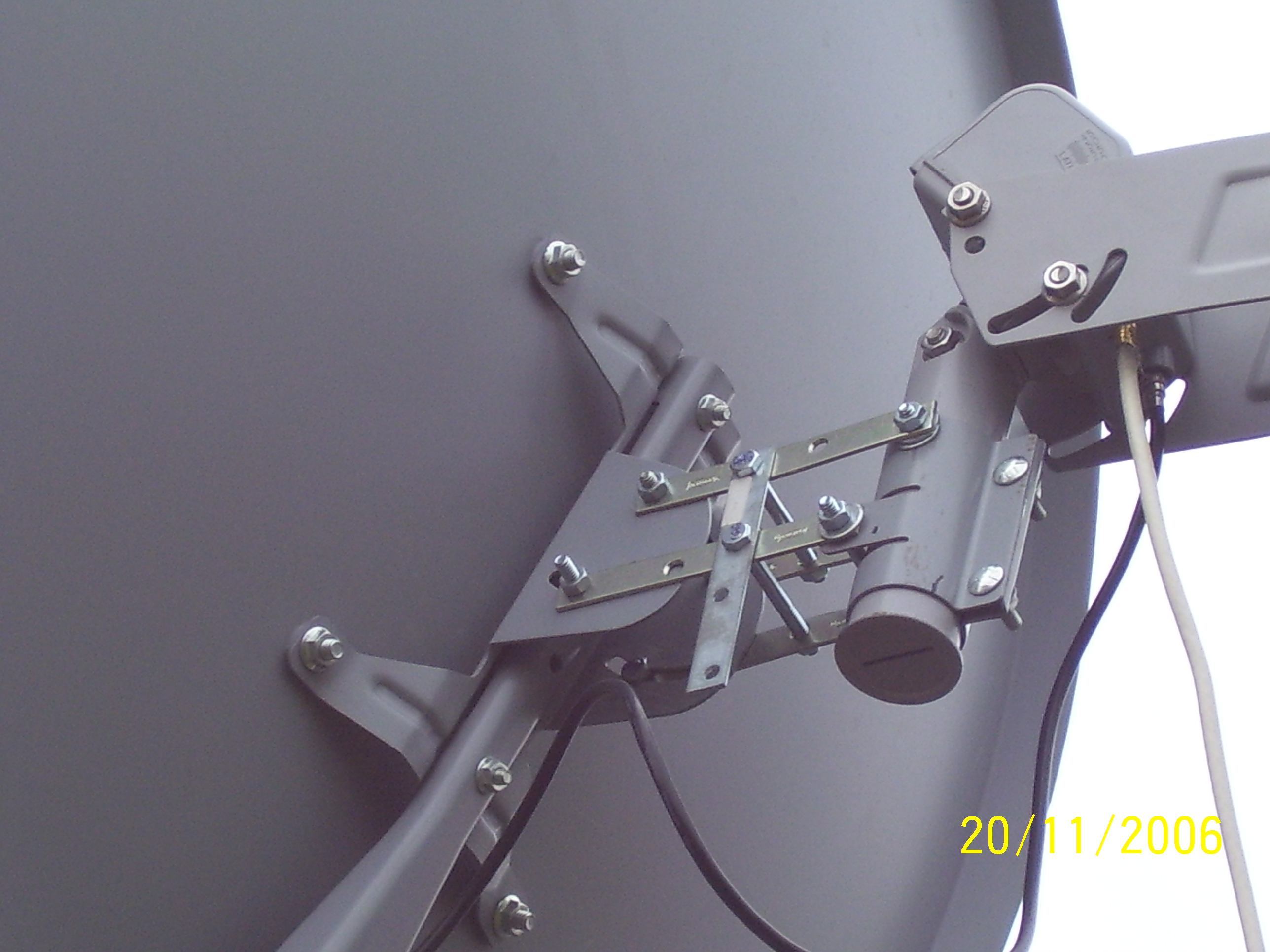

Hi colbec,
I ran into a very similar situation with an Alphastar dish. The mount on the Alphastar dish is very similar to the ExpressVu dishes, and it wouldn't work with my Stab HH90 motor that I had bought because the dish kept hitting the motor. I sat and stared at the dish and motor for hours and finally came up with an idea to move the dish further away from the sleeve. I went to my local hardware store and bought some "Mending Plates". I bought them all the exact same length so that the elevation wouldn't change, just the dish would be further away from the sleeve.
See the picture below for how I used the mending plates, and a bunch of bolts to move the dish further away from the sleeve.
This option had worked well for me. The dish tracks the entire arc no problems.
