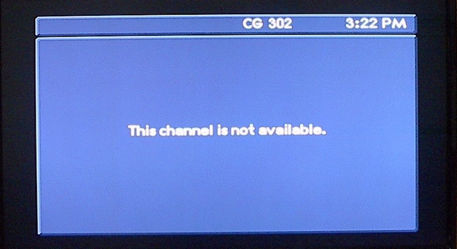

But what will commercial units be using to get authorized for masters? Is there a EMM in Combo/MegaPipe that we can't see?
The commercial services are on a different datastream that the 4DTV cannot see, so no way the 4D will display that info. Although when a commercial channel goes FP or ZK the 4D will decode it. You can tell channels that run commercial only by the message "This channel is not available" (see attached) We will see allot of this come next year I'm sure once 4096 is gone.
I've seen that on the like 5 non-combo mode channels on SES1.
