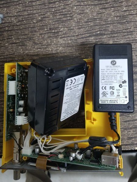

I tried turning it on with AC plugged in, but it wont turn on. Just charges. However, i opened the birdog up and it has the power supply on the right (see pic). I unplugged the power supply, connected the battery, and my birdog turns on and stays on without error. So im now going to order a power supply, splice the connector on it and see if it works. I will keep updating.

UPDATE: My power supply came in today and I'm happy to report that it indeed fixed the problem. I ordered a "SA06-24S12R-U" power supply (Ebay $15). Spliced the old connector onto it, plugged it in, no more "3.3v low" error.
