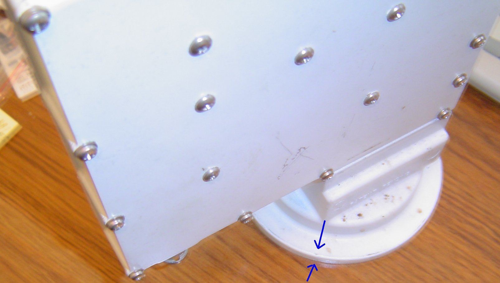

I looked on the two I have here, and if you look on the part that fastens to the scalar ring, there is a little dimple. It looks like someone used a punch and put a dimple there with a hammer and punch.
That is what should be where the arrow points.
Sorry! But I think that will get you both polarities.

Ok, looking at the LNB from the smooth side, it is right at the edge of the flange straight across from the corner.
See Pic:
Ok. Now I'm really cconfused. The past owner had the LNB hooked up and had bolts with washers holding it down. The washers left marks. On the assumption that it was mounted right, I re-bolted it in in the same place.
The scalar arrow was pointed right on that little corner of the LNB that you kindly showed in your photo.
It is exactly there that I got duplicate stations on H and V.
