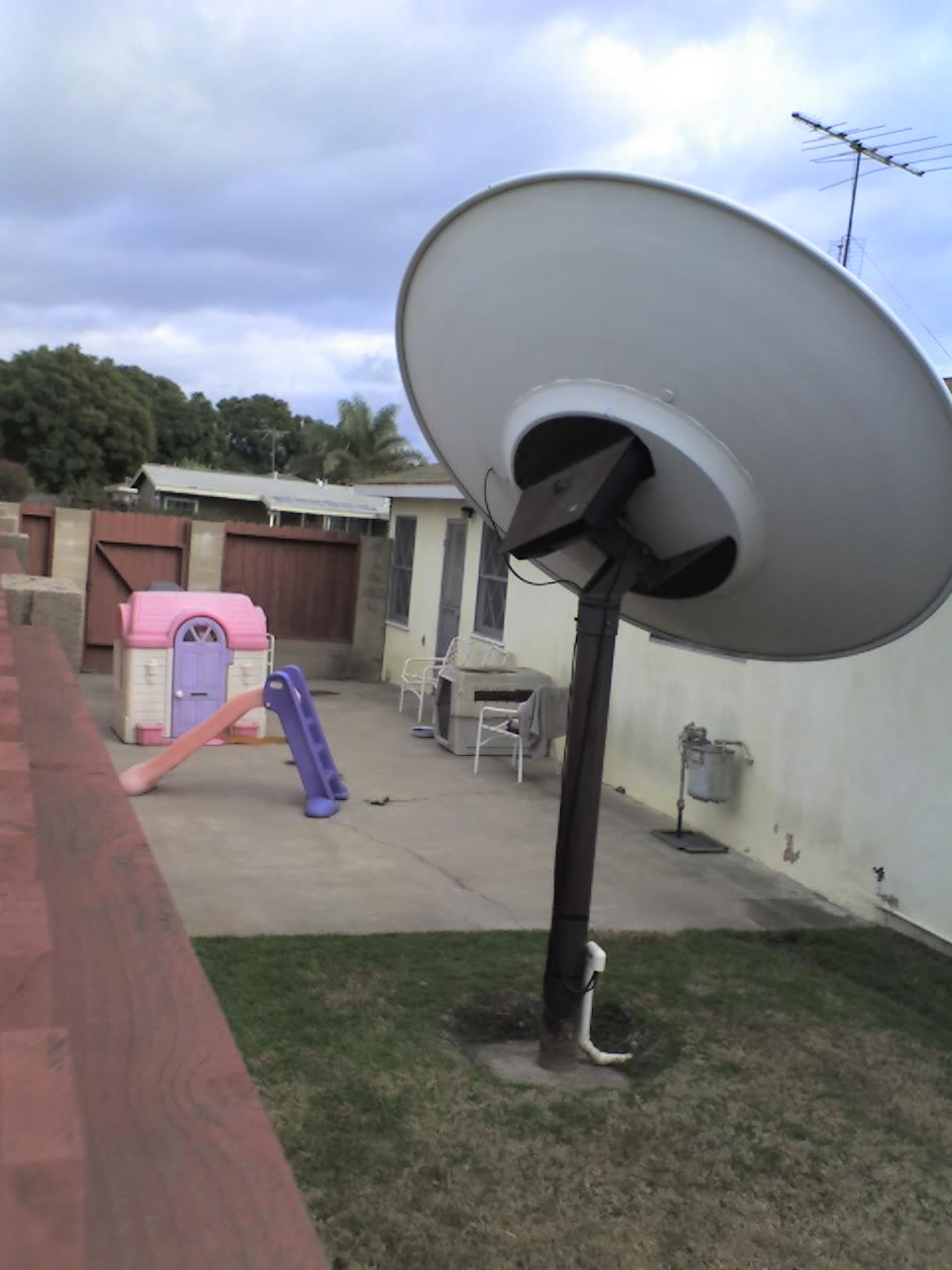

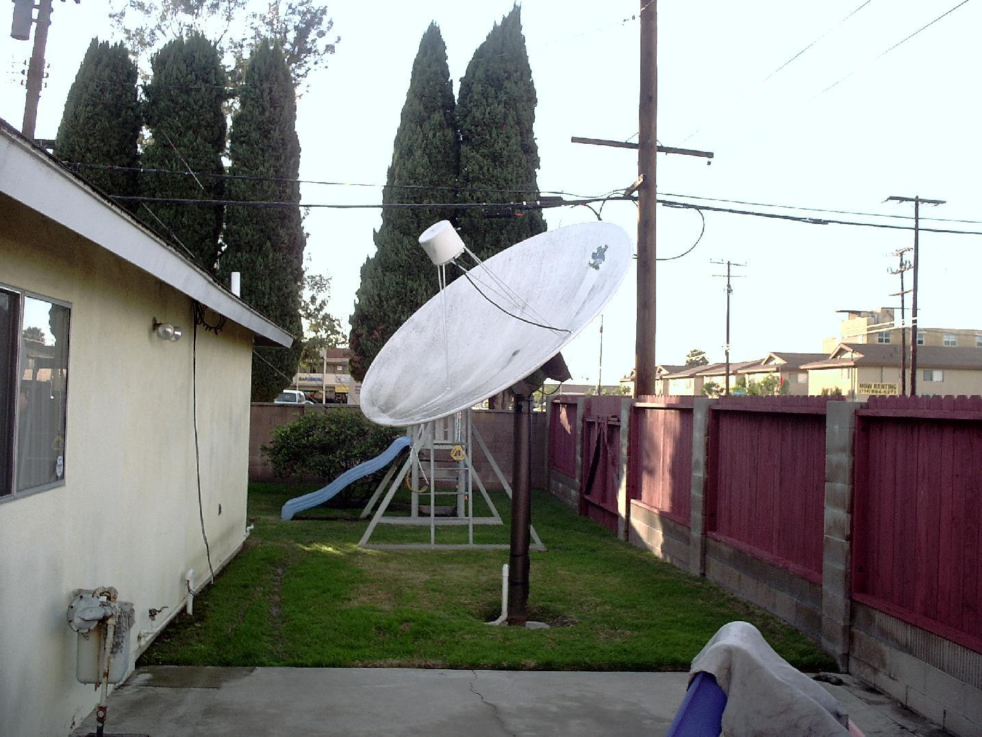

On a nice clear 'n warm Saturday, about noon, a buddy and I went to take down my Birdview.
Below are pictures of the ordeal - :eek:
0 - 1 : First, we have rear and front views of the target.
It's a beauty. Quite clean, too!

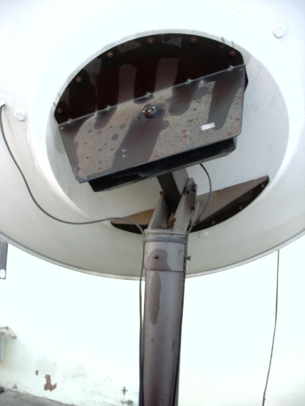

2 : I'd sprayed on PBblaster and other nut-busting lubes several times over the preceding two weeks.
ALL the hardware came lose without a complaint.
And there was no anti-seize compound on the threads, either.

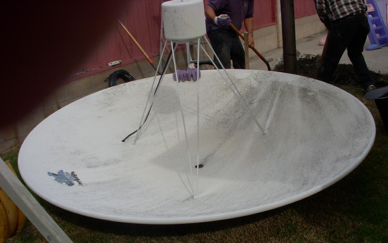

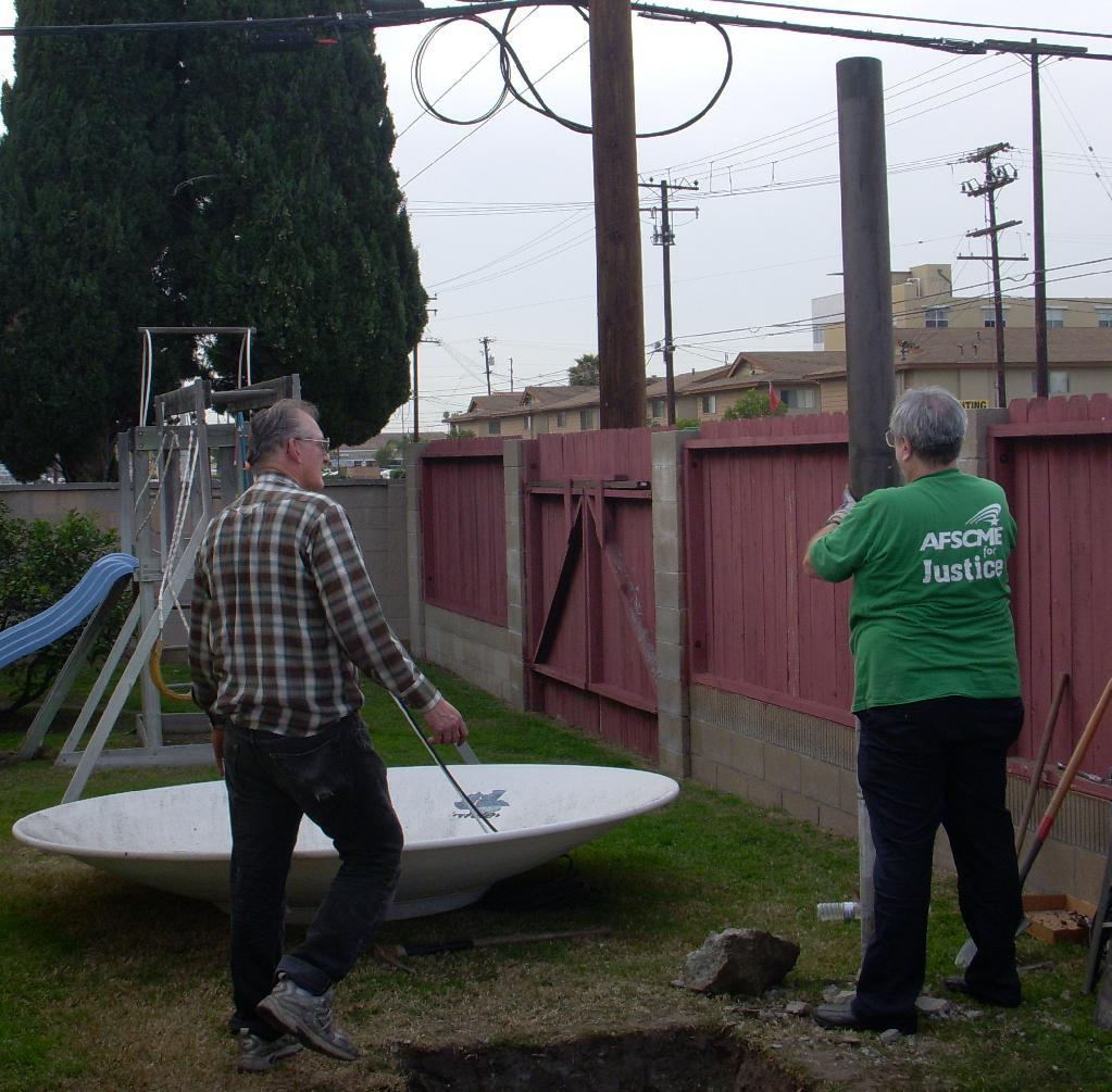

3 : We took off the dish by removing the 12 bolts on the rear.
Carefully, three of us slid the 100 lbs dish down the mount, and put it on the ground.
Just to the right of where the gloves are laying, is a clean spot on the dish rim.
That was effected by simply rubbing the dish with the gloves, so I don't think cleaning it will be much challenge.

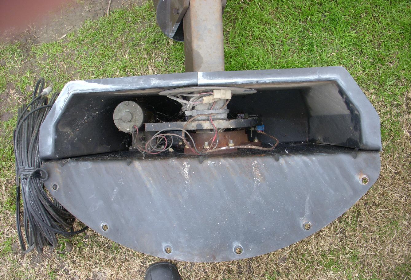

4 : The mount was awkward to grab. The lower bracket pivots freely.
We got hold of it, and lifted it off the pole without too much huffing and puffing.
It looks relatively clean inside, thanks to the mild 'n dry California weather.
More pictures of the guts will be taken after getting the thing on the work bench.

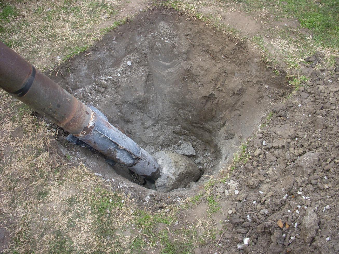

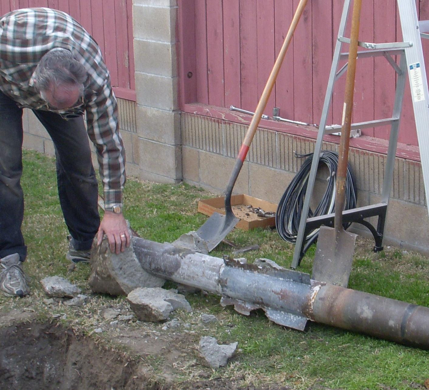

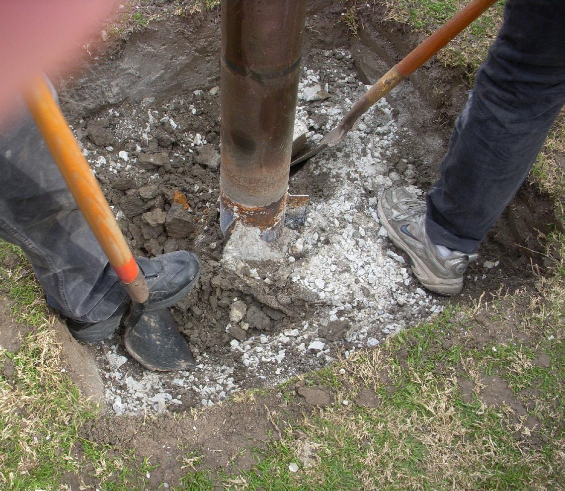

5 : Then we made our first mistake: digging out the pole. - :rolleyes:
There was a 2x2 foot slab of concrete at the base of the pole, and it was a good 5 inches thick!
Below that, was a three foot deep, 11..12 inch hole full of cement!
It took a lot of sledge hammer and shovel work to get through the slab and attack the lower end of the pole.
6 - 7 : Eventually, we got the pole where it would move (after several breaks).
We worked the pole from side to side, filling dirt 'n chips beneath it, 'till it had risen at least a foot.
Still it resisted, and more sledge hammer work was needed!

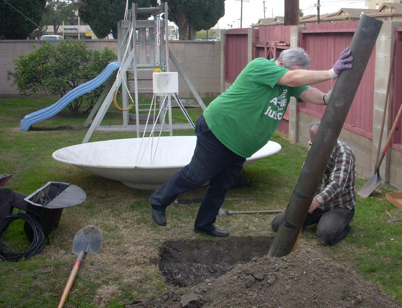

8 : Eventually, the pole was pulled out.
Note the damage to the anti-rotation fins.
That was rust we think from not having complete encapsulation by the concrete in the hole.
I plan to wire-brush and paint, so the next 25 years in the ground should be easy.
9 : I'm 6'2", holding up the 9+ foot pole.
When they planted these Birdviews, they really intended them to last!
The bulk (prophetic word to use) of the work had to do with the concrete on the pole.
Probably 3..4 of the 4..5 hours we spent.

Oh, I forgot to mention: the Birdview poles are six inches in diameter!
It's some sort of tubing, not pipe.
But still, with concrete in one end, it was a big job for two guys to carry!
The machinist I got the dish from thought the pole and mount had a black oxide finish.
Well, from pictures I've seen, and looking at mine, I've got to say, it's not the right stuff for outdoor use.
I'm open to suggestions, but am thinking wire brush, scotch brite, and some sort of rust-adhering paints will be in my future.
Both for the pole, and for the mount.
The one seriously rusty place, was inside the cap.
That's the top of the pole, under the mount.
And when we threw down the pole onto the patio, some water ran out. :mad:
One big bolt with a 1 1/8" head, holds the mount to a plate welded inside the top of the pole.
The big bolt is reusable, but I'm going to look for a more serious cure for all that rust.
