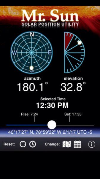

Use a solar calculator to provide the date and time the sun is at the apex for your location. The feedhorn shadow will indicate the true dish orientation. Here is an example screen capture from an iOS app "Mr. Sun" showing the exact sun position for a given date, time and location.
