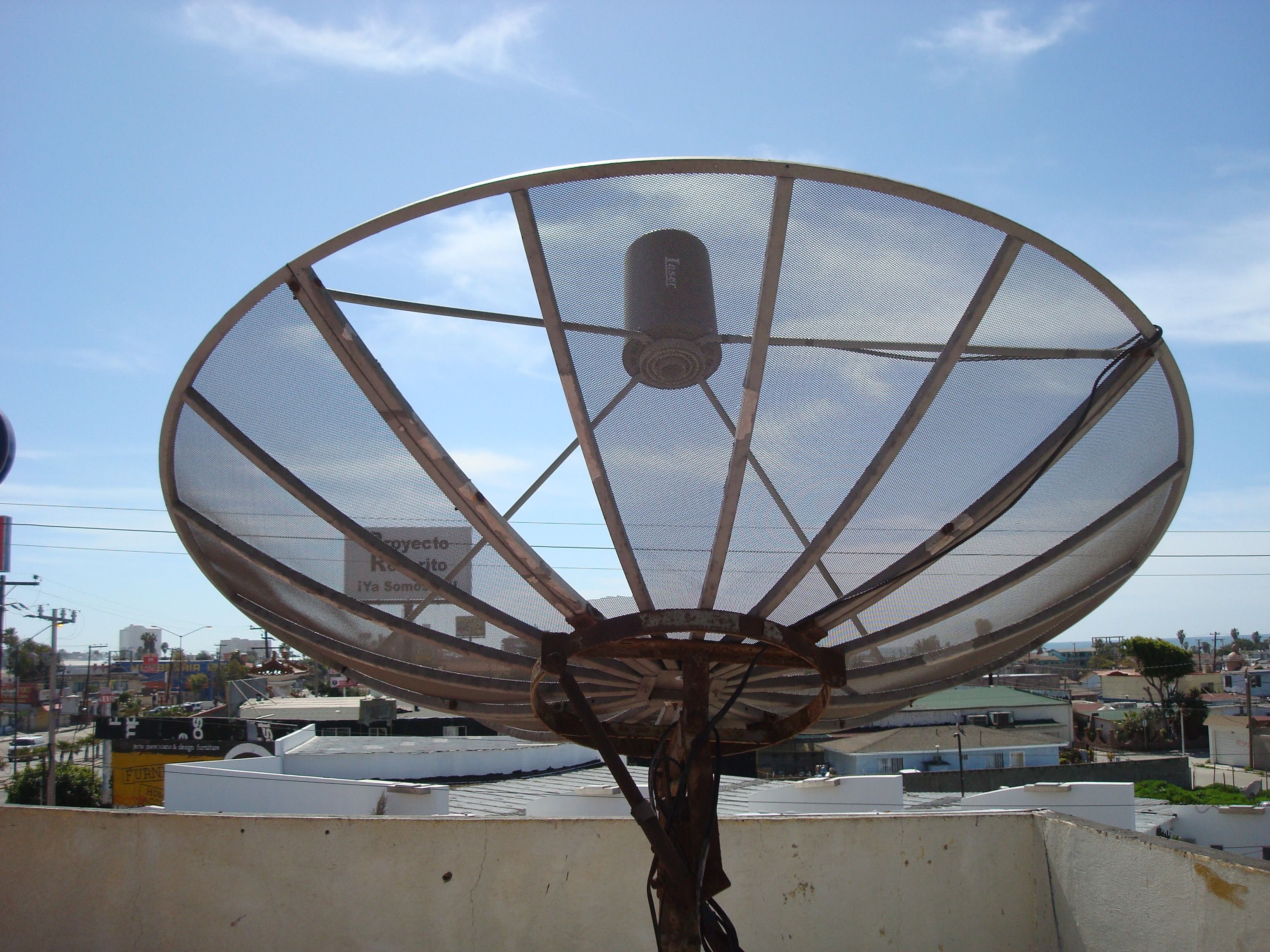

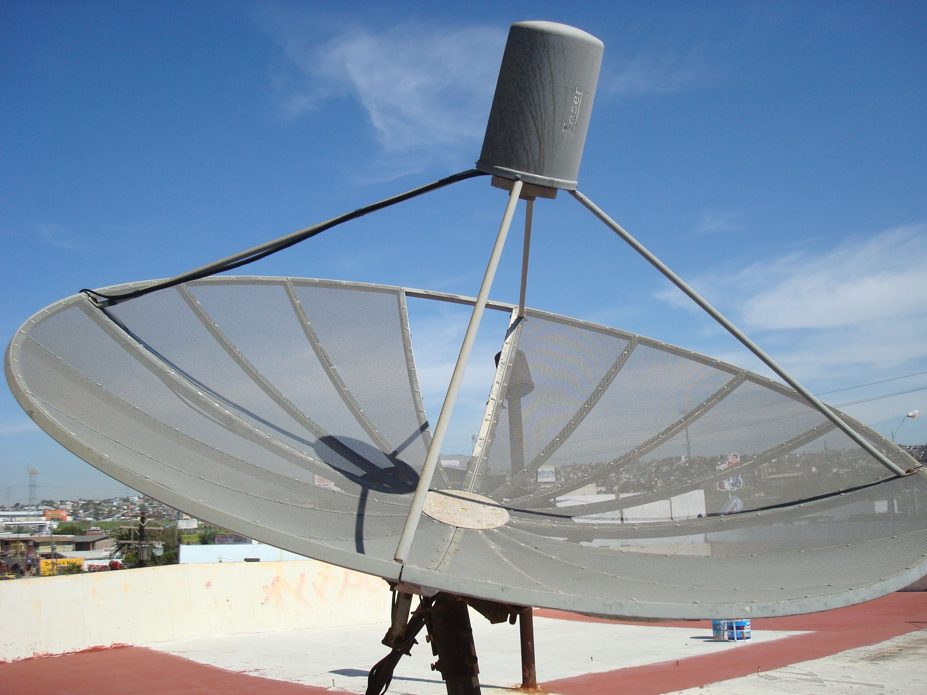

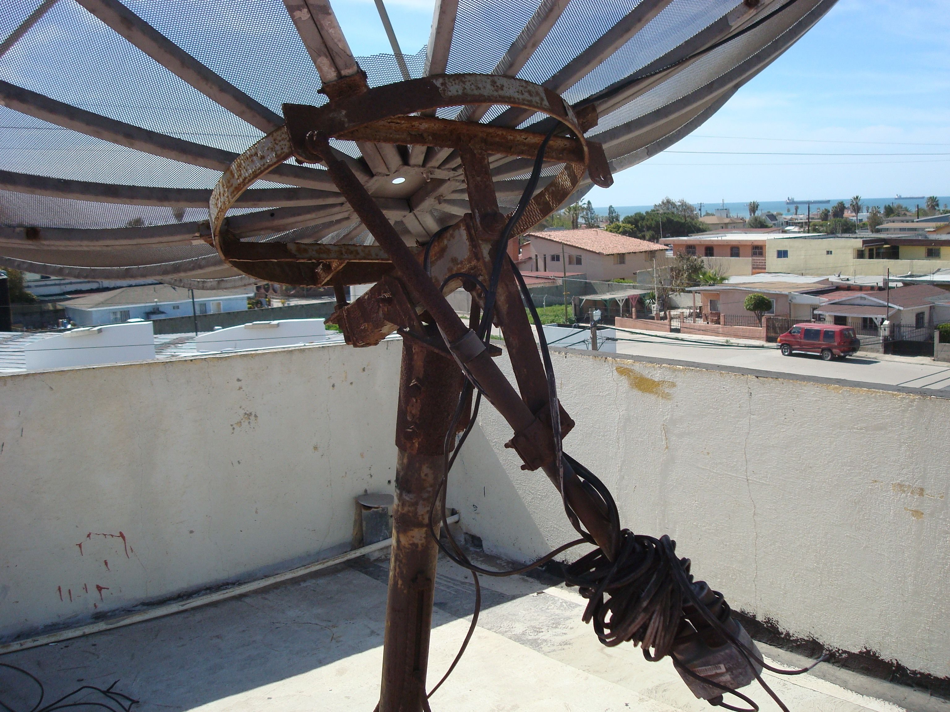

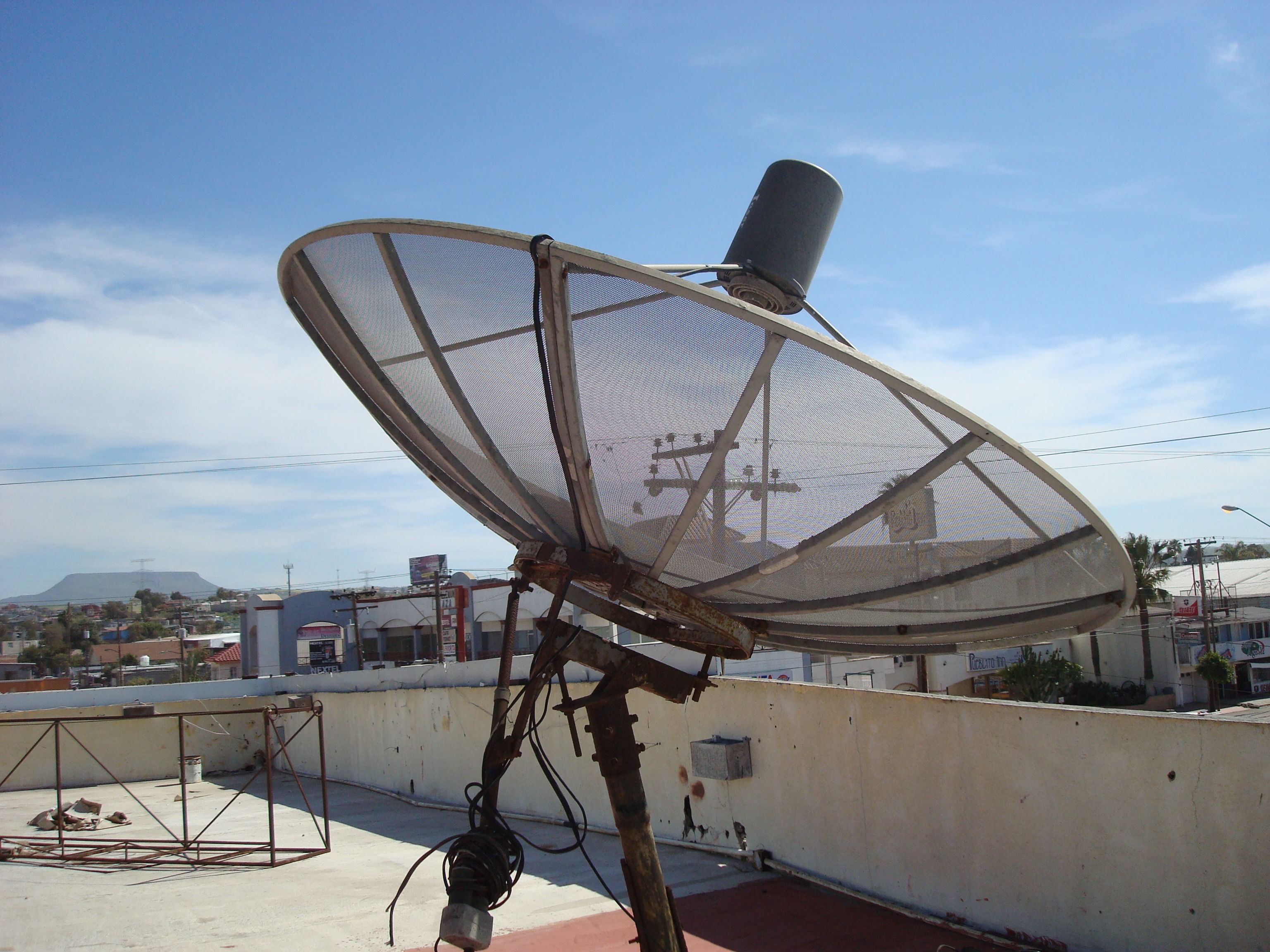

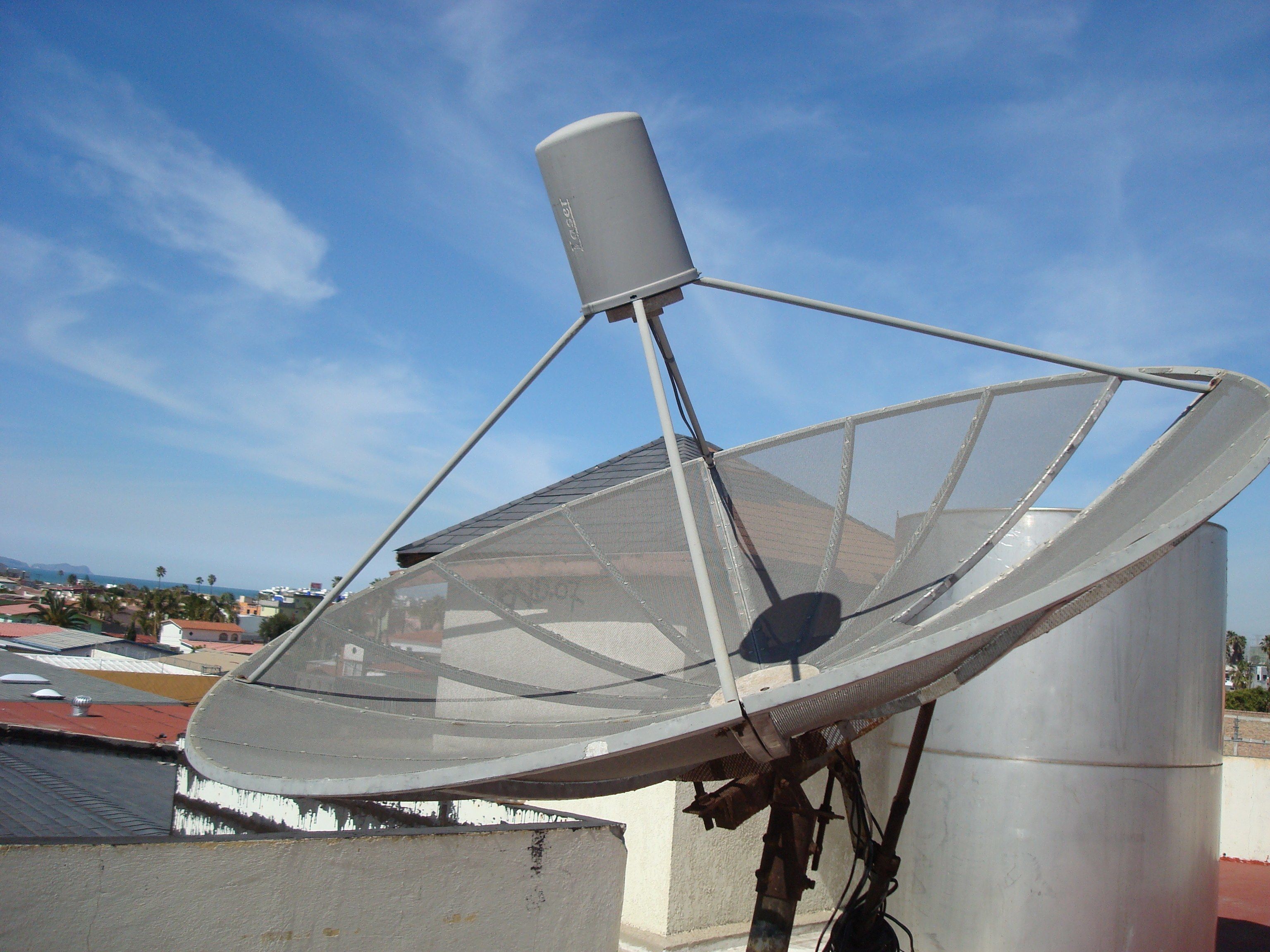

Found this BUD on top of a restaurant here in Baja. No marks on it - measures 7 1/2' by my tape. Took the Birdog meter with me and the LNB shows signs of life (got a reading other than 0). Actuator is froze and I know it's trash.
What do you guys think about this as a rehab project? Best guess it's 25+ years old and the mesh (other than the missing panel) is tight weave.
Any guesses on what it is?

IF it where me, and I needed/wanted another BUD I would go for it, if the price is right, I have a 7.5' Dish and I have no problems with it at all.
You can buy new panel material from SkyVision, I just got some, been waiting for better weather to put it in.
Actuators freez all the time, I have replaced mine two or three times.
I have two 10 footers that I think I am going to try and make one out of, some panels gone from each, anyway good luck.
Terry
The dish maybe an Odom??? If it is, they are out of business. Sami will be one of the very few places where you can get new C band dish parts, and the parts you get from them will not be an exact fit for this dish.

I hear ya - but the LNB support looks solid and I have a spare LNB, switch and plenty of coax. The labor I'd do myself if I decide to to the refurb - just checking to see if this is/was a "classic" dish that anyone could ID.

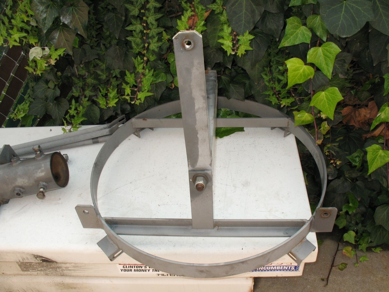

Here are a couple of pictures before sandblasting and after sandblasting of the polar mount. Then one picture of the installed dish with a temporary C/KU lnb installed.
yes? no? maybe?
Well, it does say Laser on the nose cone.
Should ring a bell for someone.
Your metal work looks to be in a lot worse shape than what Greg Harris was working with.
And while I have nothing against sand blasting (bead or media [walnut shell] blasting) a good workover with a wire brush on a drill will knock off all the loose rust.
Then, you go over it with a good rust adhering paint or primer, and it should be fine.
See paint discussions in my signature, for brands.
I'd be surprised if ya spent $50 doing that.
As for the motor, there's currently a 24" model on special offer on the front page of Galaxy-Marketing, right now
(Better known as WSI, one of our Gold Sponsors)
So, I'd evaluate whether that's useful or not.
You have C-band LNBs and feeds, so I won't suggest you order up a C2 or the dual-output cousin from WSI.
But if you did, they're not expensive, either.
Especially if I send you a C2 . . . :eek:
I'm just trying to make a case for the refurb costing more on the order of $100, but then I'm cheap. - :D
AND, the dish 'n mount are not the best ones I've seen.
Show us some pictures of other available dishes.
You might want to just pass on this one.
Kinda depends on how much time and work you want to put into it.
After a couple of decades of service, we can only guess if the nose cone belongs with the dish.

Oh wise green one,
I am extremely disappointed in you! I expected you to be able to ID any BUD on the planet based on blurry black & white pictures taken straight into the sun! My confidence is now shattered:river.
Seriously, unless someone ID's this as a real dog - I'm going to grab it. May just scrap the mount and have a new one built/welded (labor is REAL cheap in Baja right now :D). It will stay at the beach house. I agree - more like $100 if you know how & where to get things done.
Need to back on Thursday to finalize - sure curious what's under that "Laser" nose cone.

Thanks for the input. I'm retired, so time isn't an issue. This will be a "project" dish - but if it has lasted @ 25 years here, it could last 100 years anywhere else..
This will be sitting at the beach house in the salt air - so I won't even consider anything new. Stuff made today simply won't stand up to this environment. Have seen "new" powder coated metal completely rust out in well under 18 months here. Actually, if I can figure out how best to use epoxy paint on dissimilar metals, I may give that a try. Another thought is my friend at a local auto body shop (with a bake booth) that owes me big time.
To me, most of the enjoyment of FTA is not just buying stuff to put up, but adapting and making stuff work. Anyone remember the project to get an FTA rig up at $0 cost? That set-up is still running today - and I still don't have one cent in it (just to prove it could be done).

Sorry, I must yield to the BUD experts when it comes to the big dishes. :)
If you want some encouragement on the dish, do a string test on it.
However, C-band isn't all that critical for getting your feet wet, so I'm sure it'll be fine.
I was only suggesting you might find one in better condition.
So don't be paying a lot for it. ;)
Now, if it's got a non-penetrating roof mount, that might make it worth having, even if all the panels were missing! - :up
Greg is right about the sand blasting, and if you can get yours done for $5 or $10, that'd be great!
Maybe your auto-painter guy?
However, I still insist you don't -need- to get to bare metal.
But you -do- need to use the right paints, especially living on the coast.

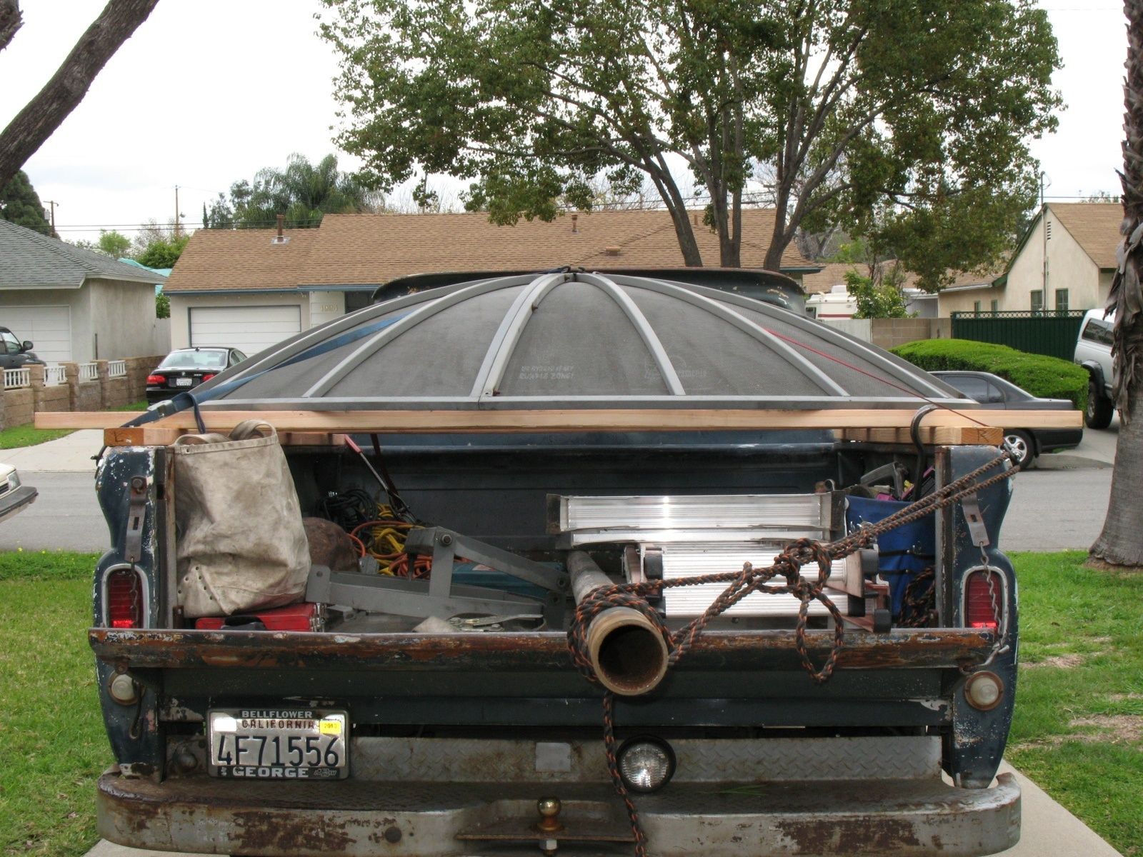

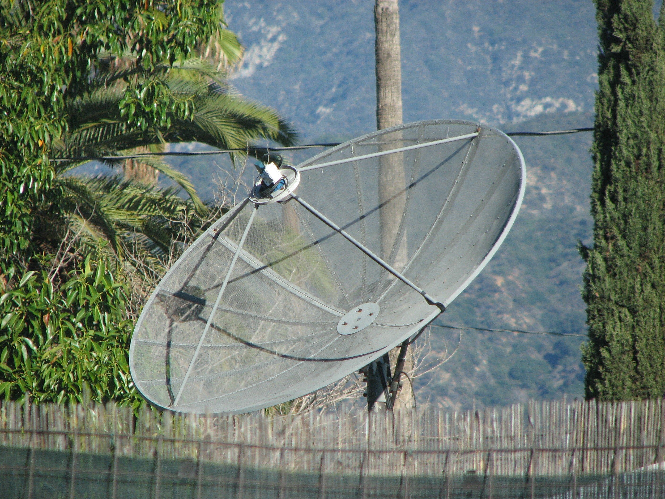

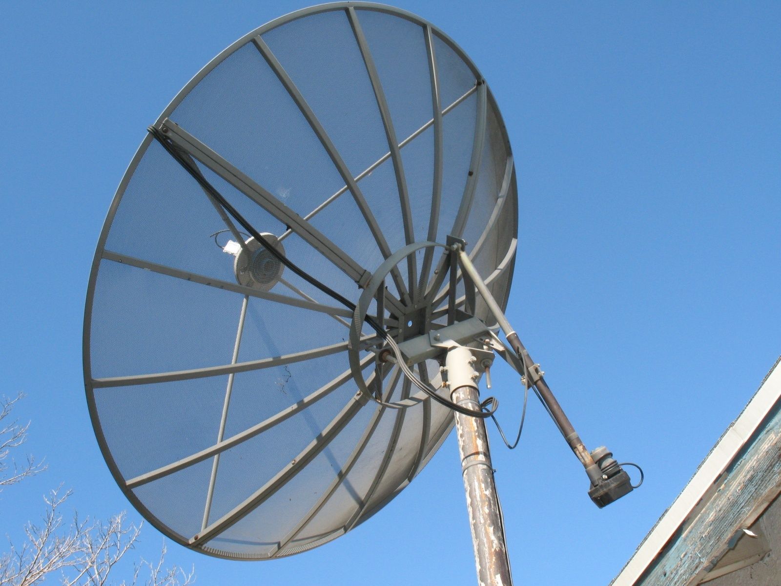

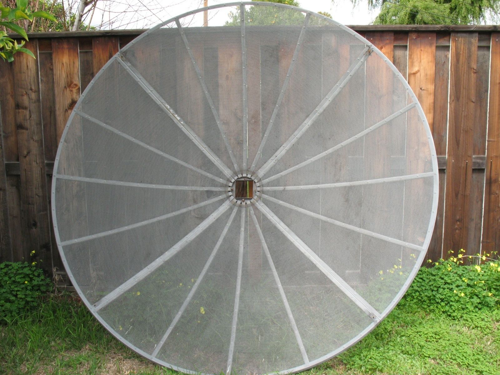

I just picked one of these 7.5 footers 1/4 mile from home in nice condition(for 2o+ yrs).
Got the dish complete with extra wire, 14 ft pole, Venture motor, GI 450i analog receiver for $100.
I transported the dish face down on some 8 ft 2x4s screwed down to 2x4s mounted in the stake holes of my old pickup, lightly tied down of course so as not to bend anything.
My dish was sans the lnb cover as you can see, so there was nothing left to id the maker of the dish.
Are most mesh dishes like these all aluminum(excepting the polar ring mount of course)?
Good luck with your project there in Baja. When I get mine back up in the air I'll upload some pics. :)

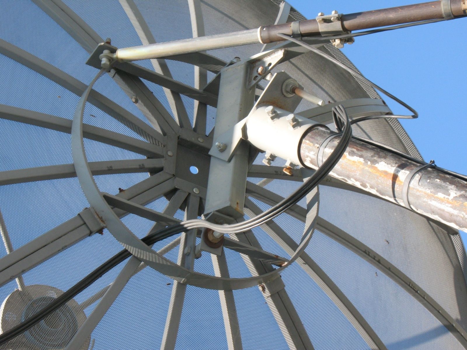

Brex,
That is the bigger version of the 67 inch dish I have. My LNBF cover has "Perfect 10" on it.
Odom, Laser or Perfect 10? Confusing.

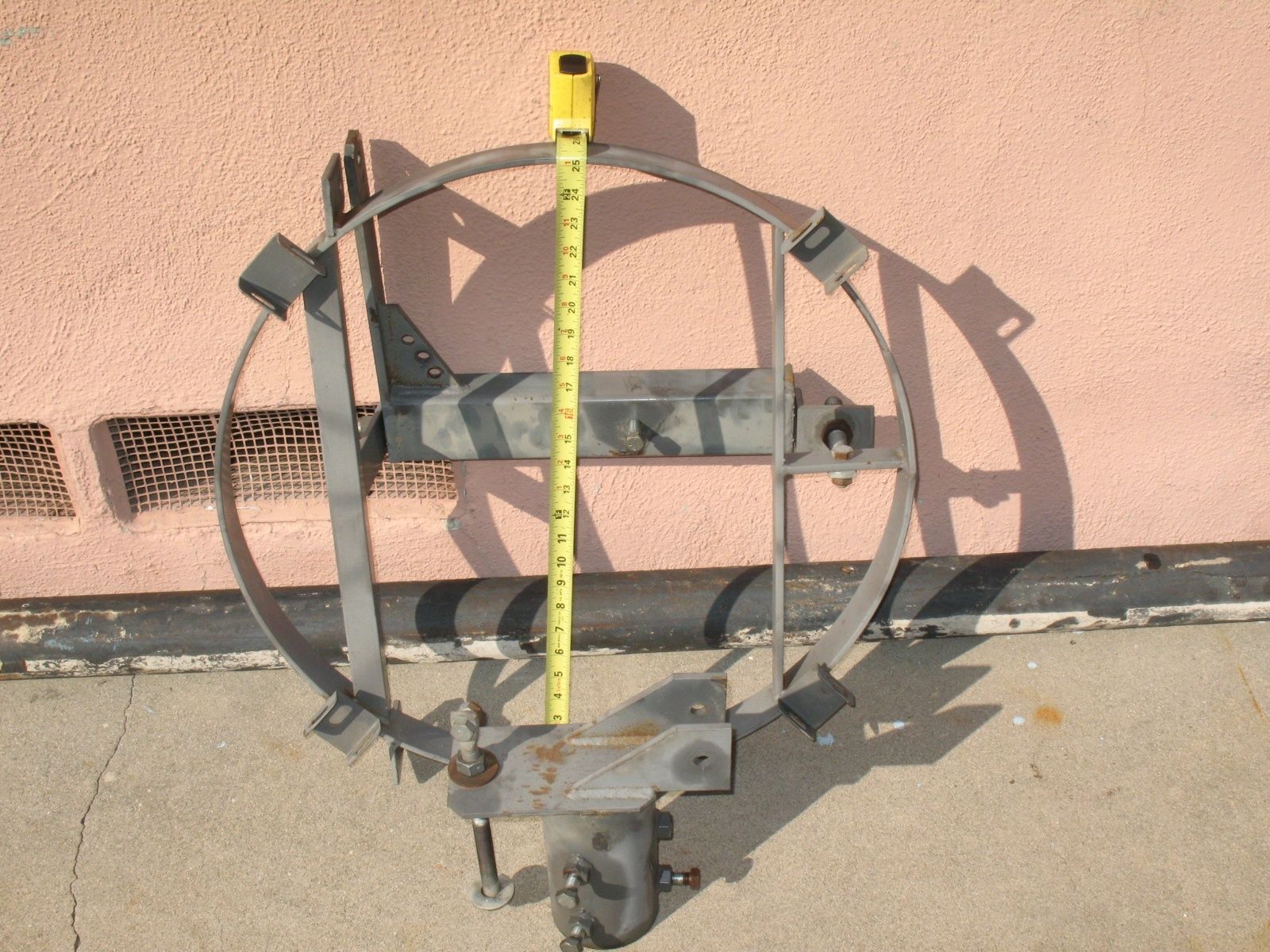

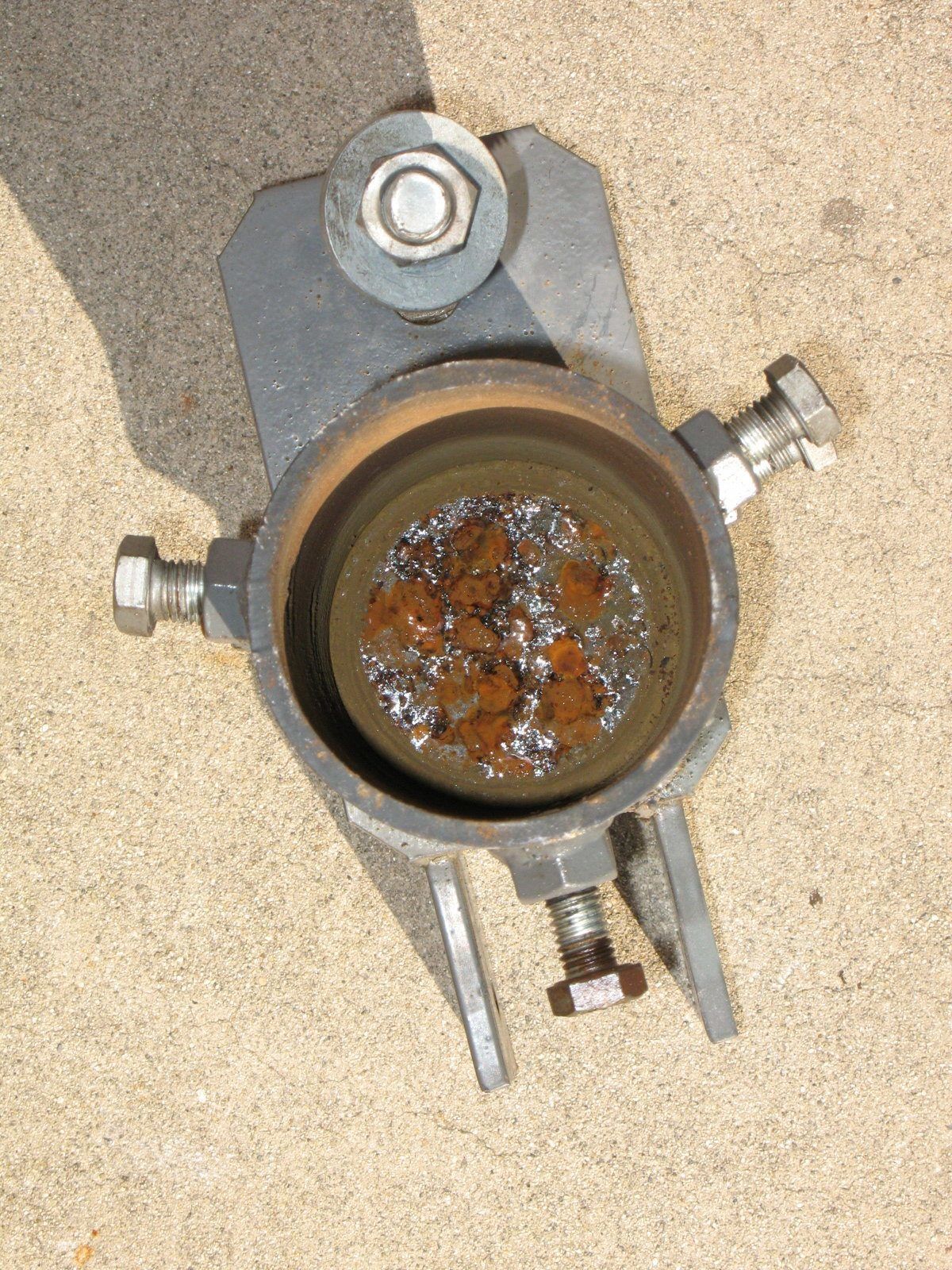

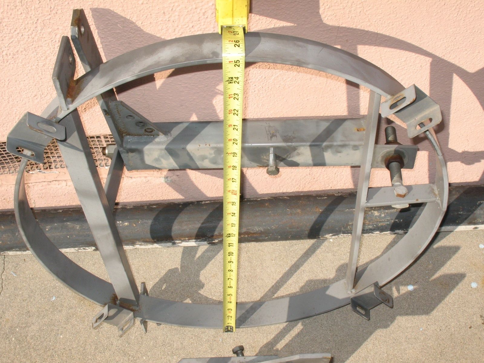

MikeinBaja...I measured the ring for the polar mount: 1/4" x 2" x 25" diameter & the rectangular tube is 2' x 3' x 16". 3 1/2" tube mount with 6 each 1/2-13 bolts to lock it to the tube. The 7 1/2 ft dish is 14 1/2" deep and passes the string test.
Are your measurements for your polar mount the same?
