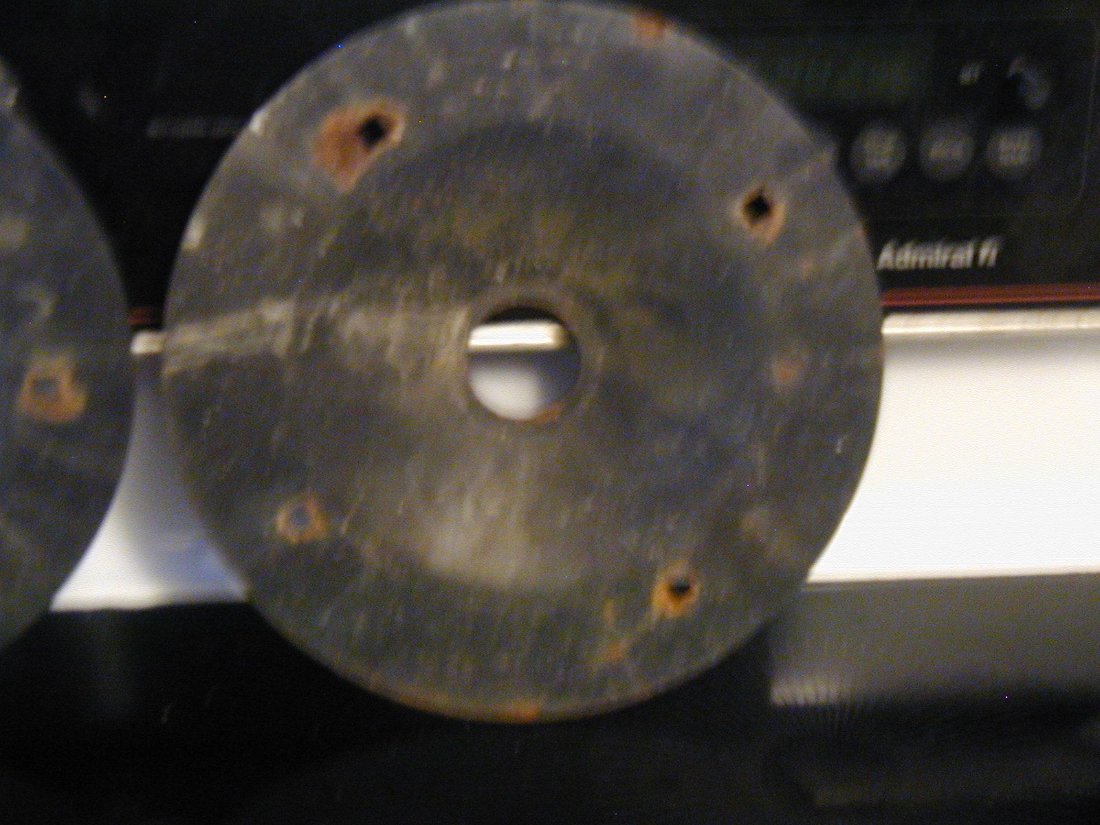

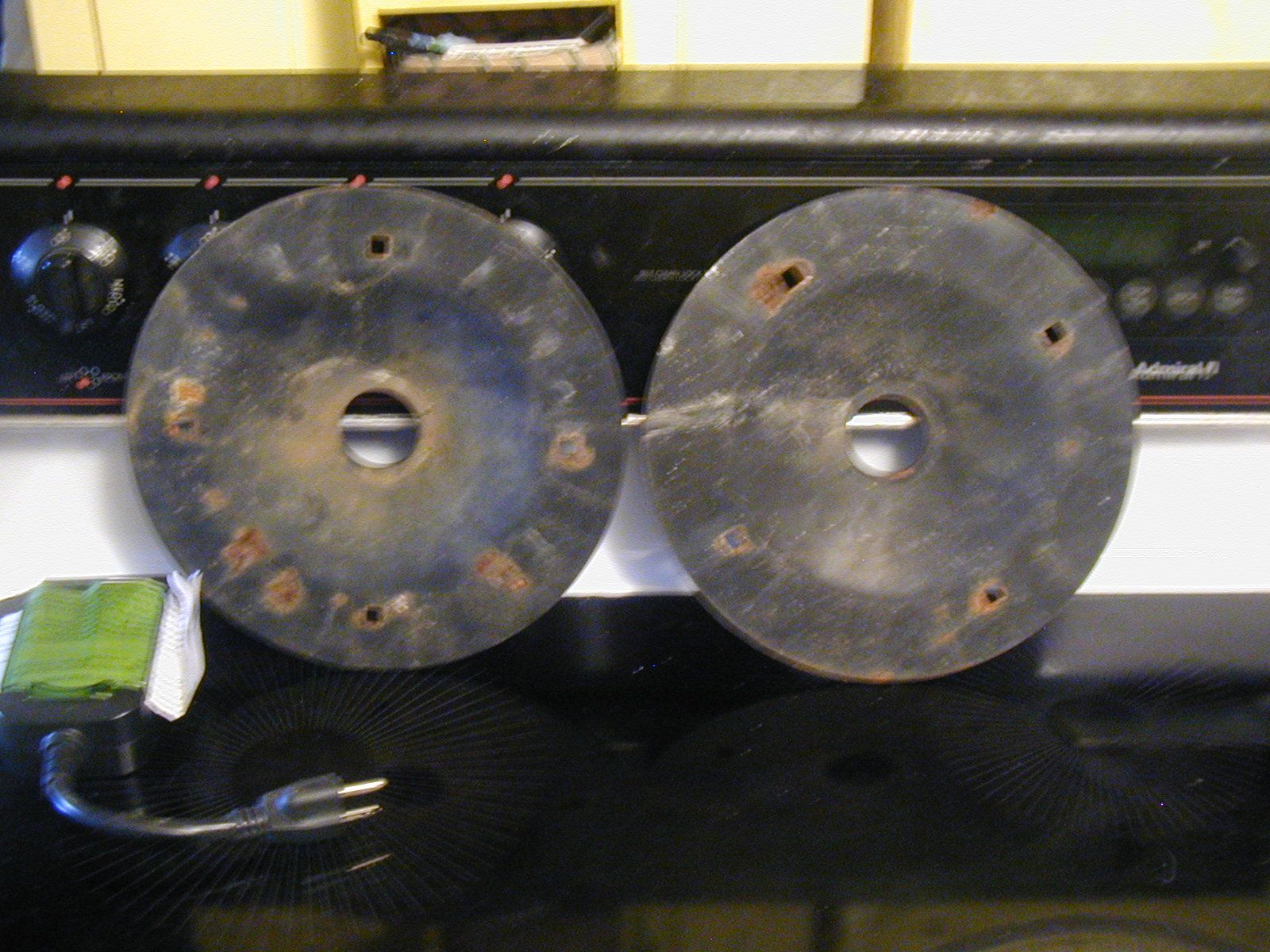

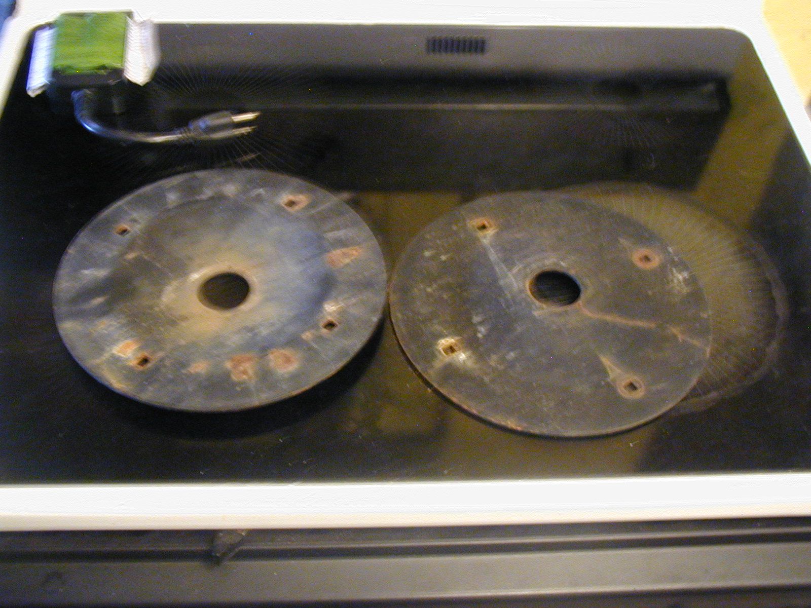

these are the plates that I have. The pictures are a bit fuzzy, but should be good enough. The O.D. of the plates is nine and a half inches and the hole in the middle looks to be an inch and a half. It shouldn't be more than a few bucks for me to ship them to you I'd think, if they might be something that would work.

I think that will work. I will take a look when i get home tonight on the measurements and let you know. Thank you for checking.

Thank you for looking. I think that A Raine has what I need.

I have the plates for the buttonhook (Thanks A Raine) but the center hole is a bit larger in diameter than the diameter of my buttonhook pole. I was planning to just use a sleeve to beef up the post to the proper diameter. I started out looking at aluminum but couldn't find the 1.5 OD, 1 3/8 ID that I needed readily available. I did see that there is polycarbonate tubing that meets those exact requirements. I've seen the stress tests on that stuff and it looks really impressive. It is just to support the buttonhook and LNB so I don't know how much force I am really concerned about here. Does anyone know of an alternative solution? I'm out $10 if it fails to produce the results I want but if there is a better option I'm willing to go with it.
