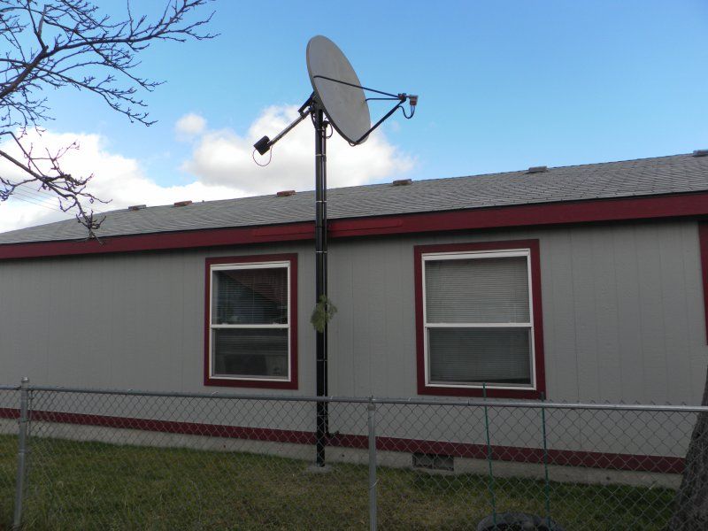

I put up a 1.2m ku dish a few months ago. I can do both :) PSTR 002.JPG
I put up a 1.2m ku dish a few months ago. I can do both :)View attachment 132299
Wow Thats a big set up, nice. Mine is 100cm and one of 75 cm. Is your reciever DVB-S2 capable? I see your out in Montana. Beautiful State been there for a couple of weeks in 2016 loved it. We have kids in PA so hard to move but I will definitely come back for vacation again.
