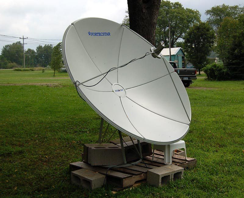

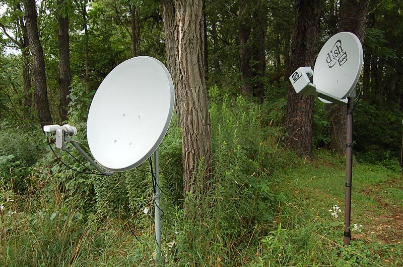

Here's a couple quick snapshots of my new dish farm: :)
BKP said:
Looking Good...
How do you like that ground mount..
It works great if you are moving the dish by hand. A knob controls the elevation and works really well. Someday I hope to move up the road about 500 feet to a new piece of land and I can just load the dish in my truck and go!
I like that white square shaped skew tool you have on the pallet! ;)
