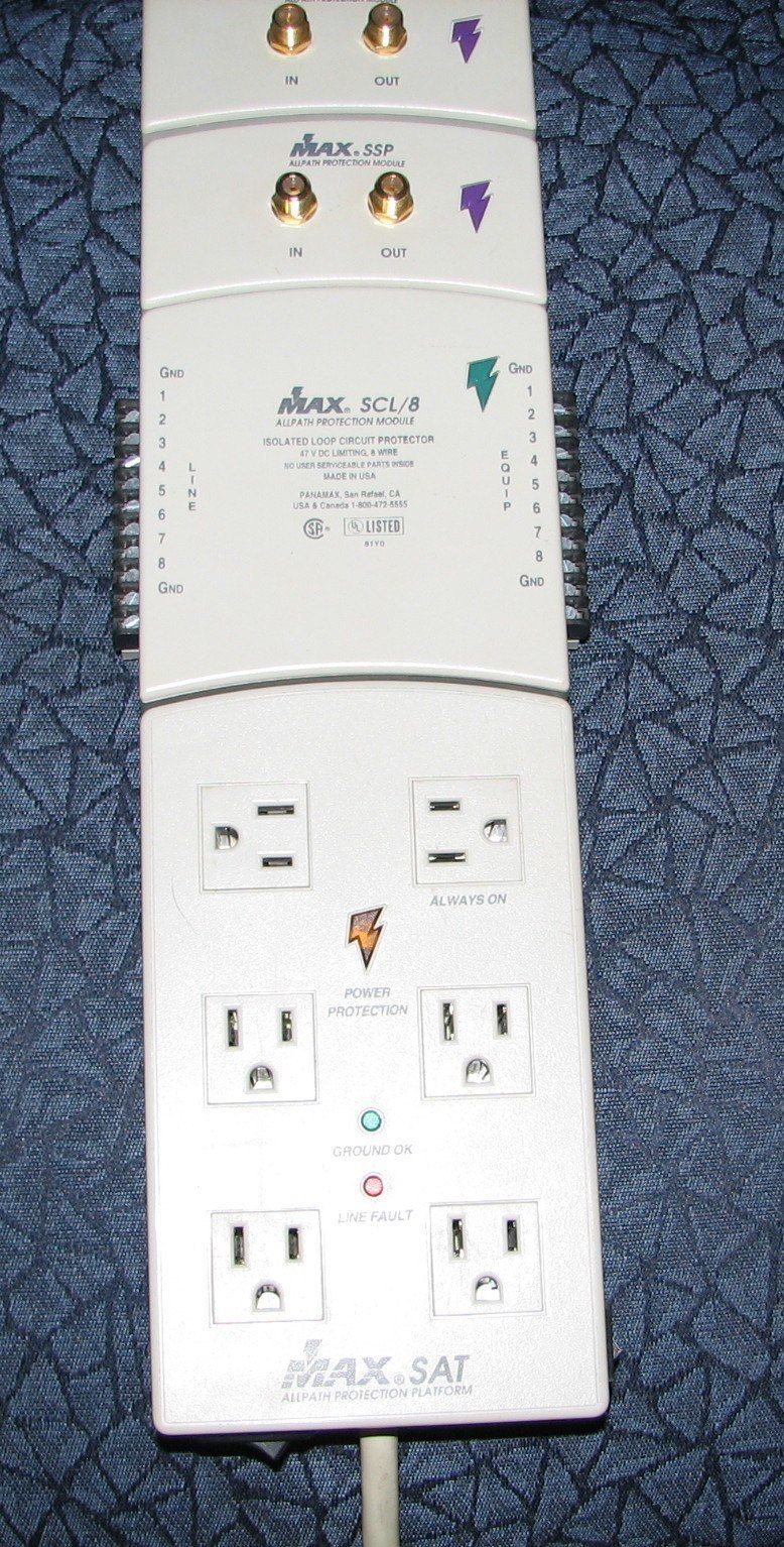

You can use a surge protector with connections for all the motor and servo wires if you are worried about lightning strikes. I have one from when I used to have a c band dish but I'll have to dig it out of storage to get the model number and brand.
It was pricey when I bought it about 9 or 10 years ago, about $250 give or take. They probably don't make them anymore since LSD's have killed the c band market. I'll get back to you with the specs.
It is a MAXSAT surge protector from PANAMAX. I checked there web site but it is not on there so I assume it is no longer in production. Maybe check ebay. I don't want to get rid of it because I might get a C band dish again. It is a modular system that can add or remove modules.
