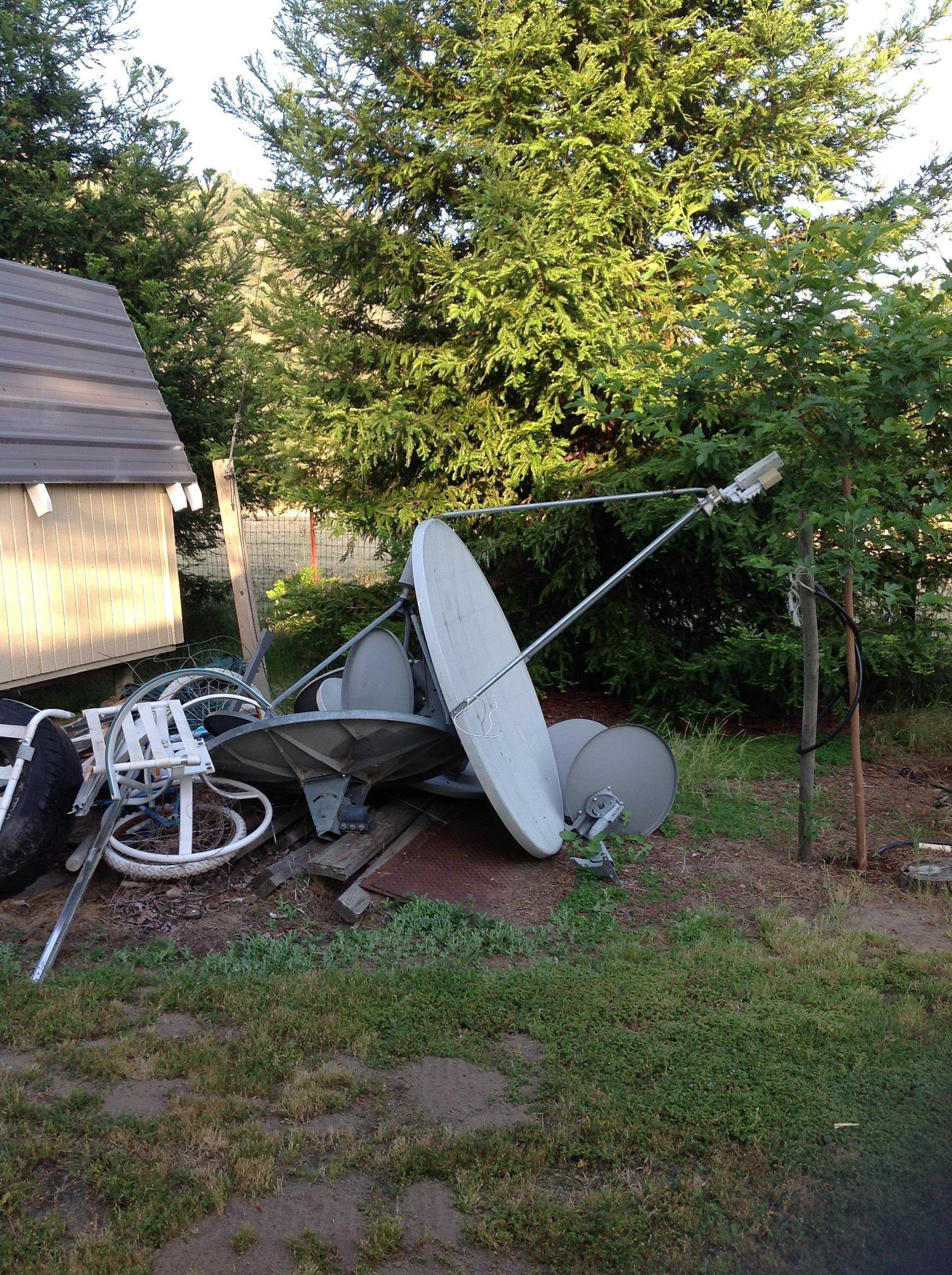

I'm going to have a dish give away next year of all the dishes that seem to pile up around here. My wife wants to see a cleanup. But more than that, they are just going to waste unless they are being used!
Just a few of the Future Spring Cleaning giveaway
Biggest in this pile is a 1.2M
