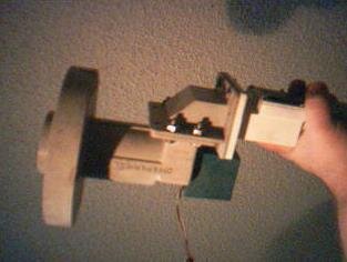

I was handed a C-BAND LNB that is marked 3.7-4.2 Ghz...(other equipment is listed with my signature below) and have a few questions:
1) Is the frequency setting for the coolsat still 5.150? Any other settings?
2) The LNB makes a 90 degree turn into a small white box...can the grey scalar ring and polarizer (blue box) be removed to help with the weight of the unit, and simply attach the white box to the P* dish arm?
3) Anyone know how to interface the "blue box" polarizer? (voltage, switches, etc.)? I didn't get a controller for it!
4) Same question as #3 for an older actuator arm motor?
Thanks in advance! :)

That is a prime focus C-band LNB / Feedhorn.
That blue box is what switches you between Horz and Vertical Transponders. The Coolsat doesn't have a means to control it. I just sold my Coolsat for this very reason!
In your case, I'd recomend just getting a Voltage switched LNB such as the ASC421 from DMS. It'll be a lot cheaper and lighter for you.

PSB sells the ASC421, that is where I got mine from. I think they are about $30 shipped. :)
Thanks for the help guys. At that price...looks like a new LNB may be the best way to go...

That looks like an old Chaparral unit. The polarizer can be controlled with an analog receiver as can the control arm. $15 max on FleaBay.
