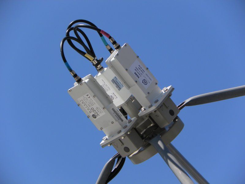

Everybody would like to have that ;) Not much available for C/Ku reception unless you spend some money for a dual orthomode feed and 4 LNBs and it's still a compromise. Titanium carries a LNBF version that may work for you. I use a Bullseye II dual ortho.

Paraclipse is a great dish, but the older ones don't work great on Ku band. Most people elect to use an offset dish for Ku. I don't do Ku, but if I did, I'd use a 48 inch dish. It is possible to motorize them, but as Magic said, you may want to give Titanium's a shot, it's a lot less expensive than purchasing a 48 inch offset dish. :)

The old paraclipse will work very well in KU band if time and effort is made on the installation, its one of only a few mesh dishes made with KU wavelength in mind,
Why most mesh dishes don't perform well in KU band is there wavelength is mainly for C band, this dish is a different kettle of fish,
If you want better results on the older dishes install finer mesh,
I'm not saying it will perform as good as a one piece solid spun dish of the same size but good results can be had.
