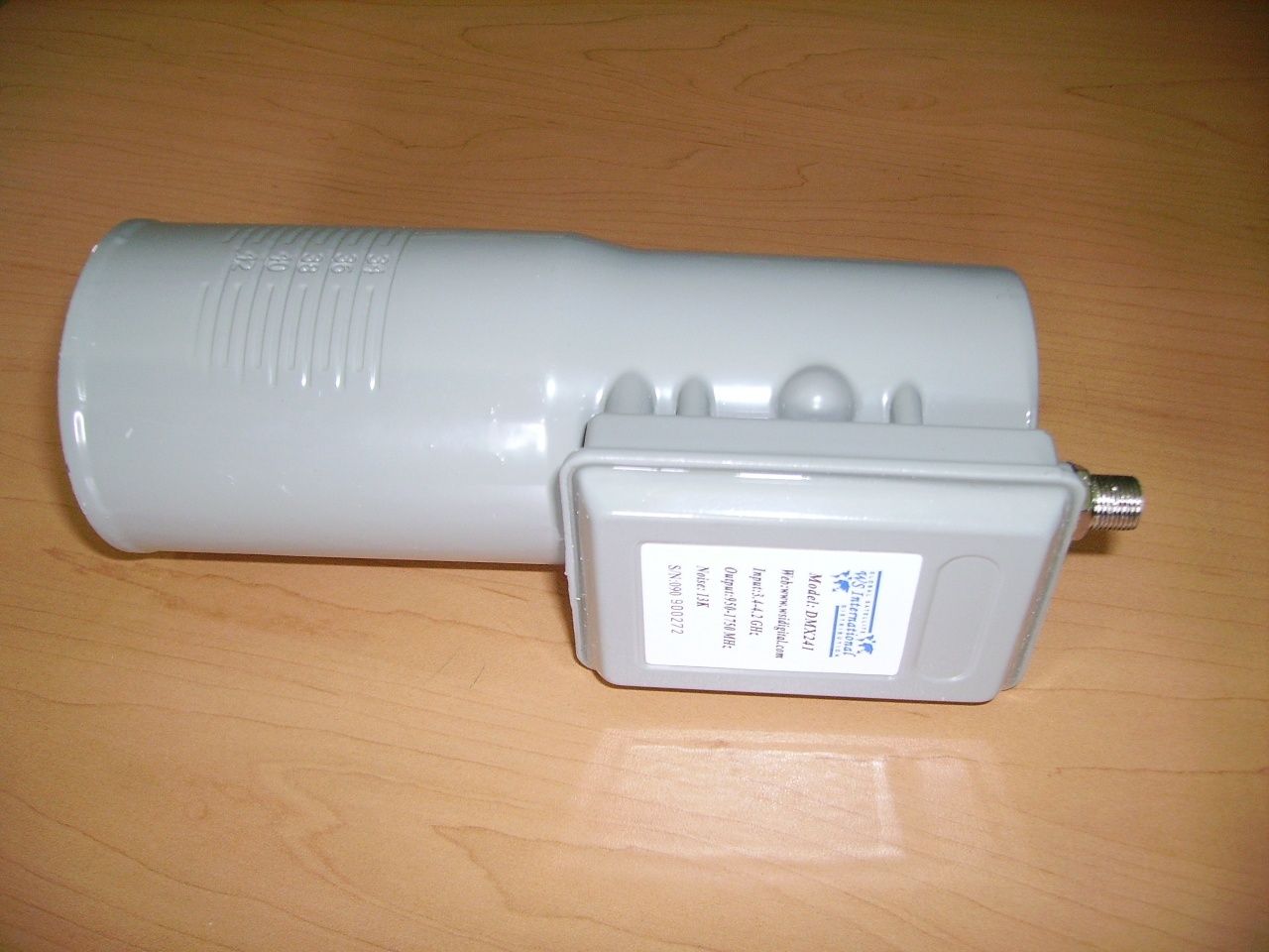

can you take a pic of the lnb or maybe post a link to one like it?
i dont know if the guys will be able to tell what you hav by the info you posted. . .i know its a c band lnb and thats it.
Greenguy
Sorry for the delay.
I am attaching the picture of my lnb
thanks again
I just read the label.
It says, WSI DMX241.
If you'd mentioned that, we'd recognized it right off! ;)
Sounds like you're all set. - :up
Just hook up your C-band LNBF like any Ku device.
