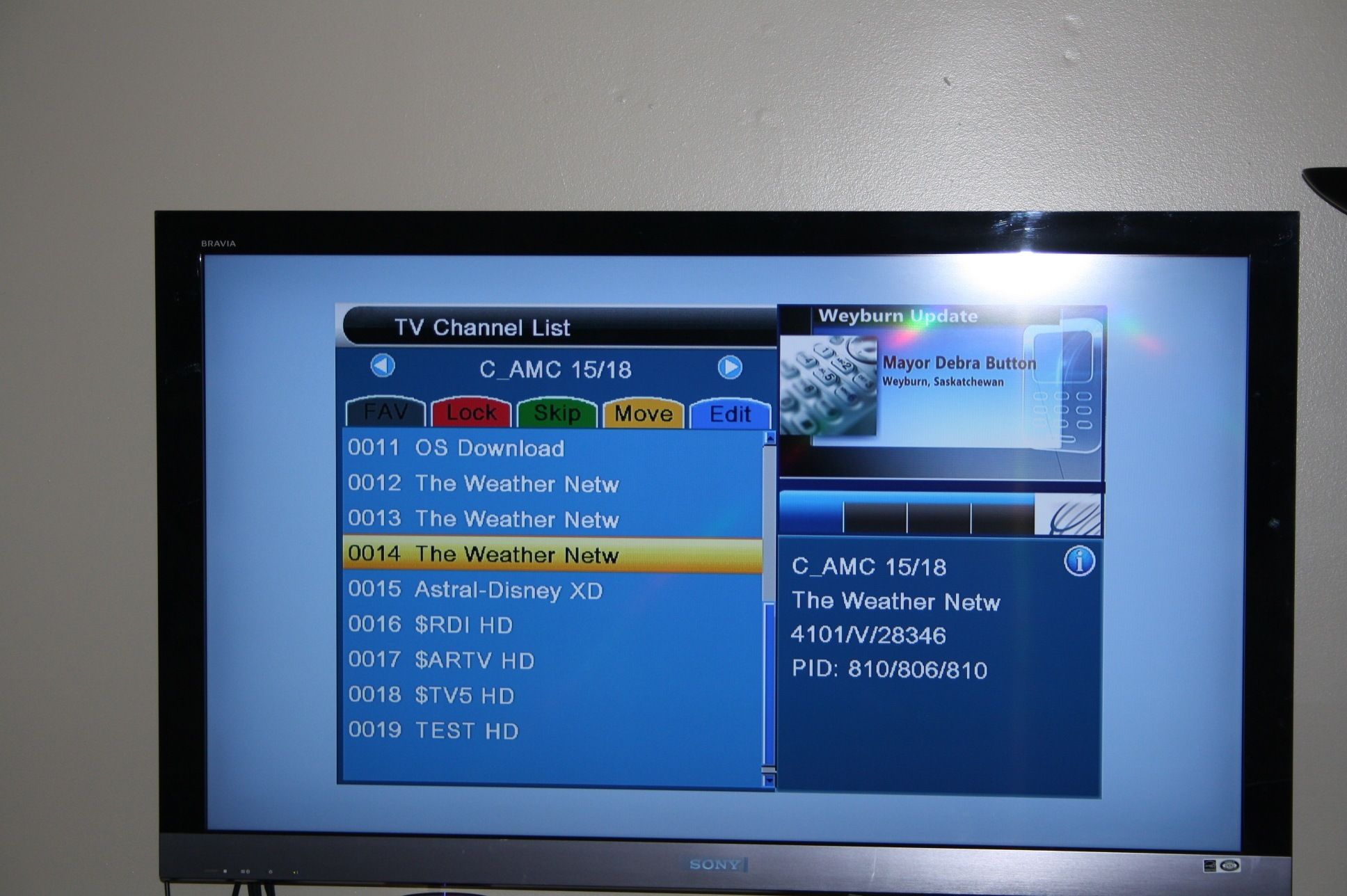

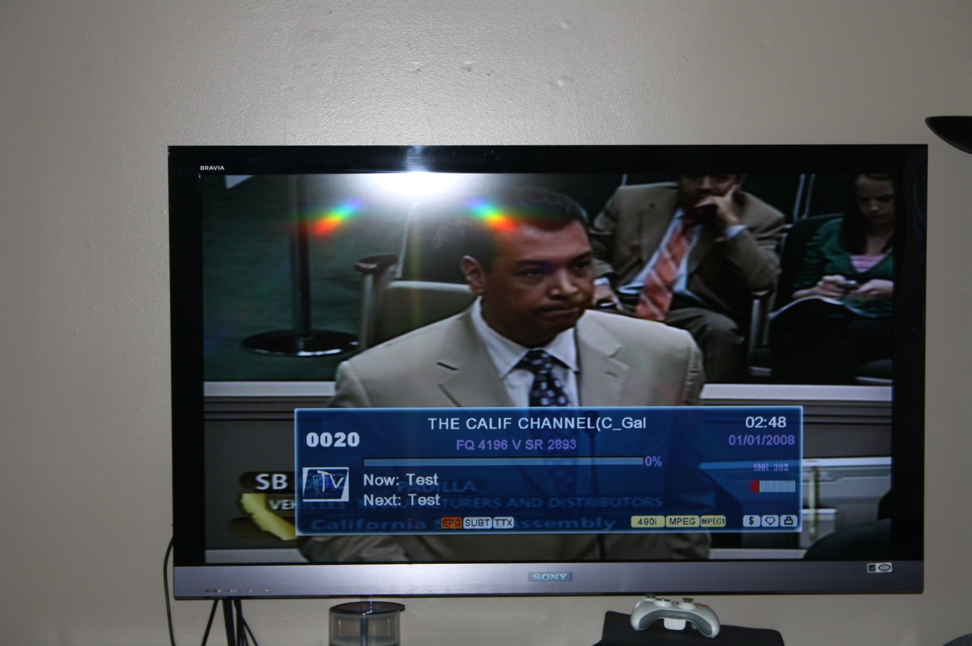

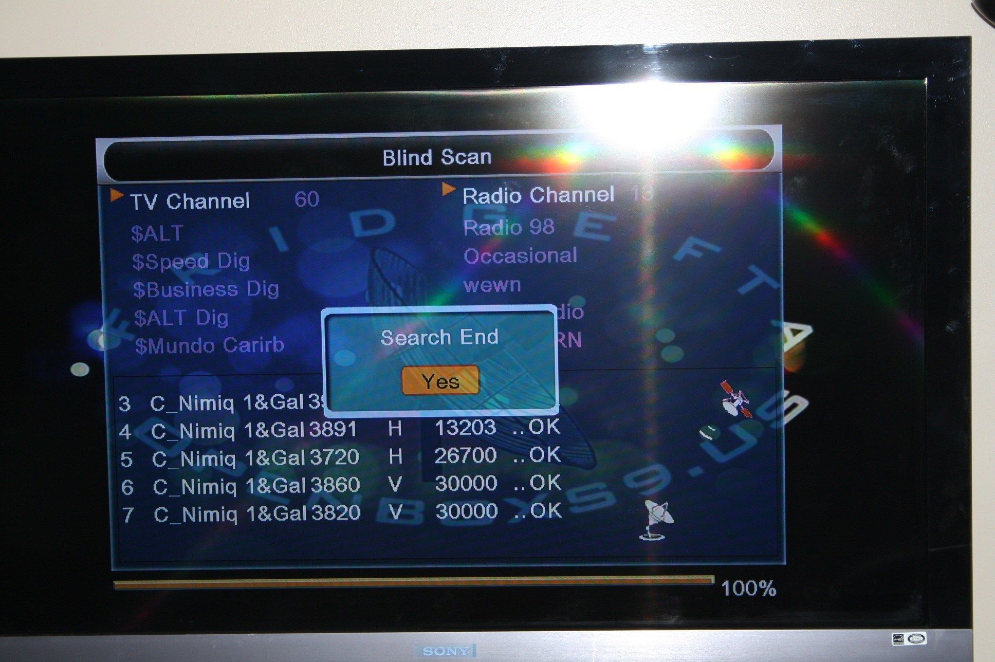

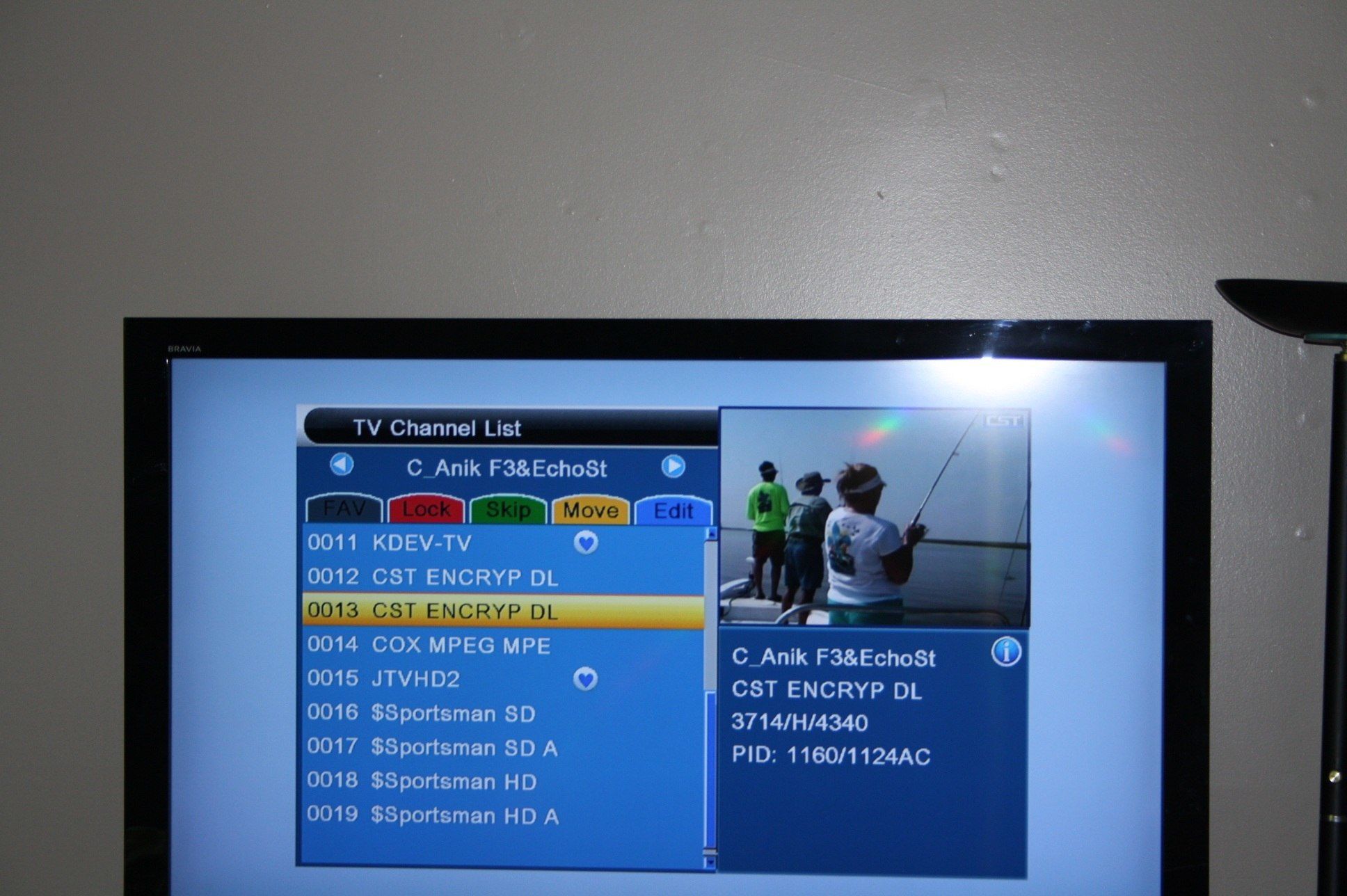

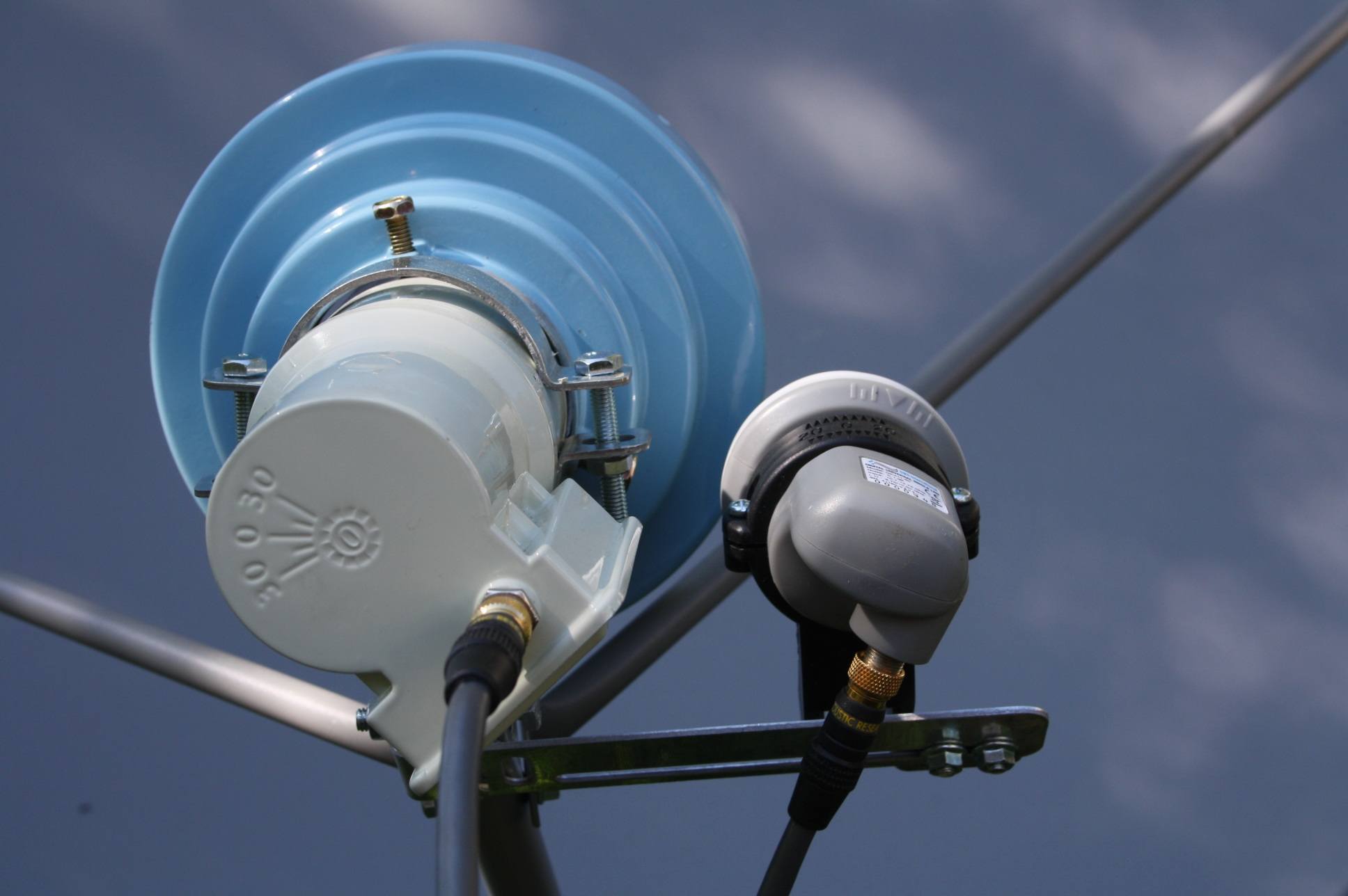

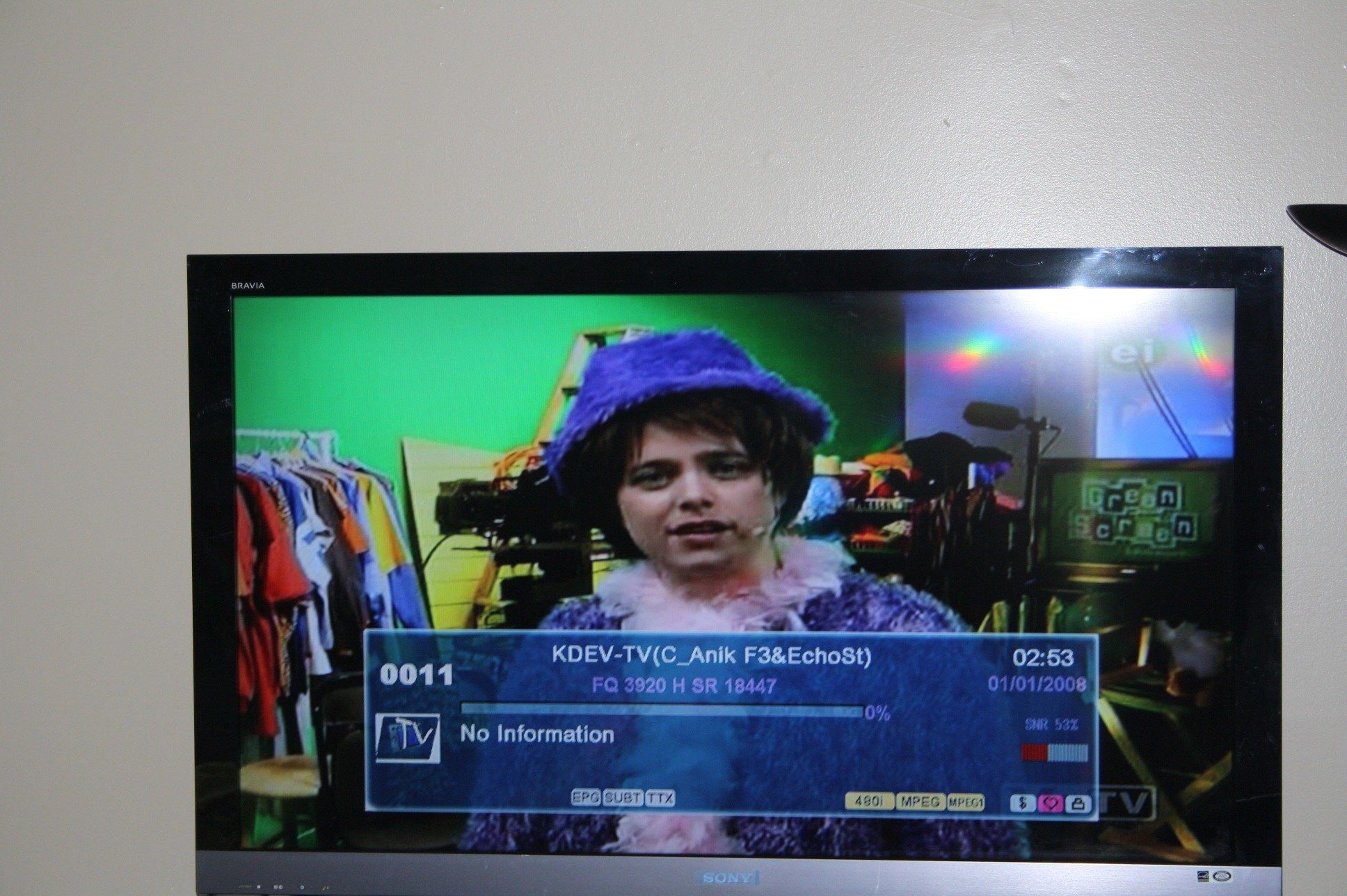

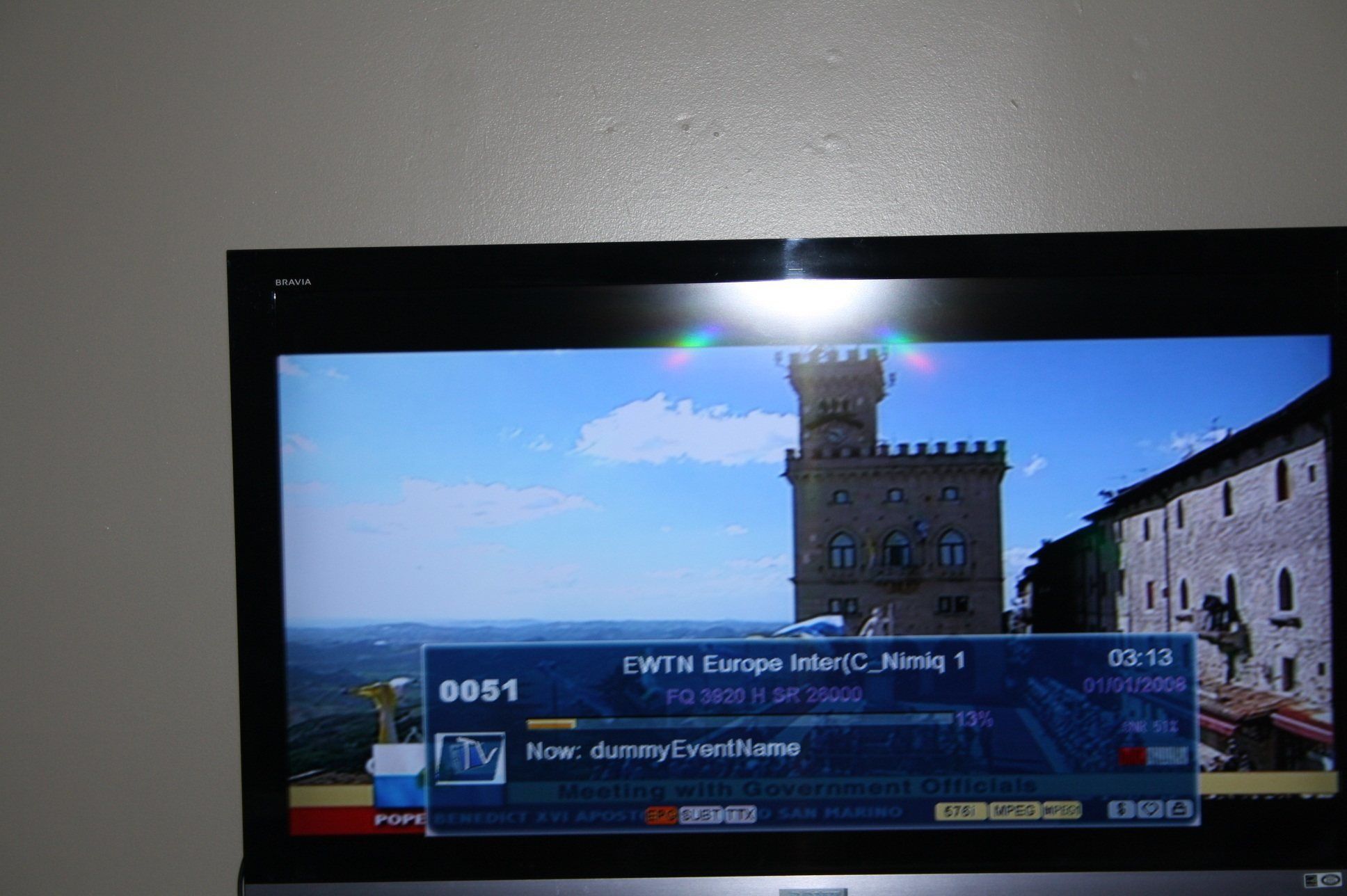

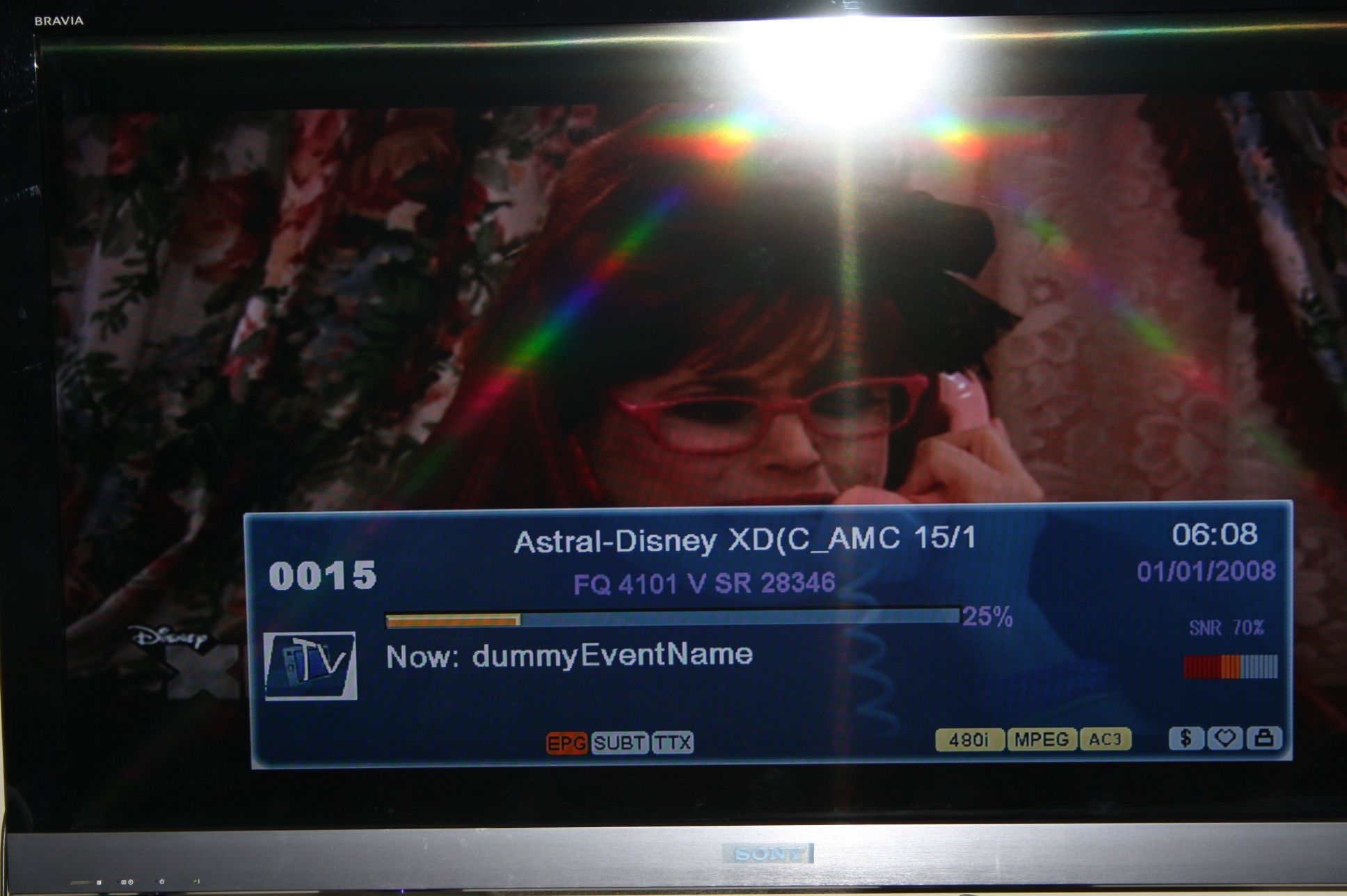

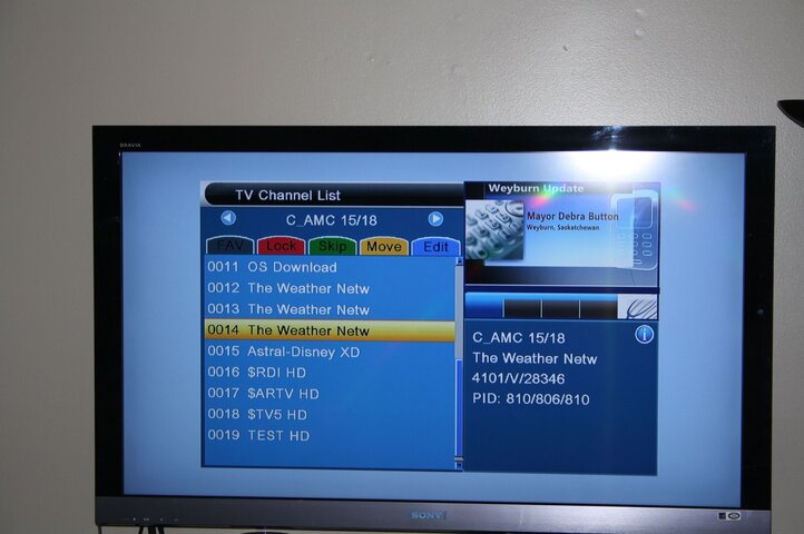

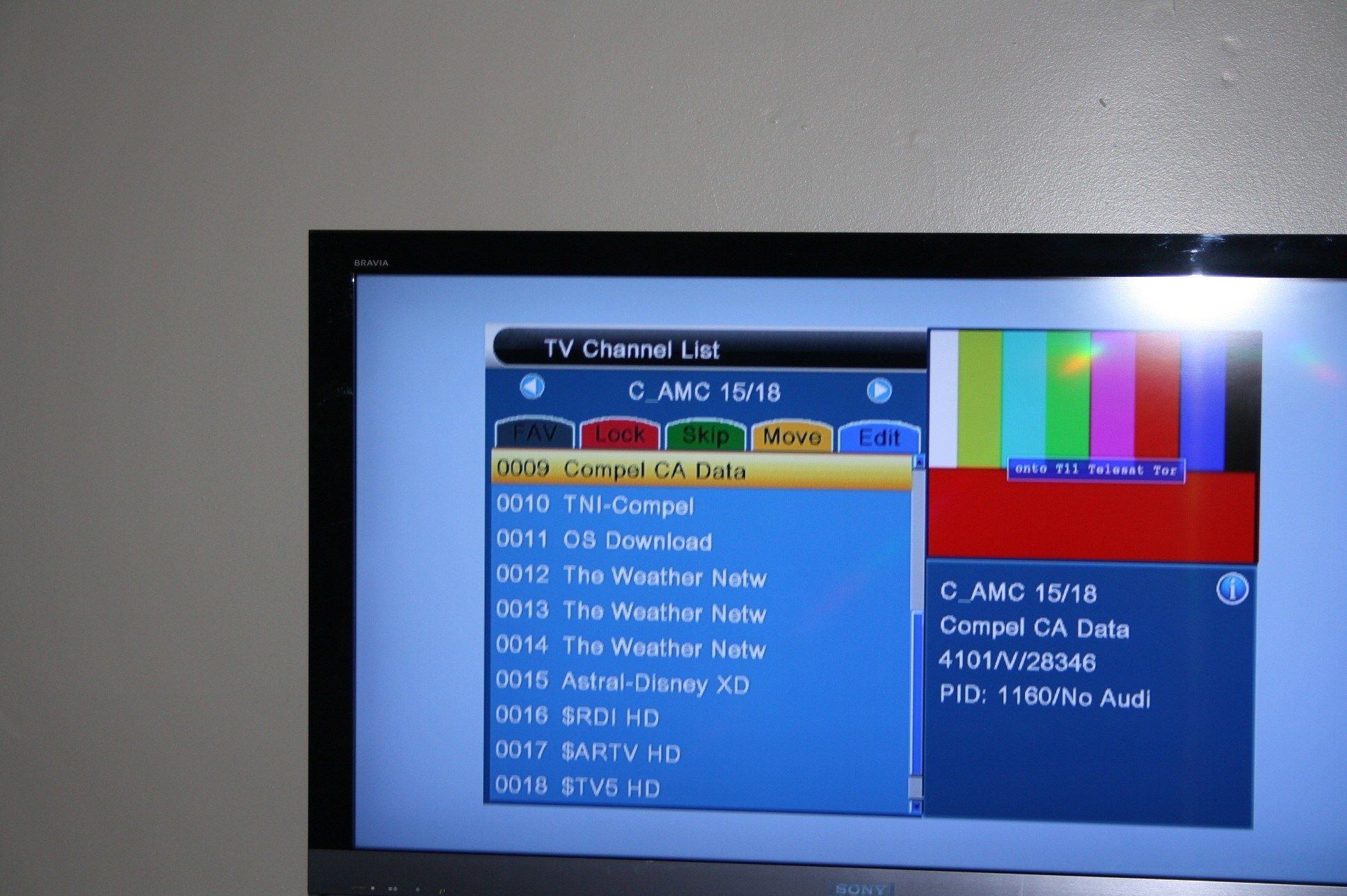

I know theres a AV sat support guy that hangs out here so i wanted to let him and all of you know that the switch from my winegard 1m to the geosat is finished and im really happy with the difference in results.
Here are a few pictures of my results :-)

lol true, im already thinking of a 2.4 but i have a small yard so maybe id have to settle for a 1.8m but im really happy with the results from the upgrade.

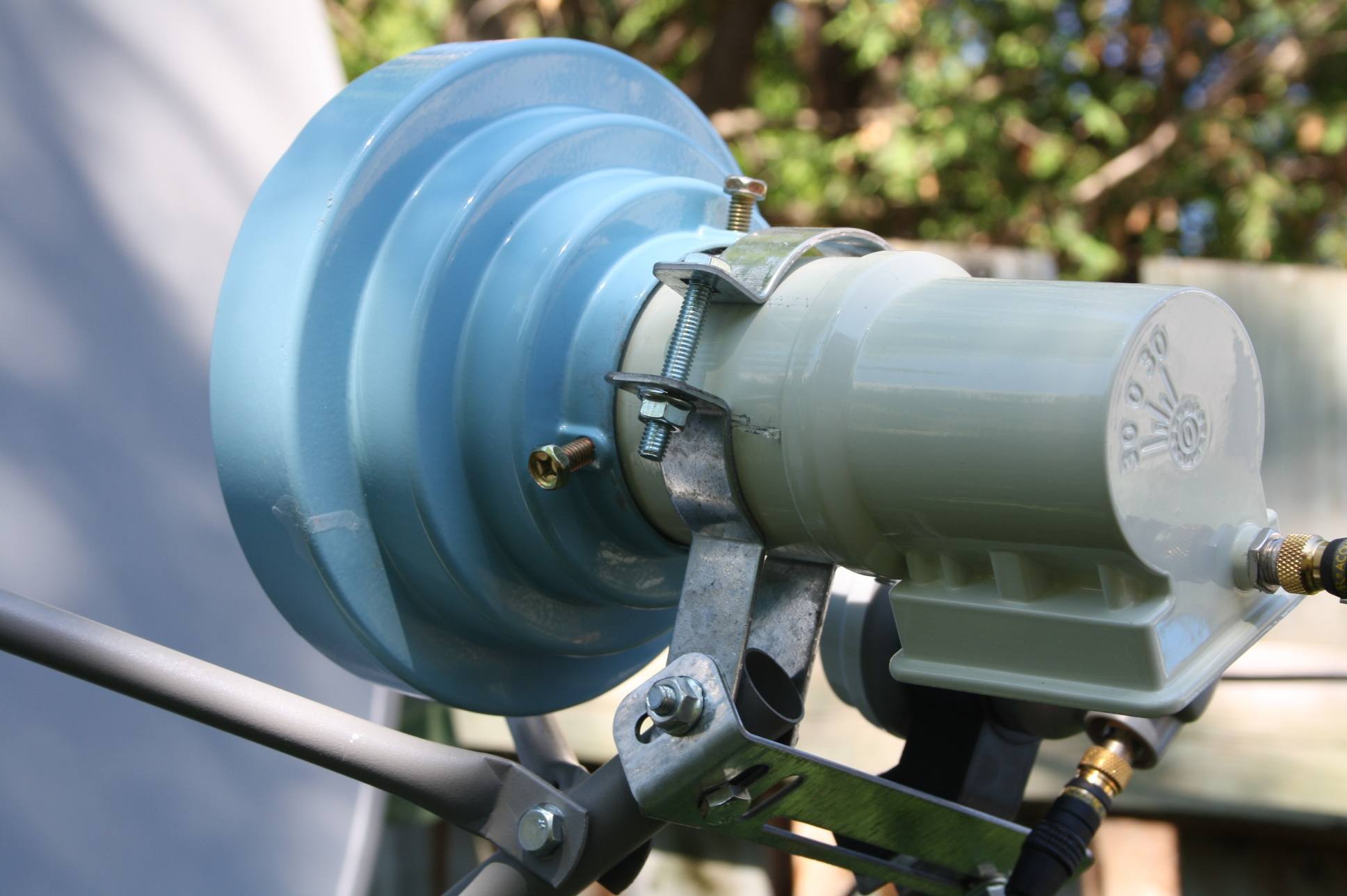

i got the best results after 3 days of testing with the lnb flush on the 1st step of the conical scalar ring. ive tried it at the edge of the lnb and i lost 10 to 12 % quality.
On tp 3720 on 91 was my main testing tp. the max i got with the flat scalar was 60% with the conical on the 1st step 72%

lol yes i read up allot on all the threads and i even tried that theory of the socket in the flat scalar and that did nothing hehe. at 1st i was not too impressed with the upgrade but it was after i moved the lnb up towards the dish that my results got better and then even more when i put the lnb at the 1st step of the conical.

Im using a sg2100 with the 50mm tube. i had to add two washers at the back, without the washers the u-bolts were too loose. i ordered a 55mm motor and i should get it this week, hopefully that will help allot. This dish is actually lighter then the winegard i had before so the motor doesnt have any issues moving it.
