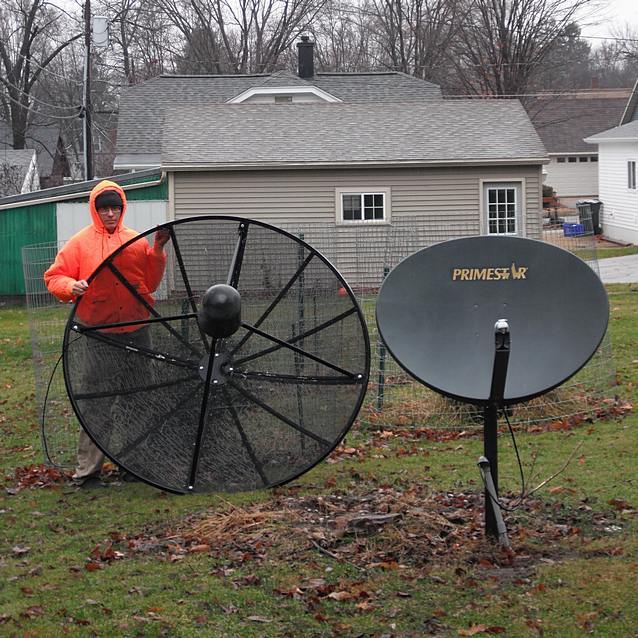

Do you know how tiny a 6' BUD really is ? Here's the Unimesh -- 5' 9" of nosy neighbor stealth glory. They'll pass out cigars when you put this dish up, think its a new baby you've got.
