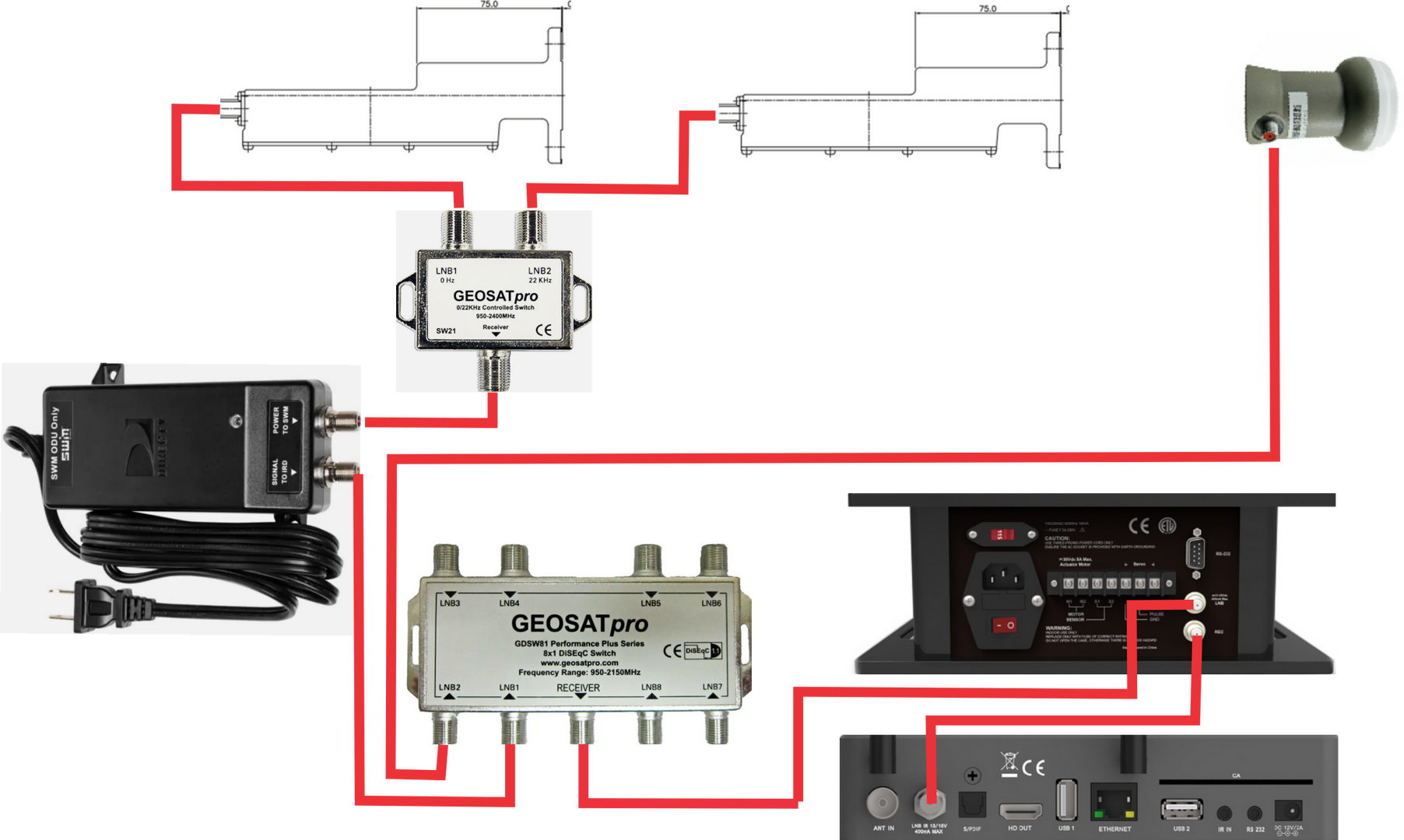

The power inserter I had in mind (from the pile) won't pass 22 kHz. So that's a wash.
Realizing that this and other omt/dual lnb threads have been here in the past. Wondering if any new tech. solutions are available and any recommendations for particular solutions. Good, reliable stuff that doesn't cost an arm and a gizzard.
The diagram was kind of how I'd like to do it. Nice and neat w/o out having to dig and stuff bolted on the dish with 47 unused ports.
Help?
So you will be building two satellite listings for each satellite? Since each satellite position in the list supports one LNB profile, 22KHz switch is only controlled by profile or LO switching. The above diagram would require one satellite for horizontal and a 2nd satellite for vertical. For example: your satellite list might be SES3 Horizontal and SES3 Vertical.
Sure would be easier to mod a switch!
The dirty mod thing doesn't really show detail. But is intriguing.
So using the Geosat 8X1 (I always called it a 1X8....my bad). I need to send a constant 18-20 VDC down the coax to a 22kHz switch. Pretty much what I'm trying to do with the power inserter. Then the other coax hooked to the ku lnbf.
I only have two runs of coax out to the dish mind you.

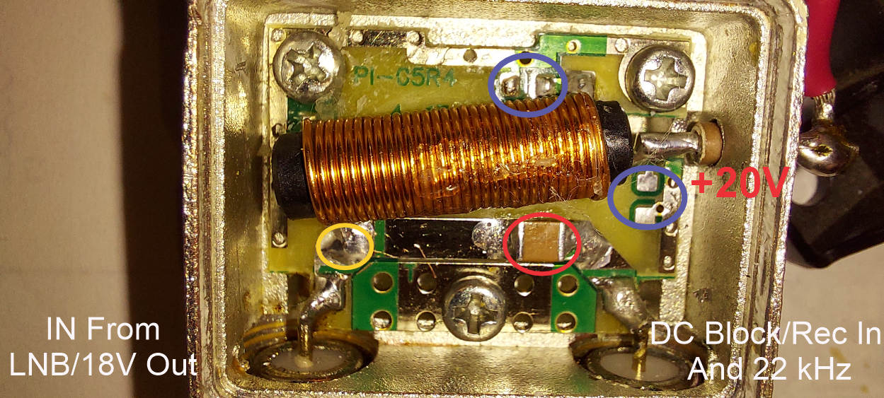

Is it proven that the tone will get to the 22 kHz switch at the end?
Now. I'm seeing power inserters that state that they do pass the tone.
Out of curiosity I popped the cover off of the bias tee. I guess a picture would be better. Back in a moment.....
...flash. Back.
So initially the bias tee blocked 22 kHz out to the switch on the 18 V side. Lifted the inductor (yellow) and measured through the cap in red.
Still was blocked so increased the cap to a 100 nf.
That passed the tone through to the lnb port.
Soldered the inductor down. Lost the tone. So lifted the inductor at the other side. Got it back.
Removed one cap in blue, inductor soldered back. No tone.
Pulled the other cap. Now I got tone.
Soldered the psu back to the feed through and ground. Lost tone.

I use the 13/18v from my FTA receiver for controlling C/Ku. Therefore all my C satellites are H, and all Ku satellites are V. When I blind scan, I do each satellite twice, each with the polarity turned manually by the analog box. Just channel up or down one to flip the polarity, no big deal.
The coax from the FTA box goes to an Eagle Aspen 13/18v multi switch. Got a few of them from a box of DIRECTV stuff in a roadside pile.
At the dish side of the switch, I put voltage block couplers. This lets the 13/18v run the switch, and the 18v run the LNBs, without interfering.
And that is my intention. Firstly using the directv 20V power supply/inserter to inject voltage to the pair of norsat lnb's with a tone switch.
The whole intention is to keep current load off of the receiver or ASC-1 lnb power circuitry.
Then each coax goes to a basic splitter before going out to the dish. The 3rd leg of each splitter goes to the analog box, to send the 18v to each LNB.
The splitters I have are all non power pass. And I continuously read. And know. That unless specially constructed. As is such for broadband/catv splitters that divide rf unequally.. Each port of a 2-way splitter attenuates the signal 3dB.
And also common sense and every single post here and elsewhere states never use a splitter in a fta setup.

With just the dtv power inserter connected. Again. Firstly on my bench and injecting a 22kHz sine, square wave signal.
The tone passes the DC blocking capacitor and into port 1 (0 Volts) of the unpowered tone switch.
When I plug in the power inserter/suppply. All 22kHz disappears. Past the bias tee DC blocking capacitor. Out the lnb port. And then of course no tone at either switch ports. But there is 20 VDc at port 1.
It didn't 'hear' a tone. And hence did not switch.

Doing my homework a few things come to mind. With the diseqc packets and tone riding on 18 volts from the receiver/ASC-1. Is 20 volts out of the bias tee 'swamping' the multiplexed -in- port signal?
Secondly. Wondering if I bench just the bias tee and hook up a lab supply to it. If slowly ramping up the voltage with everything past the switch hooked up. Will I get tone with a variable voltage up to 18 VDC. And past that start losing it? Doesn't make sense really. It's a FTA-WTF situation.
Thirdly. A few. EB over legit included. Mentioned that both ports of the tone switch get juice and only the RF signal was passed when switched.

How do I get two Norsat lnb's fed with around 20 VDC and a ku lnb to that switches with 13/18 volts over two coax lines with my OsMio4k?
As mentioned. I have an 8X1 diseqc switch that has worked flawless. My diagram above shows the concept method. Remove the DirecTV power inserter and ortho. Replace with my now defunct C2-W. And it just worked.
The DTV power inserter killed all 22 kHz going out to the dish. Google. Bias Tee low pass filter calculators. Try out different component values. Swap them out in the DTV bias tee. Inject a 22 kHz sine/square wave signal of different levels. With a 22 KHz switch on the input port (to lnb) and the Norsat's on the lnb ports of the tone switch. Feed the bias tee 20 VDC. So all impedance values are hopefully matched.
Nothing. No 22 kHz passes the bias tee isolation capacitor. And the filter design apparently not rejecting the tone. And diverting it to the lnb port.

So a bias Tee is the answer. Plus the added benefit that a capacitor isolates a 'zap' like killed my C2-W and still on the bench, in queue 'other' dead ASC1.
