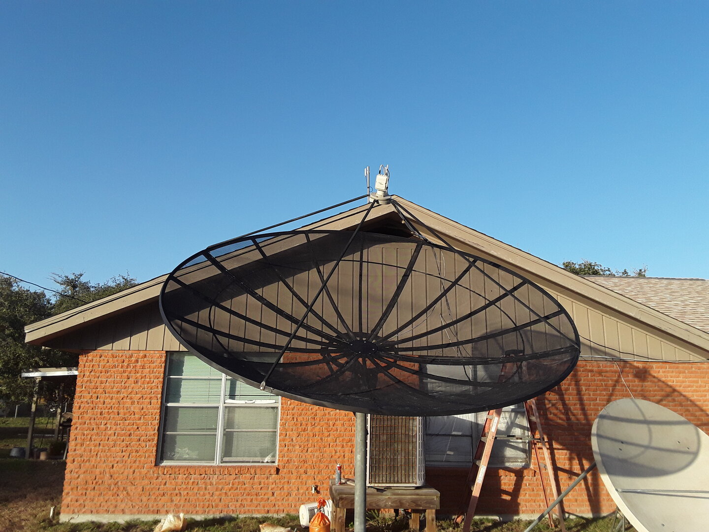

Ok on my 10 ft c and dish ,titainium c238 lnb in searching for sats I am locked on 105 west , scanned and verify transponders to be 105w ,82%quality but I also have 80% on 101 ,105,123,131 without moving dish ,try to set dish to 101 position and only get 12% , can't find any other sats to lock ,went back check plum was ok couldn't find 97 which is true south sat last week all was good 95w to 135w ,2 days trying, frustration set in ,watching 105w only sat that locked , HELP.
What kind of mount? Got a picture of it?
Does pulling or pushing on the bottom of the dish rim make signal stronger when the azimuth is centered for highest signal?
Reactions: (((Garyd)))
What type of dish do you have, show me some pictures front, side, and back of the dish also did you try by-passing the coax cable with another cable, they can go bad for many reasons??? I have even seen a tree dropped near the ground where the cable went the pressure of the earth could chance the 75 ohm impedance to anything else and your signal is bad
Channel master polar mount I track manually with a drill ,forgot to add that ichanged lnb from a c138 to c238 that's the only thinall was fine beforeg been done ,to answer your question no , all was good before that .

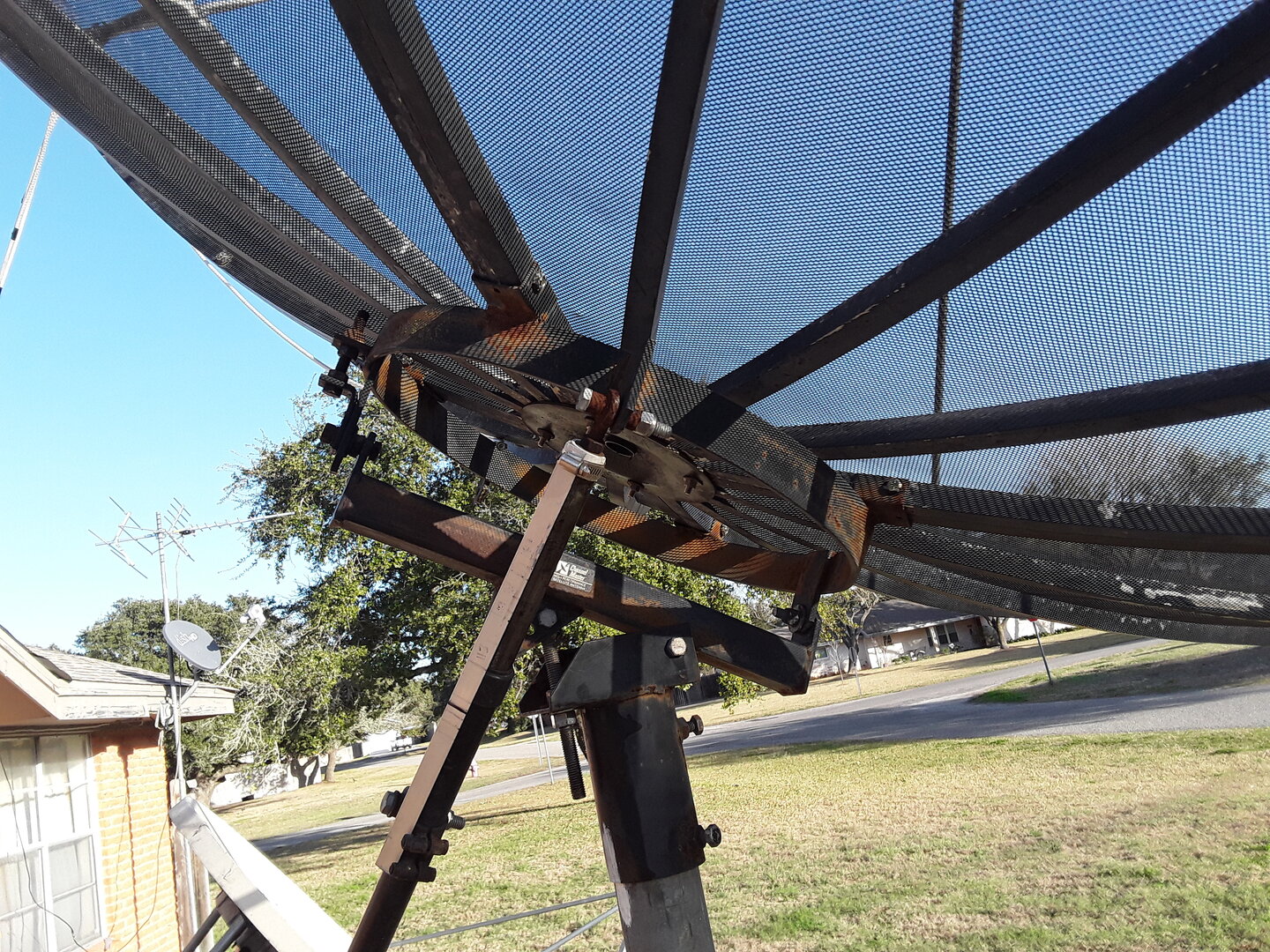

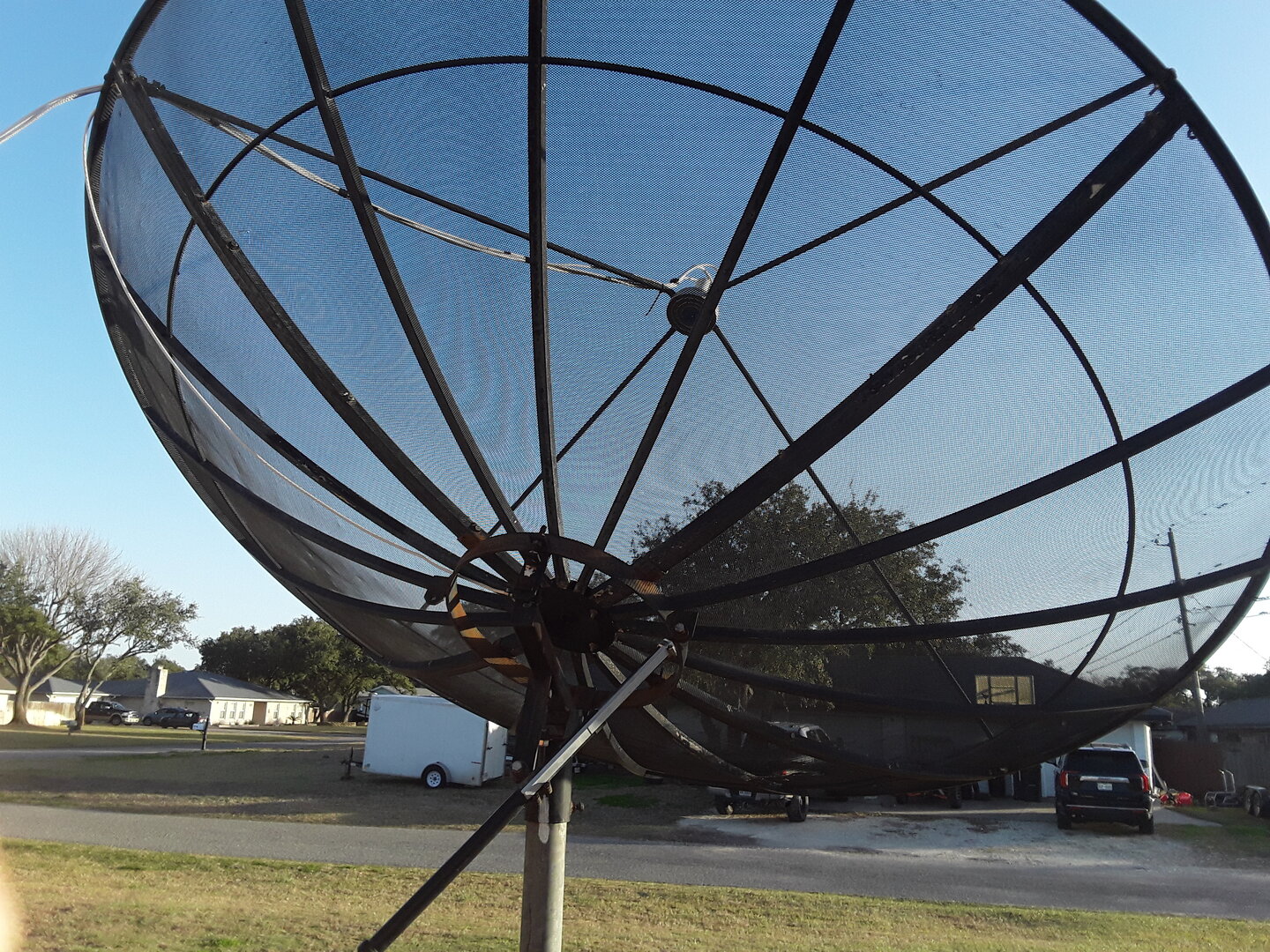

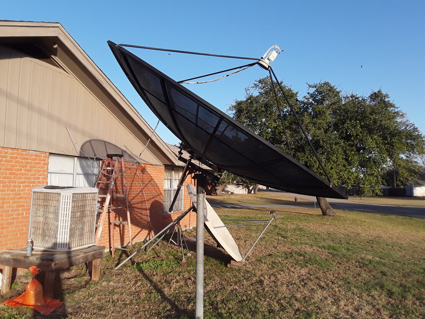

All new quad4 cables lnb hooked to TV and other cable hooked to v7 sat finder to check at dish ,can't get why 105 is right where it should be ami can't lock anyother sats ,

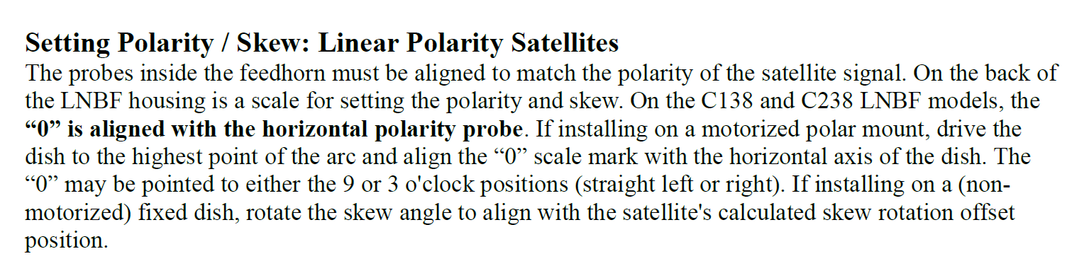

One quick question on skew on titainium c238 is the zero up or left or right ,I have o pointed to the right. ?
Read this, and it'll tell you: https://www.titaniumsatellite.com/downloads/Guides/C138_C238_LNBF_Install_Guide.pdf
Setting Polarity / Skew: Linear Polarity Satellites
The probes inside the feedhorn must be aligned to match the polarity of the satellite signal. On the back of
the LNBF housing is a scale for setting the polarity and skew. On the C138 and C238 LNBF models, the
"0" is aligned with the horizontal polarity probe
. If installing on a motorized polar mount, drive the
dish to the highest point of the arc and align the "0" scale mark with the horizontal axis of the dish. The
"0" may be pointed to either the 9 or 3 o'clock positions (straight left or right). If installing on a (non-
motorized) fixed dish, rotate the skew angle to align with the satellite's calculated skew rotation offset
position
I would suggest to take that DeWalt and drive the dish to the top of the arc.
Make sure the 0 on the lnbf is pointing straight up.
Then find a sat with decent signal and tweak the lnbf in/out of the mount.
If you need to tweak skew for a good signal balance for H/V polarities, do it.
Then pick a weaker sat and tweak the lnb in/out for max signal without turning the skew angle.
And still on the weak sat. do the bottom dish rim push/pull trik to see if the mount needs a bit of adjustment.
Oops. My bad......
Like Primestar says. Guess things changed.

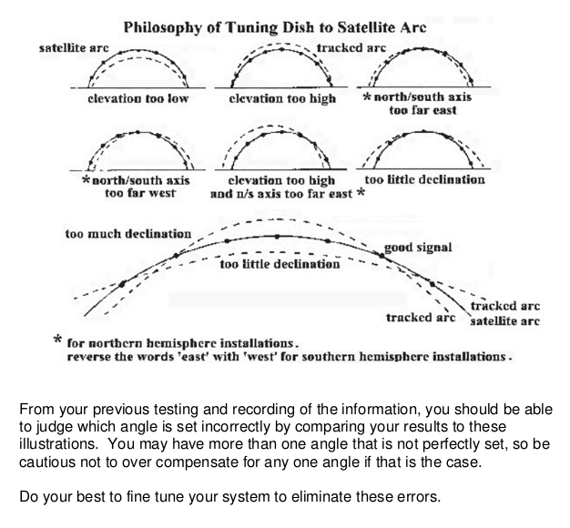

Did you recently have a storm? it could be that the dish mount rotated a bit on the post and the satellites closest to your longitude would still be somewhat ok and those further away would no longer be received. The test suggested by our friend Arlo (gently pushing pulling on the bottom rim of the dish and watch what it does to signal quality) would be the first thing to try. If it decreases either way, it means the mount is properly aligned. If it increases on way and decreases the other way, the alignment is not right. The attached picture is worth a thousand words...
