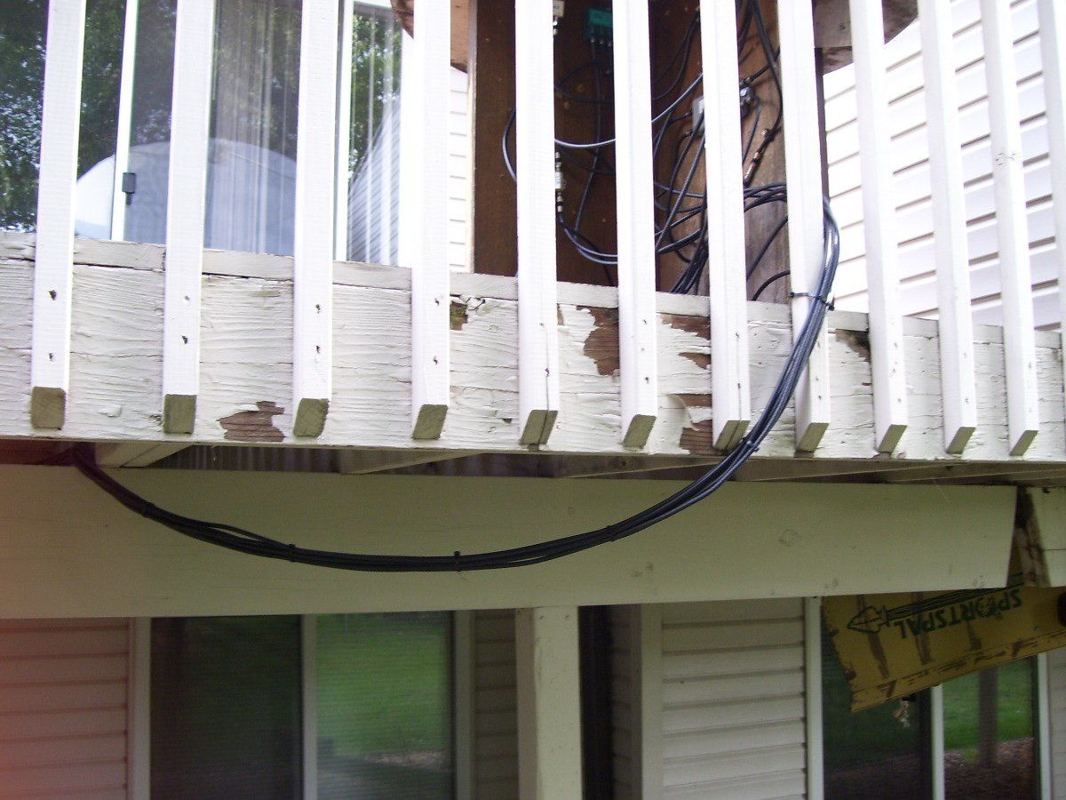

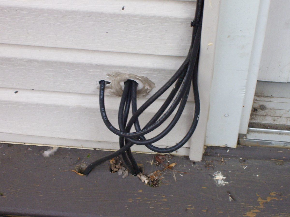

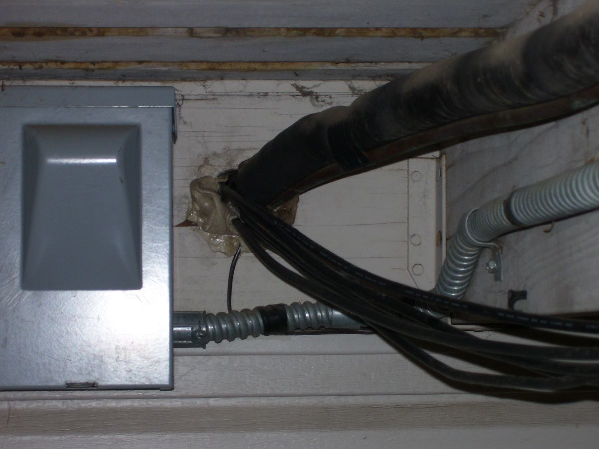

Here are mine.....4 into the house (off the roof) and the other 8 or 9 under the deck through the A/C pipe hole

Mind Is Like Pic #1 With Each Cable Going Thru A Hole The Reason I Am saying It Looks Bad It Is On The Front Porch 6 ft To Right Of Front Door.
You could put flex loom around it. Still might not look the greatest where it's located but, it would clean it up some.
Not sure exactly where to get them but I'm sure you could find them online somewhere.. the gray cable boxes like the cable company uses. Or even the pvc type outside square boxes for electrical that have a gasket/lid with 4 screws, one in each corner.
Or like pop said, just get a nice planter and some flowers or plant.
