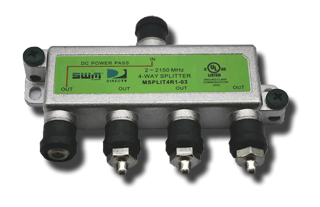

Trying to help my neighbor out here and need some help. Current setup is the single line swm dish. The dish is located on his garage and the single cable comes into the house and plugs into the power pack which then feeds into the dtv splitter which all the receivers connect to. No genies, just regular hd and hd dvr receivers. Now he wants to add a receiver in the garage. So is it possible to somehow split the signal before it goes to the house to add a receiver in the garage or is the best way just to add another dish on garage just for that tv? If it's possible, what equipment is needed? Another power pack, special splitter, etc??? Thanks for any info, just trying to avoid installing another dish for the tv in the garage. I do not want to bury another cable back to the house. Thanks
Sounds like he has SWiM install. You just need the green splitter. The side with the two jacks should have one that is red. Make the red goes to the existing wiring to the house. And the non-red to the garage.

Is it only 1 recvr in the house and you want one in the garage ?
IF so, you could get by with a splitter at the dish/garage ... but the current coax has to go to.the red side of the splitter back to the house.
Also, you do not want a 2nd Power insert or in the set up.

What about placing the SWM at the Garage with a 2 way splitter. Connect the garage unit to the line from the splitter, connect the line from the house to the other side of the splitter. Depending on distance from house to garage would be the only biggest concern.
Thats pretty much what I suggested, except that won't work because he's got about 4-5 recvrs in the house and doesn't want to run anymore lines from the dish to the house.
My solution would work had there only been 1 recvr in the house ... we didn't have any idea how many were there when I posted.

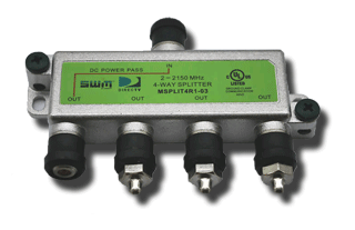

He will only have 3 in the house he said. The 4th he is moving to the garage. This is the splitter has in the house, along with the power pack thing.
Here is a drawing of what he has going on. Is it possible to hook up his receiver in garage without running a cable back to the splitter in the house or adding a 2nd dish on garage. If so, what does he need?
