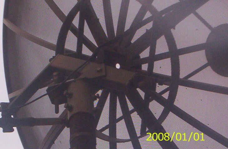

I have a C band satellite in my back yard that has been use in along time. The receiver for the C band was damage and was thrown away. And I was about to buy a FTA receiver, then I wonder if it would work with my C band. I want to be able to see live soccer matches from all over the world, or at least some.lol. If its possible, will it be affected by the 2009 change? What receiver FTA receiver would work for this that under $150.00.

Yes... you can use that BUD with FTA...
Pansat 3500 have the hardware to control
the servo motor 3-wires and the menus has
option to setup skew per transponder...
nice unit...
For C-Band ... only thing to set is LNB frequency 5150
sat-info C-birds are already preset to this value
You will need the positioner to move that dish/actuator
there are various options...
VBox II (?) ... VBox III (?) ... GBox 3000 (?)
Have tested this configuration...
it works... no problems at all

hmm a east ( or left side) mounted motor :)

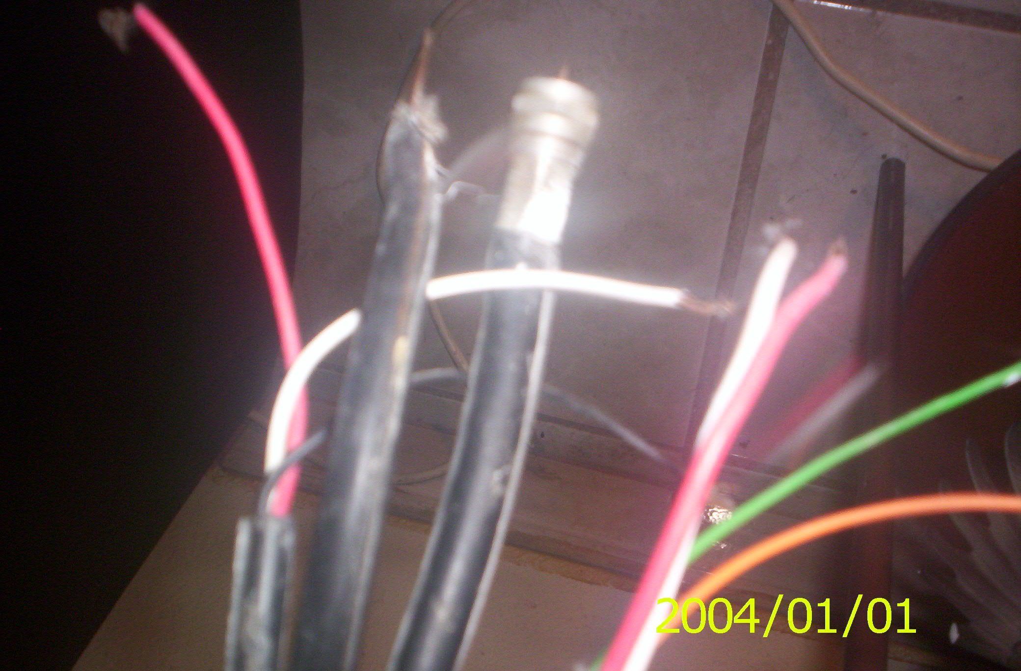

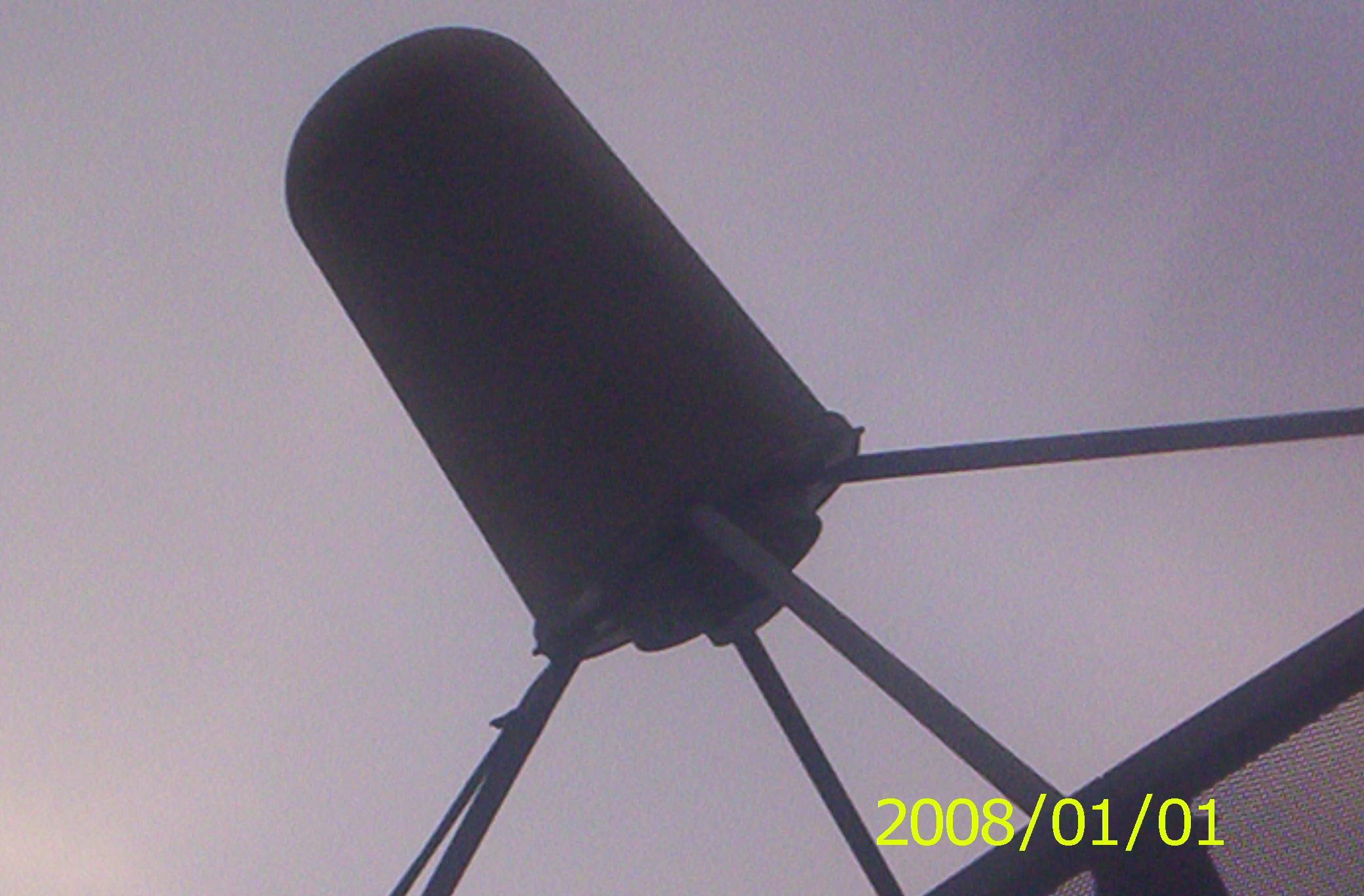

everything mentioned is correct ... i love c-band FTA ....would help to know what type of lnbf is it c or c /ku ..... the photo showed the standard coax ribbon cable first set of wires is for the servo on a corotor type feedhorn, second two sets of wires are coax last set of wires is for the actuator

Your lnb or lnbf (which ever your dish has) may need upgraded. Motor actuator that moves the dish may be seized from years of non-use.

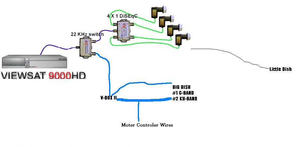

I've been using my viewsat 9000hd to get the free to air channels with a small dish with 4 circular lnbs because the dish was laying around lol and didn't know I needed the v-box for my big dish. Before I buy the v-box I was just wondering which one to buy and what else i would need to have both the small dish and big dish hooked to it. I made a picture of the setup and was wondering if anyone could tell me if it will work.
