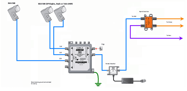

My current setup is two 30" Winegard dishes with Dish Pro LNBs, one pointed at 61.5 and the other pointed at 72.7 (I think). Both connect to a DP44 which then connects to the Hopper. I think it is a hopper2, but I'm not sure.
I'm thinking about upgrading to the Hopper3 for the 16 tuner capability, but I can't find out any info on the new "pro hybrid" LNBs, and if it is possible to install them on my dishes. I assume this will also require replacing the DP44 as well.

You can use your existing dishes with 42 switch.
I know the diagram shows Western arc, but eastern arc works the same way
