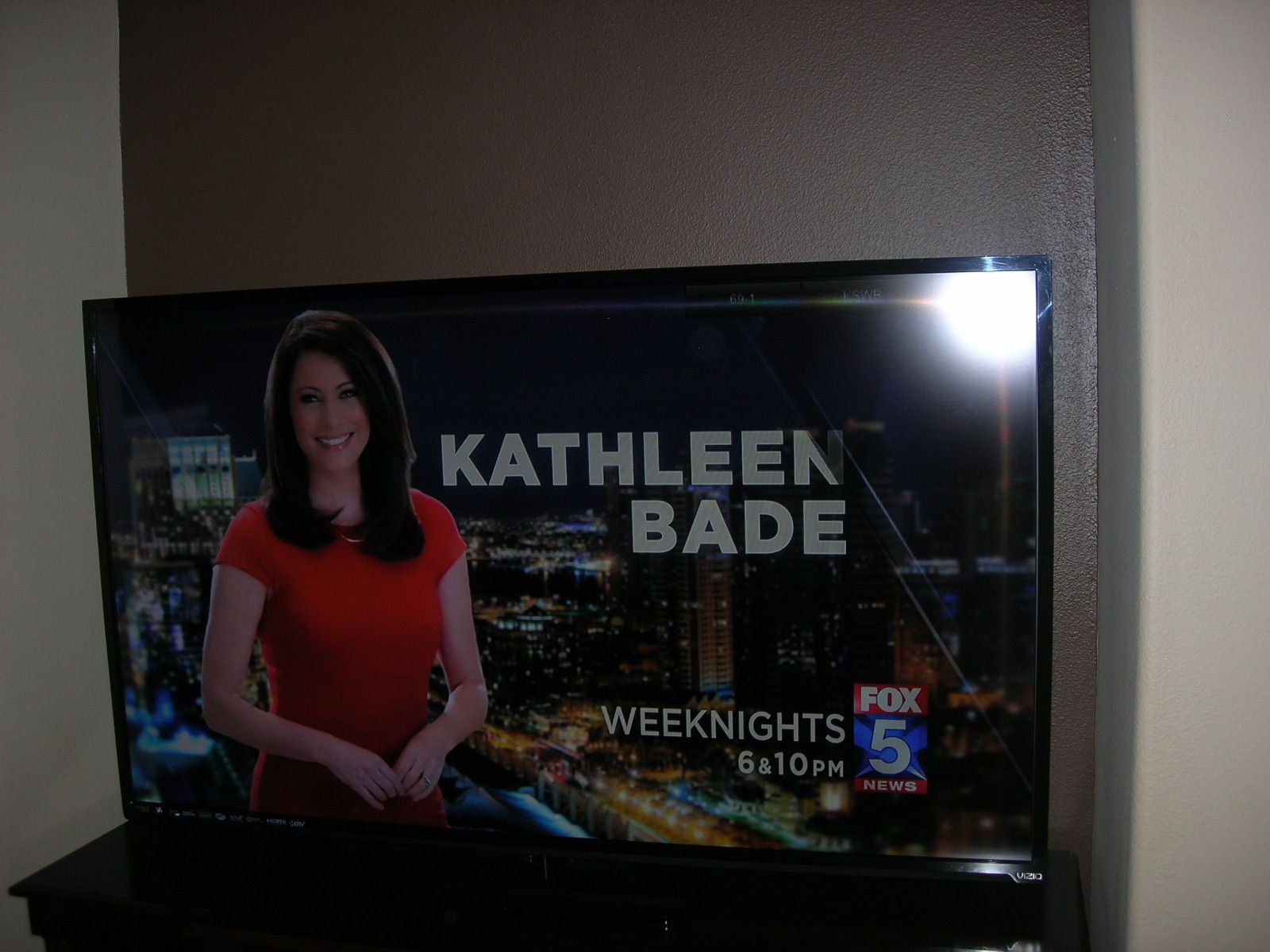

Update again, picked up the MCM 30-2155 antenna and aimed it to SD, and I now have 39.1,39.2, 69.1, 69.2, 69.3 .....39.1 is NBC and 69.1 is fox, and there is cozi, antenna tv and THIS tv. While I dont watch the last 3much, like the fact that I have nbc and fox from SD, and ABC and kcal9 from LA. Also have 24.1-4 PBS and affliates. Missing CBS but overall not too shabby.

There is something cool about watching the news from 110 miles away :) The 2300 feet of elevation at my location and my street sloping significantly gives me a good path to the SD signal. Amazing. I think that 2155 really is a very good antenna. Performs well.

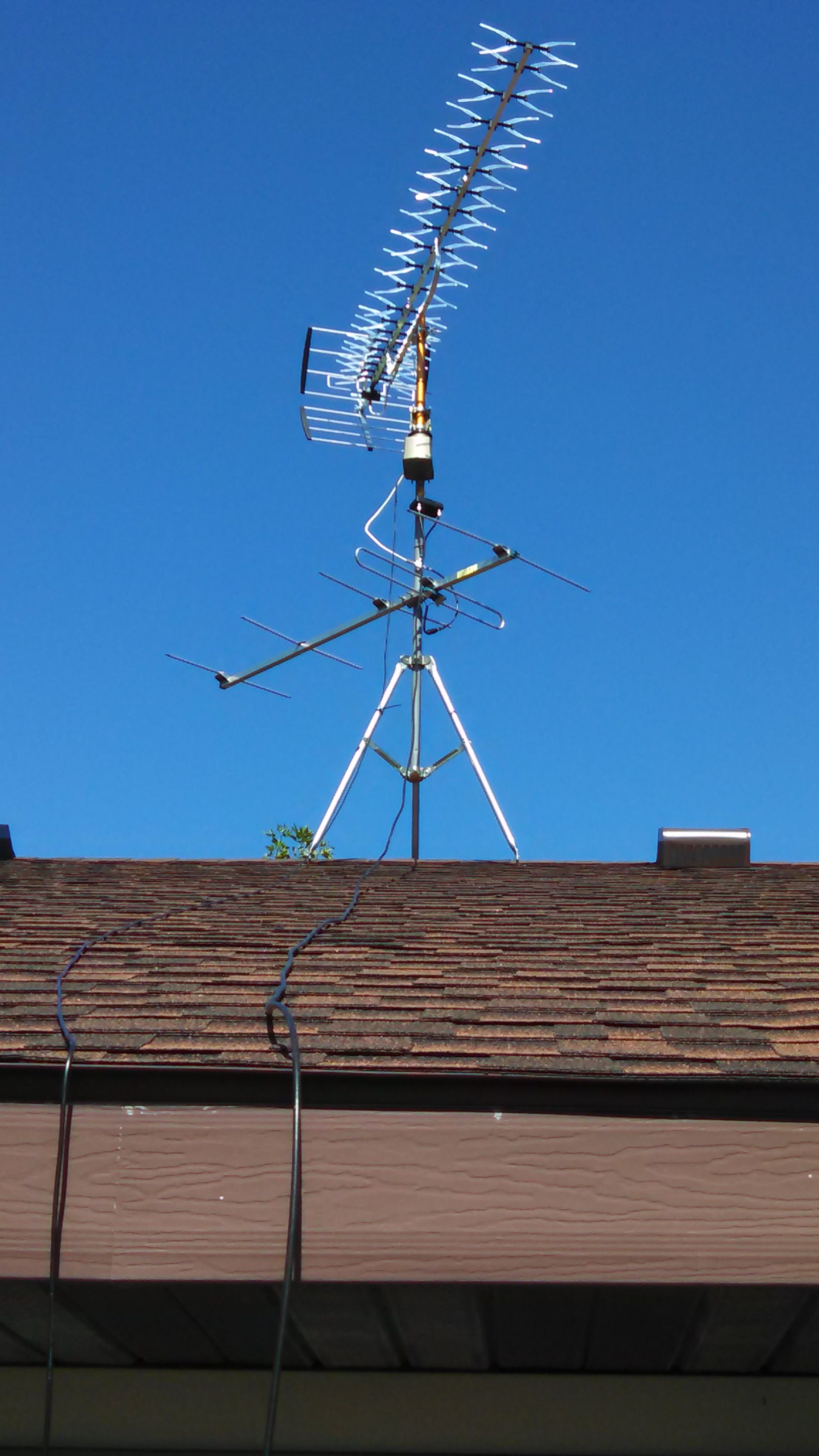

Here is one of the pics. As you can see (if you blow the pic up) below the amp is the combiner. The output of the combiner went into the amp.

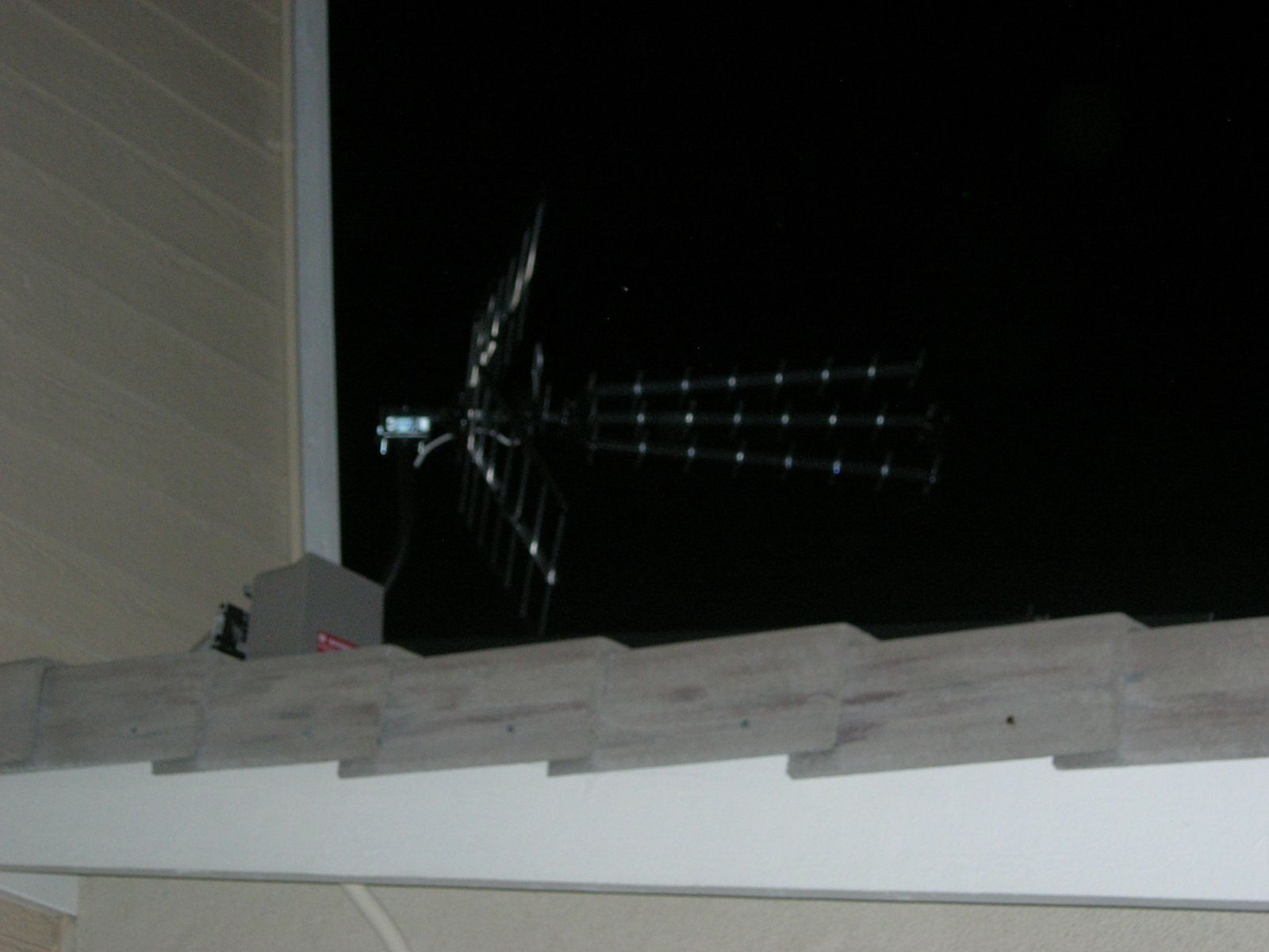

My 2 antenna setup is working OK, I reliably have 7.1-3 and 9.1 (100% of the time) on my VHF antenna - nothing else comes on this to my surprise.....my UHF antenna aimed at San Diego towers 107 miles away is iffy.....
recently lost 39.1 39.2 but still have 69.1-2-3 (with occasional pixelation and dropout)/ Also 15.1-4 seem to be coming in now......realigning the San Diego antenna does not make a difference......
This is the antenna aimed at SD currently.......
http://www.mcmelectronics.com/product/STELLAR-LABS-30-2155-/30-2155
I would like to swap it with something else.......
Place where it is mounted is limited, so I can replace it with this but in the attic
http://www.mcmelectronics.com/product/30-2415
or can try to mount this in the current location (outside the house)
http://www.mcmelectronics.com/product/STELLAR-LABS-30-2425-/30-2425
any suggestions ? should i try to add an amplifier somewhere ? not even sure where since I have a UHF VHF combiner
