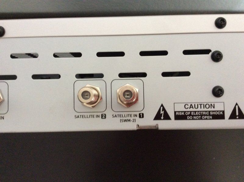

Yes, I believe the HR20s started the SWM technology, however, it was called something else and the back of your HR20 will have something on Sat port 1 (FRC or something like that)
This is what it says on the back of my old HR20-700.
FTM is what SWM started as, at least thats what was stamped on the HR20s ....
Never did find out what exactly it stood for, but it was short lived when the SWM came aboard.
FTM stood for frequency translation module. Which is what SWM does but maybe they liked the latter name which it was easy to pronounce since they could add the lowercase 'i' and call it SWiM.

By the way, I WAS able to reactivate my HR20's and after some interesting issues getting the HR20 to stop telling me it couldn't find a good signal on Sat Input 2 (yes, because there was NO CABLE hooked up to the Sat Input 2, the entire idea behind SWM, right???) I did finally get one of my HR20's up and running where the Genie had been before. No internet as the HR34 must have pulled it right off the Sat cable whereas the HR22 we still have up and running in another room had a DECA box hooked up which splits the signal back out into a Sat cable and an Ethernet cable??? If I am saying that right. But otherwise, we currently have TV up and running again on one of these HR20's and DTV did confirm that, yes, it is SWM compatible. I still have the second of two HR20's that I might or might not connect in place of my C31 Mini in another room that currently has no mothership to talk with. DTV happily activated both and deactivated my HR34 Genie and this one C31 Mini. They told me if I do decide to get a replacement for the Genie, that they would reactivate it just long enough for me and a support person to ensure that it's dead a second time. Then they would send me a replacement. Complicated but oh well.
Anyway, yes, HR20's are SWM compatible. thanks for all the help. Do see higher up where I've posted a related followup question about how I might proceed regarding replacing the Genie or maybe going with standalone, newer HD-DVR's, like HR24's??? See that just posted and beginning with the word "Followup"... thanks
