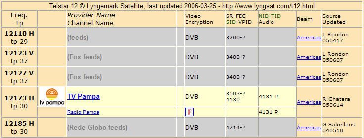

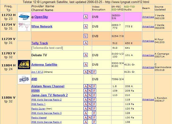

Hey Das , as for T12 unless your ready for a stationary dish pointed to it, it's probably not worth the effort.
Here are some screen shots of what up there on T12 according to Lyngsat , sure would be fun to get some of these channels.

I was really hoping to see what the Wine Network was all about. Hispasat is easy to hit, plus I'm getting Amazonas now too which was near the far eastern reaches of my big dish. Being at 84.5W I guess I can only get down to 24.5, which is where 905 is, but USALS only gets me down to 907. Too bad nothing there.

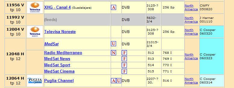

Since you have ventured onto the Atlantic Sats, have you tried PAS 3R at 43.1 west, you can find 4 italian channels which have been up for only a short time and some feeds from the televisa network Mexico .
Heres some live Tp and frequencies to make it easier for everyone. just click on the screenshot.
