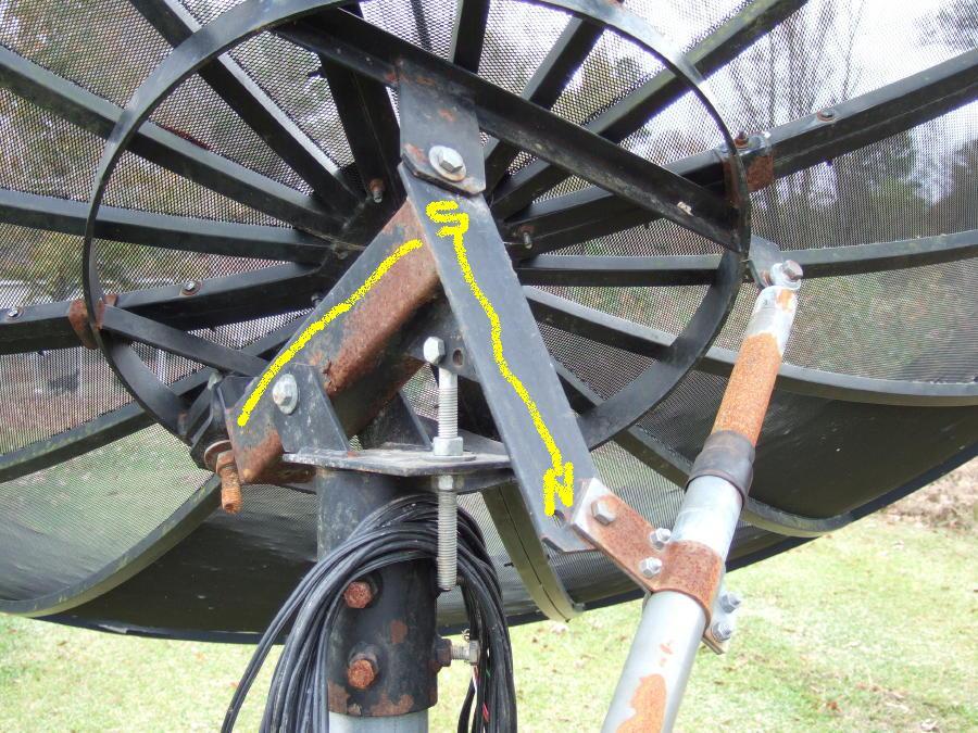

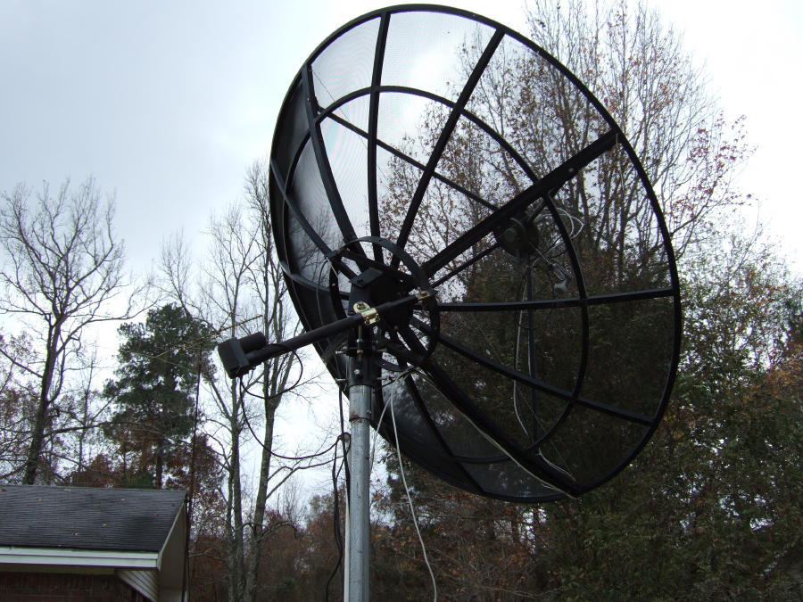

let me get a couple of pictures and point it out , cause it easy to confuse. the mount needs to point north south. the dish actually pivots on this mount so it can point anywhere i think you actually have it very close now if your getting a pic on F1
ok i was calling it a mount maybe a better name would be arm ( and its stationary) the dish mount moves on it this arm ( or axis of the dish it will pivot on this ) should face north south.
first pic shows the arm second picture shows dish pointing west ( at about Galaxy 15 @ 133) with the arm pointing south

Thanks for the great pics George, it turns out that I am also seening great signal levels on Galaxy 4R/C 99.0W? This would make more sense considering where the Dish is pointed. But just how is this possible to see great C Band levels of S and Q on 2 separate Satellites?? I've never seen that before?
what channels? you think they are from 99w & 107w . this is when you move the dish via motor right ?
Thanks George, No it was just when I moved the Dish with the 12 VDC Battery Charger to see and scan in what I could find. I think its 99.0W because there is lots of religious channels - Lesea Network, NBC Virgin Islands, GDMX is scrambled with some audio. Tp frequencies are: 3928, 3935, 3820, 4000, 3736, and 3820. S and Q on TP 3928 are S= 72 and Q = 87!! Will try to hookup the V-BOX III tomorrow and likely store 99.0W and try using this as my reference if that's how its done??
