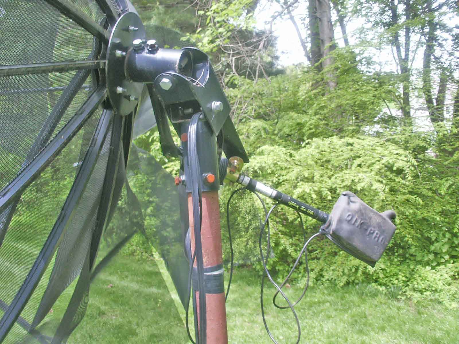

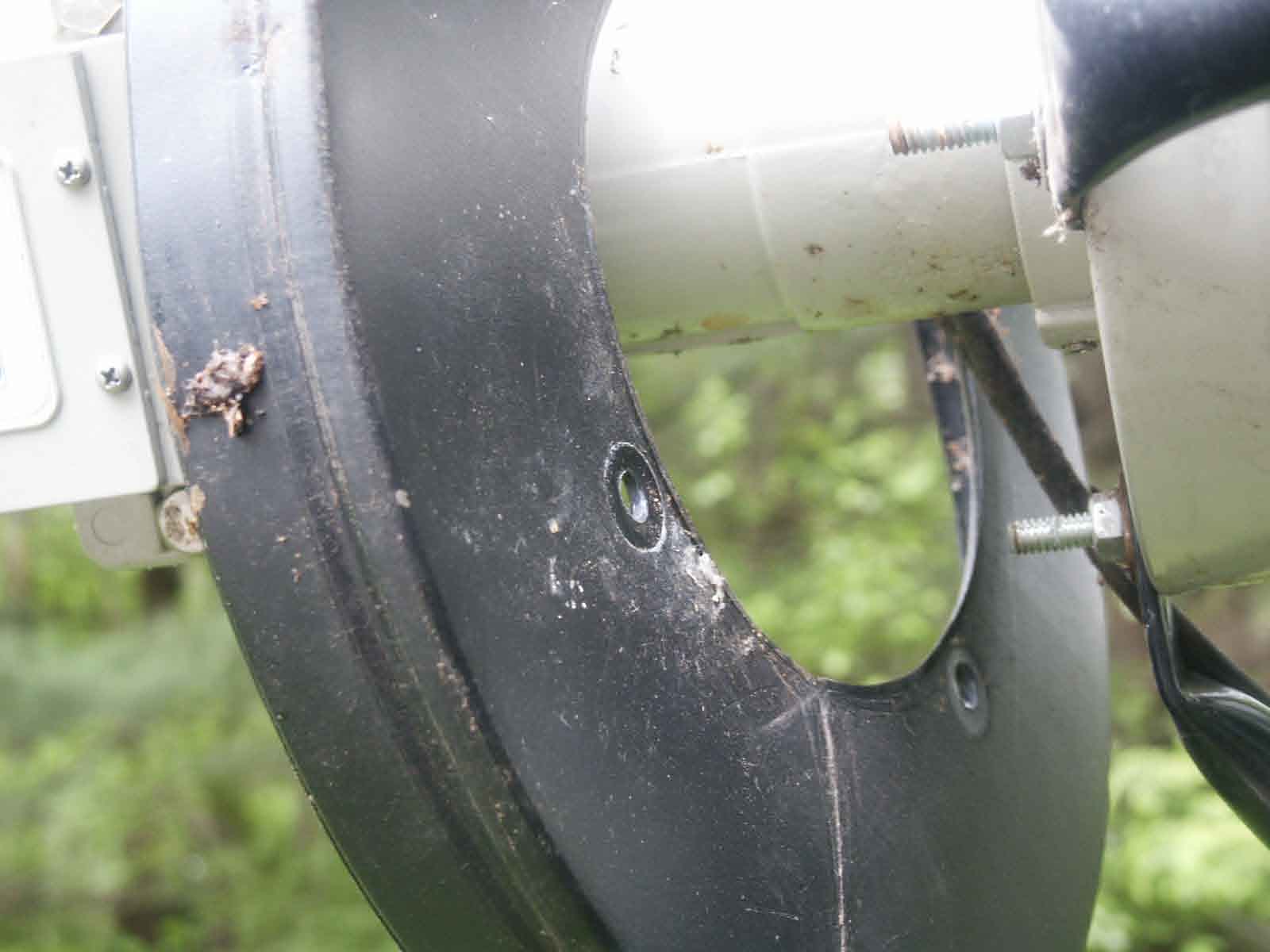

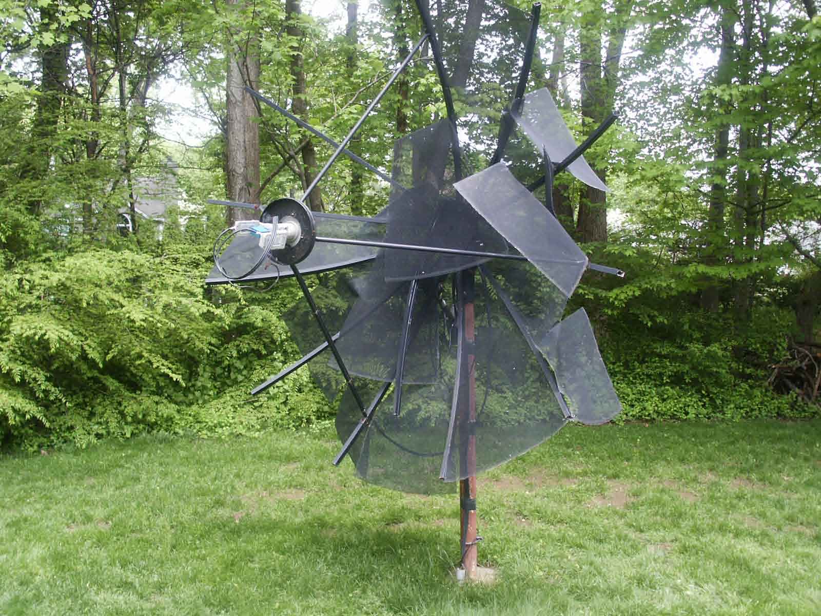

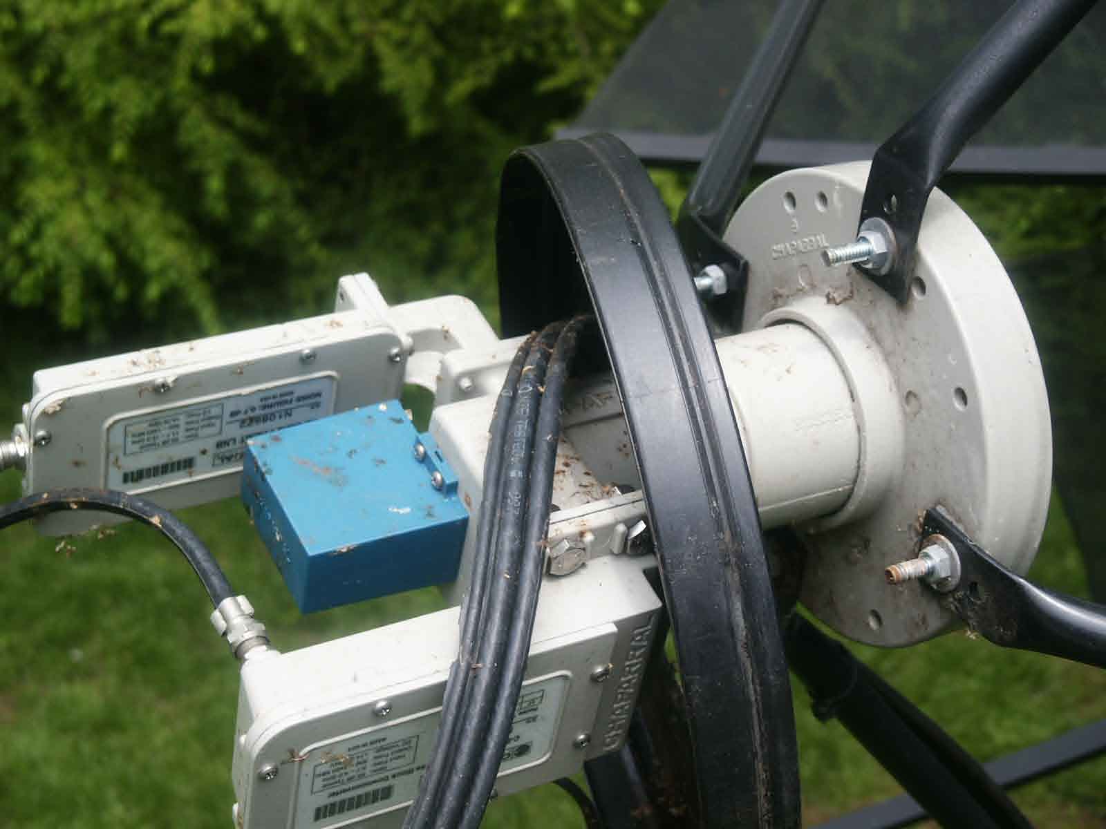

I am considering replacing my Orbitron S 8.5 mesh dish polar mount with a Fortec Star FS6D polar mount. Photos attached show (1) the current condition of the damaged mesh dish, (2) Chaparral CorotorPak (the original (1994), not series II), (3) base of the LNA Cover and (4) Current SuperJack II 18" actuator.
I installed this myself in 1995 so I am familiar with the process and have all of the original documentation but have the following questions:
1. Will I have any problem re-using the CorotorPak? The only difference I can see between the Orbitron and the Fortec is that the Orbitron has 4 Feedhorn supporting rods while the Fortec has only 3. The scalar ring on the CorotorPak has 12 holes so I assume it should work okay.
2. I plan to re-use a SuperJack II 18" actuator. Any problems doing that?
3. The base of the existing plastic LNA cover has 4 holes. I assume I can drill three new holes to match up with the Fortec and seal the other 4 holes to keep out the wasps.

I see no reason your existing scalar, feedhorn, and LNB shouldn't bolt right on.
I can't say for the LNB cover. Lots of guys run without.

edit: oh, yea, and as to the ugly, that old dish is sure in sad shape!
Thanks for the laugh. :)

I think the corotor you have should work fine. The 6' Fortec only has basic assembly instructions with it.
The actuator you have should work fine but for only a few bucks more you can buy the complete set up from Sadoun including the dish, actuator, Vbox positioner and CK1 LNBF.
The only issue you may have is the polar mount on the 6' Fortec takes a 3 1/4" pole. I am yet to see any that is 3 1/4. 3" inside is 3 1/2 od.

The LNB & Scaler ring will work fine on the 6 footer. I've used the older style LNB's on my 6 footer with no issues

It started with a tree limb and then, while I had it pointed down for repair, the lawn guy ran into it. The frame of the lawn mower hooked the Perimeter Edge Trim and he did a number on it. Had I pointed the dish back up in the air, he would have missed it.
OUCH! :eek: :(
The lawn guy has a sun shade on his mower and, while I did not witness it, I believe the sunshade caught the lower part of the dish as he drove under it.

That's where I normally park it but on this day I had it pointed at AMC7. I should have returned it to G19 before the lawn guy arrived but I did not. My bad. When it points to G19, he would drive right under it with no problem
