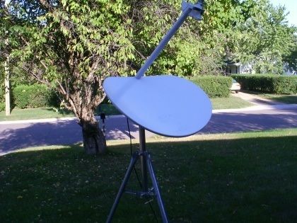

YES! I use two of them for FTA, I also have the double LNB, one is a dual DirecTV LNB and the other is a single KU band LNBF, so it can be used for both KU and DBS satellites, great signals from these DirecPC dish.
I use mine mainly for the extream ends of the Clarke Belt hence they are upside down, plus they look better that way : )
