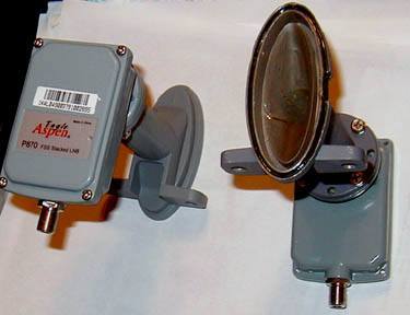

I also have one of the dishes, and am in the middle of outfitting it with a bandstacked LNB and a tall oval feedhorn.
The original LNB is missing, and the rectangular feed that came with it won't fit my LNB.
Dish is pretty heavy, so if you want to motorize (I'm not), ditch all that mount on the back side, and fabricate something.
Well documented on the forum, if you need ideas.
