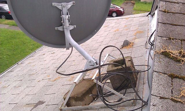

okay-- I did it! I got the dish up and I actually found the signal in less than 15 min., which was a record for me for 97W. Hooked up my Viewsat Max HD in one room + Viewsat Lite in the other room. Works great!! My dad was pretty adamant about drilling holes, so I found an old dish mount I had from my 'Charlie' days and used that, securing it with some cement blocks. Need to clean up the wiring mess, though.
