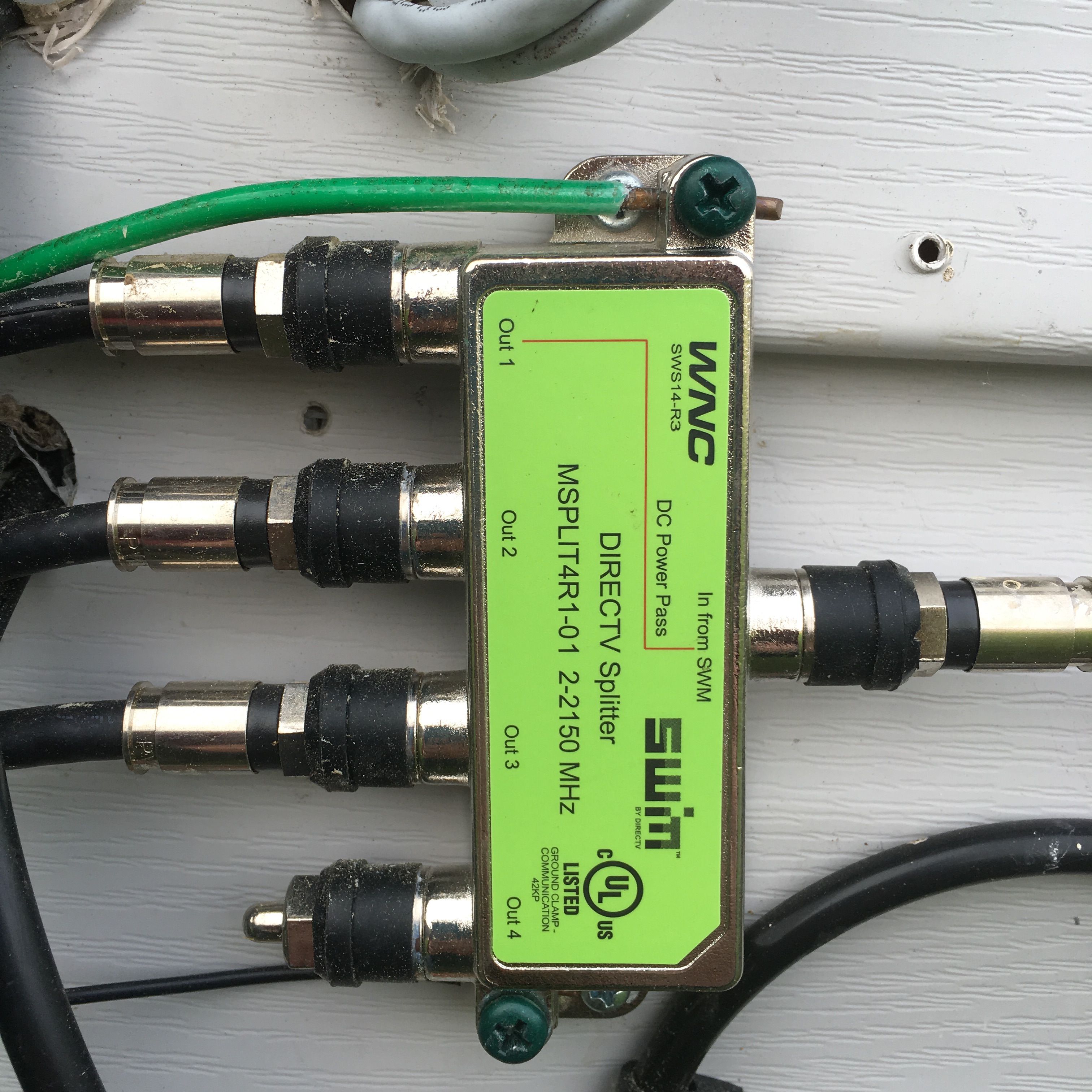

To the best of my knowledge, the only splitter is on the outside of the house (picture attached). The coax in the guest bedroom goes through a hole in the floor, across the crawl space, and out the opposite side of the house where the splitter is - right into the splitter. The coax in the master bedroom does the same, as far as I know - through a hole in the floor into the crawl space, and then out the side of the house to the splitter. The master bedroom is on the same side of the house as the splitter.

By looking at ur picture of the splitter u have one going to the 54 one going to the 61 and one going into another splitter feeding both h25's. If I was u I would have them run another line all the way to the splitter. Using two splitters is called the splitter trick and sometimes it doesn't work and sometimes it does.

It will always work if done correctly using proper splitters. Not saying you should do this but it will work. My bet is unapproved or faulty splitter inside. If you have 4 tvs and only 3 lines outside basic math says you have at least one more splitter somewhere.

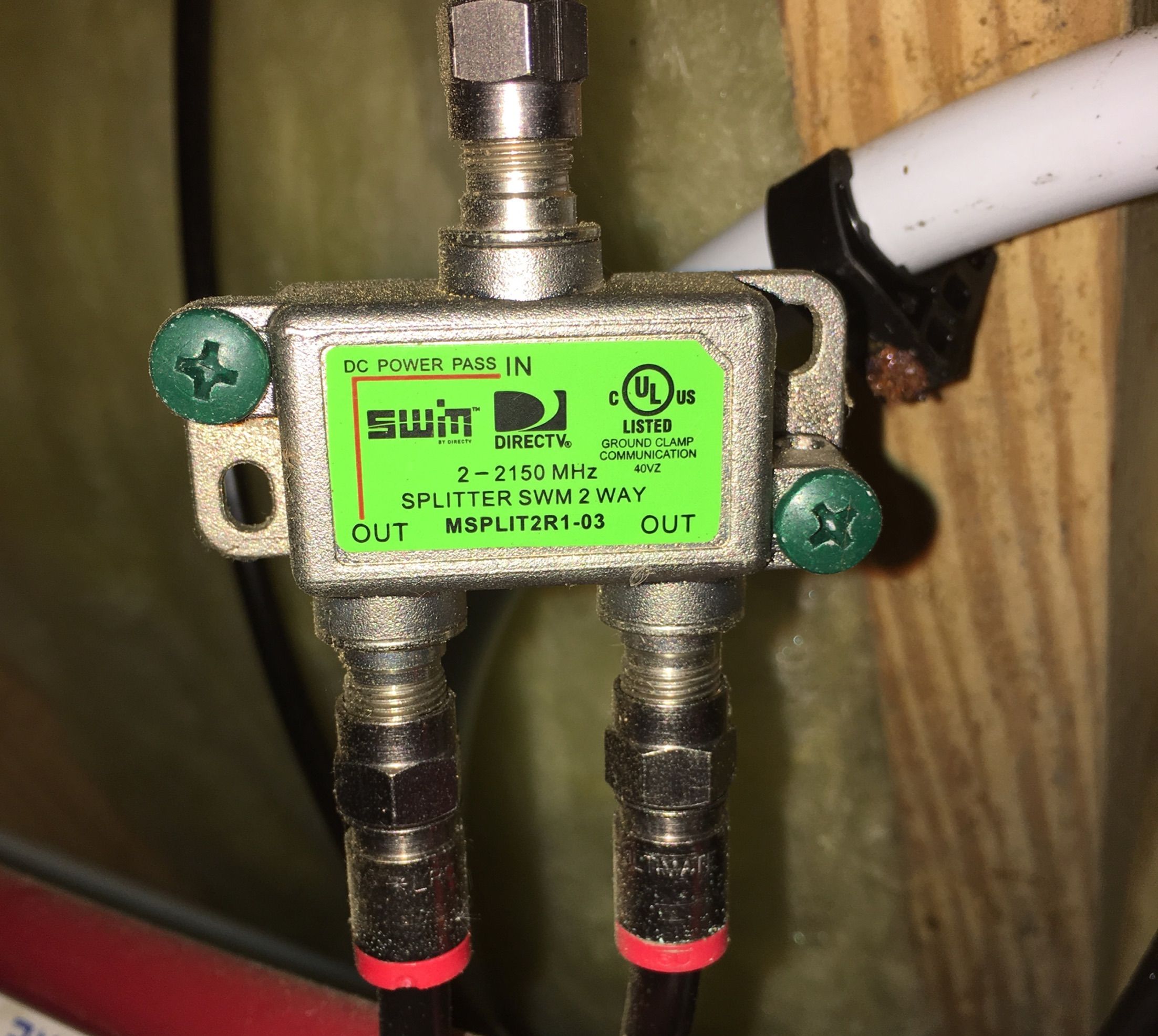

OK...after almost a solid week of rain and some other non-weather related things going on I FINALLY made it into the crawl space. I found one more splitter (picture attached). From what I could tell, the top single coax connection appears to go outside to the other splitter (pictured in an earlier post by me), and the bottom double coax connection appears to have one going to the HR54 in the den and the other going to the H25 in the guest bedroom. This splitter is located directly below the guest bedroom. The den and the guest bedroom are on the same side of the house, guest bedroom in the front and den in the back with a bathroom between the two. The other splitter is on the opposite side of the house on the outside. The H25 in the master bedroom and the C61K both appear to go out to the splitter that's on the outside of the house.

The "In" side (unless I looked at things wrong) goes over to the other side of the house and out to the other splitter that's outside attached to the side of the house. The two "Out" connections go to the HR54 and the H25, although I didn't pay attention to which one goes to the HR54 and which one goes to the H25 in the guest bedroom.

It matters, like alnielsen said. The power passing port must be the one going to the HR54.
So...the HR54 should be connected to the "In" port instead (since it has an internal power inserter)? Or it needs to be connected to the "Out" port that's for the DC Power Pass? Sorry for the questions. I don't really know much about how this stuff should be wired up. I have no idea if that splitter inside the crawlspace has always been there, or if they put it in when they replaced the HR34 with the HR54. I know there used to be a separate power inserter in the den with the HR34, and they took that away when they installed the HR54. I also don't know if the splitter on the outside of the house is the one that's always been there, or if they put in a new one during the HR54 install. I never really paid a whole lot of attention to it before. I bought this house as new construction, and the builder only had one coax cable installed - to the living room above the fireplace. All other coax, splitters, etc was installed new by DIRECTV when I moved in, which was a little over 3 years ago.

No, all receivers get connected to the out ports. All Directv splitters have one dedicated to passing thru DC current. That is the output that the HR54's coax needs to be connected to. The only exception, which doesn't apply in your case, is when you have a external power inserter used in the line. In your case the HR54's internal power is being used to power the SWM LNB. In order for the power to get there it has to go through the power pass thru ports.
